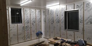

As autum closed in, i continued to make progress on the "clean room" determined to actually try and finish something.
Lighting was fitted, after much pondering about where the benches were to go. I wanted, for once, lighting directly over where im working.
As per my previous post, stud work was installed, insulation fitted and, once complete, the vapour barrier installed, this being rather critical in this environment
The doors were obtained free from a builing next to where i worked. It was being stripped out and these were going in the skip. I asked them to leave them next to the skip. They did. Problem eas there were about twenty of them!
Still got them all, though not quite sure why? I do have use for some more, but still........................
On with the vapour barrier
As can be seen here, ive gone for the full air tightness approach. Im aiming to keep this warm-ish through winter so its a nice place to work as well as a stable environment for stuff that can go rusty.
The only flaw in my otherwise brilliant plan, was that the small window is a single glazed affair. I will need to come back to that later.
The sockets got a dose of expanding foam around them and around the cables. The sockets had gone risty, and the cables green with corrosion, as these cables exit into the cavity between the inner and outer walls.

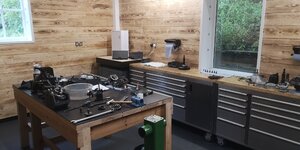

Pondering the wall finish, the obvious options were considered. Plasterboard (sheetrock?) would work, but needs finishing and painting. Im not good with plasterwork. And you cant hang stuff on it unless you go into the timber studs.
OSB is cheap-ish, strong, can hang stuff whereever i want. But looks rubbish. Still looks rubbish when painted.
A chance conversation with a friend hard me looking at some larch cladding from a company to the north, a co-operative.
I talked to them, priced it up. Essentially the same price as OSB. Deal done. Got the trailer out and went to get it.
Compared to my friends stuff, it was paler than i hoped.
So onto the next plan. Make it darker. To add a bit of interest i decided to torch it. Ive never done this before, but i think it came out OK.
As ive not quite decided how to tackle the heating side of things for the whole project, which may, or may not include retrofitted underfloor heating, i decided to do the floor in vinyl tile for now.
I cant say im a huge fan, but it does what i need for now
Time to move in some toolboxes and cupboards
Theres more to do, incliding a central bench, but it was greart to see something resembling completion, window reveals excepted.

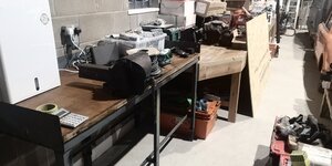

In my "clean" room, those who were paying attention will note a big space in the middle. Ive always wanted a bench i can walk round and is big enough to put, well, big things on.
Additionally, the more observant will have seen the massive bench down the side of the main area. Good as it is, its probably longer than i need, and an outline plan required to to be a bit shorter to make way for my steel bench.
So, basically, i chopped a piece off the end, and added a set of legs. I then added a large plastic sheet to protect more delicate parts like pistons etc, and to finish off a stainless strip down one side, as a hard surface i can tap things on if need be.
Screwed my gearbox/T56 holder thing to it as well for good measure.
Now, the placement of the lighting makes sense.
