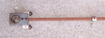

I have quite a few home-brew tools, but many are too buried for pics just now (Huge shop press, engine crane, motor stands...) or I already posted (Drill press fence) but here are a couple I can get to easily:
First up engine leveler for the Engine Crane; The acme thread all thread moves the traverse bar back and forth on the hook pin, and allows minute changes in the angle the engine that is hanging from the chains (Chain numbers and length optional depending on the engine....). Normally there are 4 chains but the last engine was a small 4 banger, hence the 2 chains and hooks. I've had complete Ford big blocks with ******'s on this little rig.
Next up something a little different. We used to make wood stoves out of huge iron pipe and plate and I needed to cut quite a few round plates with a torch out of 1/4" or thicker. Some required concentric cuts for the doors. I made this up to allow me to set both the torch height, and diameter of cut with 2 settings. Its a cutting torch Compass.
There is a bearing in the sleeve sized to hold my cutting torch tip, and make sure it does not bind up while cutting. The aluminum angle, has two more small bearings that are the wheels to the cutting head cart.
The thing about midway up the hex shaft, is the center pin, and that sets on top of the (missing for pics..) CB antenna magnet mount I converted to hold the center pin on the head of a hex head bolt.
As long as the material is reasonably clean/smooth, and you give the torch time to heat up before starting to cut, (a little preheating goes a long way), it cuts almost machine clean. The bar allows over 4 foot diameter cuts in wanted. Apologies for the rust, it's been hanging on the wall for the past 20 years or so...
