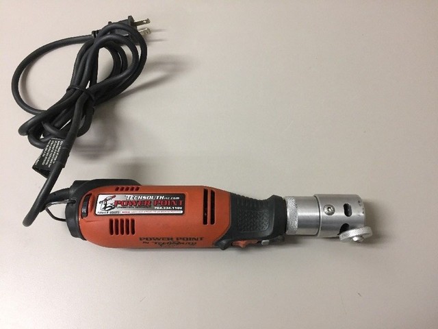

GOT IT!!!
The tungsten grinder!
It is a Black and Decker rotary tool with a Techsouth attached grinder.
http://www.techsouthinc.com/grinders/manual.html"]http://www.techsouthinc.com/grinders/manual.html[/URL]
Works good.
