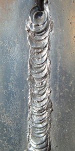

All the good advice above got me grinding my metal where the welds go. It did make for easier welding.
Started off with a couple T joints in 3/32 with 1/8 6010 80Amps. First couple were horrible. Wasn't comfortable and rushed them and just got all cattywampus.
Then I settled down, got comfortable, centered and did a dry run. Ran at 90.1 Amps. I now brace my left elbow on my left let and hold my right stick hand with my left. The leg moves the assembly along.
Got the groove going and just stuck with it to the end.
Much improved. Used a small "e" manipulation, watching the upper edge wash while advancing the puddle. As long as the initial angles were good, and I stuck with them and kept up a proper travel speed (Slower at the start and gradually increasing, with extra fill at the end), they came out pretty good.
Tried a couple laps, and it went good for the first half of each bead. Used a whip and pause.
Went to a vertical up triangular manipulation and it was a cluster F!
Class was over (1:00 til 3:30)
He has a fabrication class at 9 in the morning, and I'm going to go in and get some more seat time. I'm behind in the class and need to catch up. This professor fully intends to get us certification ready. Lots to do.
Photos:
