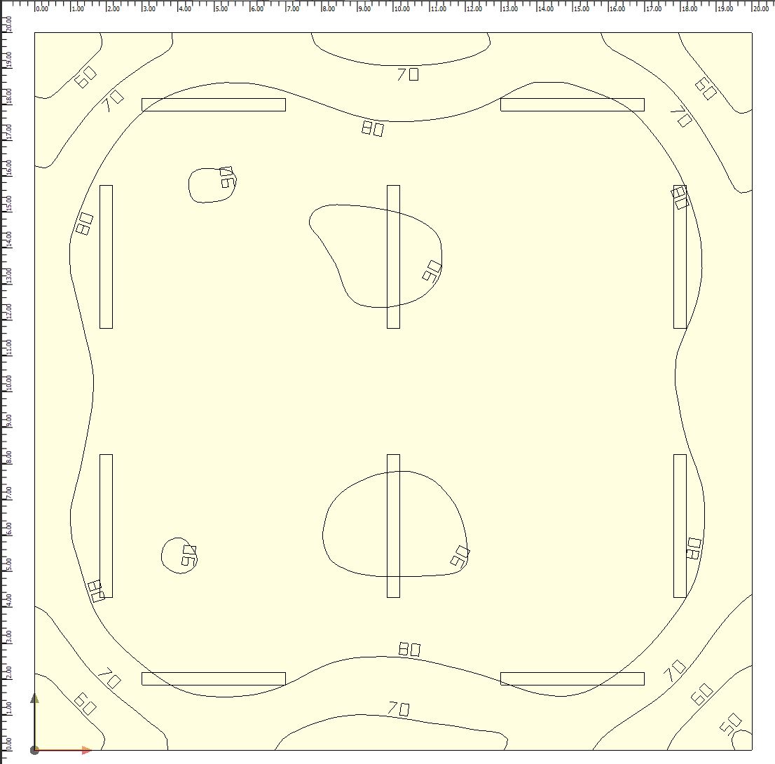

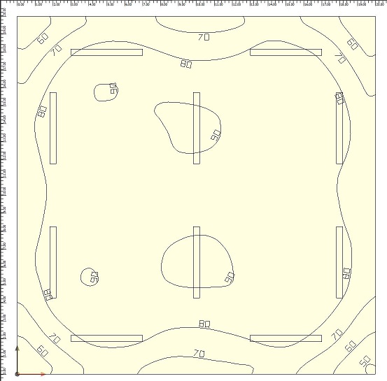

Hey Guys,
Been here a while but just finally got a house started the garage build. I am going to do a build thread but I need to get my light design done for the electrician.
It is basically a 25 foot wide double garage X 50 foot deep. The front 30 feet deep are 15 foot tall for a lift and other stuff, then it drops down to a more standard 8 foot for the machine shop and bike area. The ceiling will actually slope up a few feet from that to the center (see drawing sections).
I ran thru Platonic's best light thread and using the modeler program I come up with 20 of the 2 tube Maxlite LSS2XT8USE4803 fixtures with LUMEGEN LG-4T8-22WBB-SM50K(5000k) bulbs in the high bay and 16 of the same in the low.
My concern is that I really want to put these right on the ceiling (not hanging) and I know all of these calcs and bulb info are not quite accurate when I put them up that high. Plans and the calc plots are below.
Am I even close here or am I messing it up by putting them so high?
Platonic I know you are getting slammed with this stuff but I can PM you a dxf if you had time to look.
