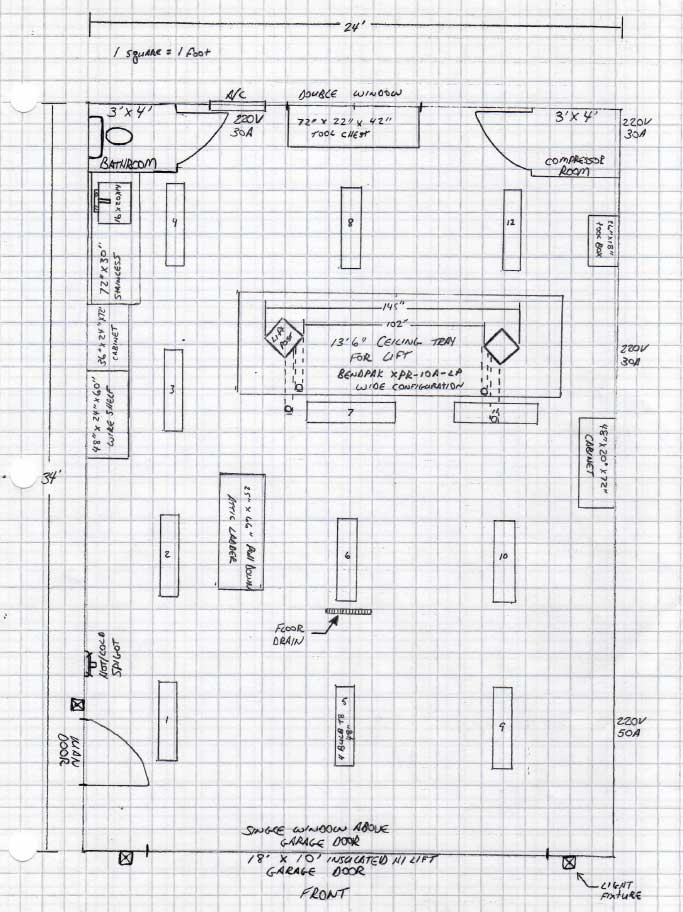

Lots of good info in here. I'm close to having my lights put in and here's what I learned and the decisions I made if it helps anyone in the future. I didn't think you needed to become a lighting engineer to get this right, but man it sure felt like it by the time I was done.
I originally based my specs on the size of the shop (24W x 34D) but learned you loose about 1.5" on the interior as the specs are brick to brick as the builder calls it. I measured my actual interior and it's 23 x 32.5. I have 12' ceilings. Ceiling and half the wall will be white. Lower half of walls will be a light machine gray with gray epoxy floors.
Using the Visual Tool Platonic referenced and a working plane fc of 95 (I like a little overkill on these things) and a T8 32W 4 bulb wrap fixture (to avoid shadows and glare) I needed 12 fixtures based on a Lithonia 4 bulb T8 wrap. That's the closest I could find to the Utilitech I plan to purchase from Lowe's.
I got lucky and found bulbs on clearance at Home Depot and was able to get Phillips F32T8/TL841/XXL bulbs for $10.83 for boxes of 10. These have a CRI of 85 and 2950 lumens. If you keep your eyes peeled you may find some of these still on clearance. I bought all my store had at 7 boxes so I'd have spares.
http://www.homedepot.com/p/Philips-...uorescent-Light-Bulb-10-Pack-202788/202229382
The fixture I intend to use is:
http://www.lowes.com/pd_184346-13537-184346___?Ntt=184346&UserSearch=184346&productId=1225811
I was going to use the Lithonia fixture that's similar from Home Depot, but when I opened one to look at the ballast it was commercial and I read a lot of reports on it interfering with radio stations, etc. I didn't want the headache of changing 12 ballasts after the fact. I asked the HD employee about it, he claimed he called Lithonia and they'd never heard of the issue. Hard to believe since they're sending folks replacement ballasts no charge when they complain. Something to watch for. I checked the ballasts in the Utilitech unit and they are residential.
Now my question if someone can oblige. Here's the light layout from the tool, as well as my garage layout. Two of the fixtures will be turned 90° where a recess in the ceiling will be for my lift. Should I consider turning any other fixtures 90° or is it a wash? I was thinking maybe fixture 5 and 8? There are plugs in the ceiling above the sink and tool chest at the rear for future dedicated task lighting if needed, if that matters.
Thanks in advance!

Walls are 6" studs. Actual interior wall to wall is accurate as shown in the VD diagram at 23 x 32.5.
Speedy!
Dec 23, 2014
271
TN
I should have clarified the ceilings are 12' but the the comp closet and bathroom are capped off at 8'.
Speedy!
Dec 23, 2014
271
TN
Pull down attic ladder is horizontal (turned 90° vs what's shown on the drawing) and centered directly between fixture 5 and 6. This was required due to how the trusses were built.
The recess for the lift is to scale in the drawing. It is 3' from the right wall and 8'7" from the back wall.
