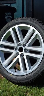

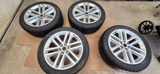

Got the tires mounted this morning. I hired a mobile company to come to my house to mount and balance them. They did a good job, but it was significantly more expensive than I was expecting. I didn't realize that they have a $75 charge for mobile work on top of the $27.50/wheel for mounting and balancing, so with a 20% tip (the guy was friendly and very careful) the total ended up being $240...
The technician said that the tires balanced fairly well for being 22", one wheel only required half an ounce of weight!
I rolled one of the wheels outside to get some pictures in the sunlight - looks great! Next I will ceramic coat them so I can mount them on the Expedition.
I'd happily pay that to have a mobile guy mount tires at home rather than running the gauntlet at a shop.
A few notes on the Armour coating -
- Wear gloves!
- I would swap out the applicator after doing the second wheel, this coating hardens in the applicator quite quickly.
- The initial wipes will be quite grabby, but the follow up (final) wipes will transform to a slick finish. I find the coating becomes slicker after the initial cure period.
- A second coat can be applied after two hours, but I have only applied the single layer and its fine.
- Don't drive the car for at least 12 hours, 24 hours ideally. Also keep them dry during that time.
- Avoid washing for 7 days after application, especially the use of wheel cleaners. A mild rinse-less wash would be fine.
It's a brilliant coating, couldn't be happier with it.

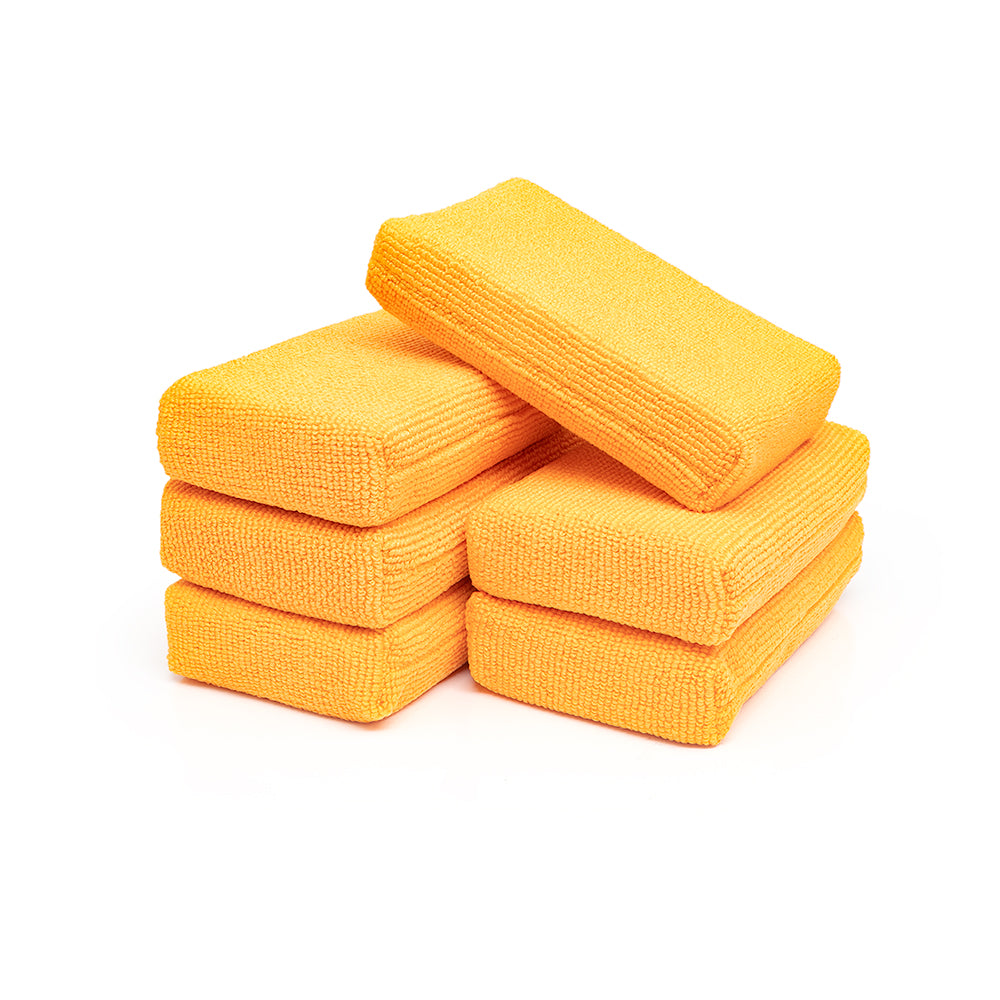

Ohh, okay. I thought the orange foam block was the applicator. What is it for then, I don't see it being used in the videos?

For the orange Carpro block, you wrap the suede piece around the block and then wedge it into the slots on the side. This is/was the original way to apply ceramic coatings on body panels.
Matt from OG prefers the old block and suede applicators, but its not very well suited to wheels, most have moved on to microfiber bricks instead. If you watch the videos, you'll notice that he used just the suede piece to coat the wheels. I find that cumbersome and lacking in control. The coating itself is supplied with a small microfiber applicator, which you can flip over half way through, or wrap one of the suedes around it.
If you are going to get into ceramic coatings in general, I would order a couple of different applicator sizes to see what you like and have them in stock. The little Carpro or Gyeon finger mitts would be excellent for wheels, I also use the TRC Pearl Applicator or the Gtechniq AP5.
Also worth noting that applicator and towel used to apply a ceramic coating should be thrown away or put into the dirty rag pile, dried coating is basically glass, you don't want to scratch up you hard work.
