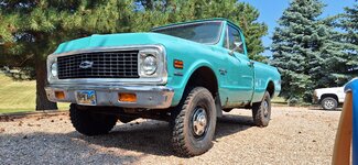

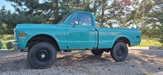

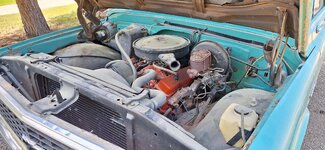

Yesterday was a special day. I decided to finally try to fire up my old '72 K10 and start the process of getting it sold. I think it's probably been about a year and a half since I've had it running. We had been driving it around the neighborhood maybe once a month prior to that, but it suddenly began starting really hard, to the point where it simply wouldn't start without spraying some carb cleaner or dumping gas down the carb.
I hooked up the jumper cables from my Dakota to the '72 and tried giving a spritz of carb cleaner to it. It immediately fired up, but only for a second. Clearly not getting fuel. When I parked it last, I knew there was something going on with the fuel pump. I still feel this way, but I haven't entirely diagnosed the problem. There is definitely a gas leak at the fuel pump, and I'm hoping that maybe it's just loose fittings. I'm hoping it's not bad seals and or diaphragm, but it's possible because I'm cheap and have been just running the truck on 87 ethanol gas for years. The fuel pump was new in 2016, and is an Edelbrock 1721. I haven't seen any rebuild kits for them, and unfortunately a new one is about $170.
Anyways, we got it fired up eventually, with me keeping the engine running with carb cleaner while my father in law cranked it and gave it some throttle. Once the fuel reached the carb sufficiently, the old girl idled like a champ and handled some 3k RPM throttle blips okay with the occasional stumble. I pulled it over to the shop and filled up the one flat tire (all the others held strong at 42 psi) and then moved it into position to start the clean up process. I shoveled probably 50lbs of pine needles and pine cones out of the bed from the now almost six years the truck has lived underneath pine trees. As you can see, it was quite neglected. Covered in tree sap, bird poop, dust, and pine needles.
To kick off the deep clean, I loaded up my foam cannon with some Dawn dish soap. Of course this would normally be bad practice, but the paint on this thing is in need of some real deep cleaning, and I hoped the dish soap would loosen up the sap (spoiler alert: it didn't).
I let the soap dwell and loosen up grime for about 10 minutes, then proceeded to spend an hour straight pressure washing every square inch of the exterior, undercarriage and underhood included.
As mentioned earlier, this didn't do much for the gobs of tree sap all over the body. You'll also notice the missing clearcoat and majorly oxidized paint in the spots with the most sun exposure. The hood is severely oxidized and has almost no clear coat.
I'm sort of on the fence with what to do about the paint oxidation. I know I want to address it to make the truck overall more presentable to potential buyers (yes, I know this is probably silly given the rust issues) and I also don't want to spend a lot of money and time to get it there. There are a couple of avenues. The cheap and easy would be the Zep floor wax/VGG Shine Juice/Sweet Patina Sauce simple wipe on solution. The more expensive and time consuming method would be to buff the oxidized paint with some compound and a wool pad, then wax the whole truck.
I'm conflicted, because I know the cheap and easy method wouldn't give me really great results, but it would be something easy to do to quickly transform the looks of the paint. @D.F.B is the angel sitting on my shoulder telling me that this is the perfect opportunity to finally try buffing some automotive paint with my Harbor Freight DA. I can't really hurt the paint, and I don't need perfection here. I think it would be fun to buff it, but it would absolutely be more time consuming.
I'll leave it at that for now. Later this week I will look closer at the fuel pump and make the decision whether or not to buff the paint.
Is it clear coated? Or just single stage?
If its failing clear coat, you won't see much benifit, but you might bring some of the shine back to single stage. In any case, do a test section and see what you get. This would be a good opportunity to have a play around with that machine, I'd probably start with a foam pad considering the fragility of the paint.
For the tree sap, I'd be using something like Carpro TarX, but apparently hand sanitizer can dissolve tree sap as well.

...I would leave that patina.
I agree. I don't think you need to do anything in regards to the paint...
Buyer 1 wants to do a full restoration. He won't care what the paint looks like because he knows he's going to have it resprayed.
Buyer 2 is going to keep it as a survivor and drive it as is. They may not want a patina preservation applied to the truck. Let them decide if they want to put some shine juice on there or not.
If a potential buyer can't look past the paint, then they have no business owning that beautiful truck.

Thank you for chiming in! It was repainted at some point with a base/clear paintjob. There are also some areas that I painted with a spray can years ago. I'm not super concerned with the fragility of the paint, even some burn through would add to the "patina". I mainly just want to get the oxidation off and bring some shine back so that the truck doesn't look like it's been sitting in a pasture neglected for years and years. I want it to present as well as it can. As for the sap, I planned on trying some of the Stoner Tarminator on it. I also have a brand new bottle of Carpro Lift (bought on your recommendation), but I figure that probably wouldn't cut the sap. I think a test section on the paint is the perfect way of proceeding.

I agree with you. Unfortunately my brain doesn't accept that logic haha. I can't help but to want the truck to be as presentable as possible to potential buyers. Take my word for it, the truck doesn't have what I would consider patina. It looks like neglect. I really believe that bringing some shine back to it would really make it pop and help with the sale. Plus, I'm really curious if I can bring it back somewhat and I think it would be a lot of fun - and a learning opportunity.
Thank you for all of the replies guys. I learned a lot and had some great experiences with the old truck, but I don't feel a sentimental attachment to it anymore and it pains me to see it rotting away under pine trees. I may enjoy metalwork, but that absolutely does not include rust repair, so the prospect of me fixing it is just unbearable. The money from the sale of the truck would be much more useful in other areas of my life, especially compared to just having an old truck rot away in the driveway.

Couple of vehicle related updates:
First, I threw a new battery and fuel pump in the old '72 Chevy and have been putting some miles on driving around the neighborhood with my family. It's running great! I also found a good deal on a set of hubcaps on eBay, and to my surprise I really love how they look on the truck. I know, they aren't correct (they're square body caps) but the correct caps would've been about 3-4 times the cost of these. They look the part to me, and I think the truck looks tougher.
Still have to clean it up before I can think about listing it for sale, but getting it running again was an important step in the right direction.

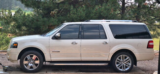

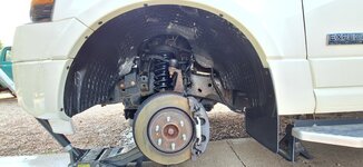

I also worked on the Expedition last week. We dropped it off at the mechanic shop to have a simple routine oil change and ended up getting hit with a $2,600 bill for new front lower control arms, rear upper control arms, and a 4 wheel alignment. Not fun at all, but this is exactly the reason why I take our family hauler to the shop rather than doing oil changes at home - I wouldn't have checked the ball joints and found them to be very worn out... On a positive note, the Expedition has never driven so well and solid as it does now. That inspired me to finally get around to ceramic coating and bolting up the new wheels and tires that have been taking up space in my shop for months now.
As a reminder, I picked up this Armour wheel coating kit based on @D.F.B 's review and experience. It was quite simple to apply. Once coated, I left the wheels to cure for 24 hours. Once cured, I systematically jacked up each corner, removed the old wheel/tire, detailed the wheel well and suspension, and finally installed the new wheel/tire with new lug nuts. It was going pretty well and was an enjoyable way to spend a beautiful summer afternoon.
(shield your eyes from that rotor flash rust, @D.F.B )
As I was finishing the very last wheel on the passenger side front, I noticed a wire harness hanging out in the breeze completely naked, with no loom. This caught my attention, so I investigated. To my disappointment (and slight anger) I discovered that someone that wasn't me (and I likely had paid to do service) had gotten lazy and failed to properly route said harness. Instead, they had zip-tied it haphazardly to a heater line that just so happened to be quite near the exhaust manifold. Obviously, this melted and disintegrated a large portion of the factory corrugated wire loom, leaving the bundle of wires exposed and very close to the hottest part of the engine bay.
By some massive stroke of luck, a visual inspection of the exposed wires showed no signs of melted insulation or bare wire! I can't believe how fortunate I was there, because no doubt that harness would have been expensive and difficult to repair or replace. With just enough access, I was able to wrap the exposed portion of harness with electrical tape, followed by some nylon woven wire loom that I had in stock. Following this, I rerouted the harness up much higher on the firewall, tying it to another harness in a more proper and safe path than the lazy tech before me had attempted...
I just have one photo of this debacle, taken after the electrical tape wrap job:
I was not happy to have to do this repair, but I am grateful that I caught it and took care of it before it became a real massive problem.

No fun finding poor workmanship you paid good money for, draw backs of having others work on your truck that is not "their own" Reality is most people would not notice and mechanic is working against "book time" for a job...
Wheels look great!
I have no way of knowing for sure that it happened during my ownership of the vehicle, but there were two jobs in particular I had done at the shop where that harness would have been in the immediate way of the work being done... Thanks!

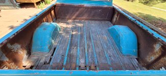

I also started cleaning the mounds of tree sap off of the '72 Chevy as I clean it up to get it ready to list for sale. @D.F.B recommended Carpro TarX for this task, and it worked wonderfully! The only drawback is that the sprayer included with the 1 liter bottle is trash, for some reason I have to have it loose on the bottle or it will sort of vacuum lock and stop spraying? Not sure how to fix this. The product itself made quick work of all of that sap that had been sitting on the paint for north of half a decade!
Before:
After:
I did the cab and front sheet metal, just need to do the bed. A plastic razor blade was a big help to get the globs off, then I followed it up with a microfiber towel to remove the residue.

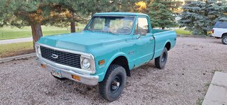

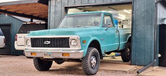

Made some more progress towards getting the '72 Chevy ready for sale today. I decided that it would be a good idea to cut out some of the rusty sheet metal in the rocker/floor/cab corner areas of the driver side, and a bit on the passenger side cab corner as well. A few weeks ago I actually pulled the entire rocker panel off of the driver side with one hand, it was barely even attached. I did it because I was worried that my kids or potential buyers would accidentally hurt themselves on the rusty, jagged edges that were very much in areas that could snag you. So, it may look a bit worse to have a completely missing rocker and cab corner, but it is much safer and they needed to be cut off eventually anyway.
Here is the driver side before cutting today:
And here is how it cleaned up with a bit of cutoff wheel and flap disc surgery:
Another thing on my to do list was tightening up the driver side door handle. It had just a bit of wiggle and it bothered me every time I opened the door. I pulled the door panel off (not without a small fight from the crank handle retention clip), tightened the handle, decided to lube up the window mechanism while I had it off, and finally I cleaned the door and the door panel with Simple Green before reinstalling.
Before cleaning:
After:
MadeByMiller
Dec 29, 2018
1,230
Rapid City, SD

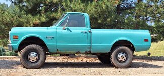

Next it was time to get started on a long overdue project for the truck - mounting the rear bumper.
I had originally removed the bumper when I shortened the chassis but I didn't have time to remount the bumper. When I put the truck back on the road in 2016 I intended to install the bumper, but it was easier to just run some self tappers into the rear bed crossmember to mount the license plate....Now that I'm selling the truck I want it to look as good as it can, so I needed to mount it up.
I backed into the shop and got to work.
And it really wasn't too bad to get thrown on! Right now I only have half of the mounting holes drilled and bolts installed, but with the help of a floor jack and a piece of wood I was able to pretty easily get the bumper into place where I thought it looked right. It looks so much better with the bumper installed!
I love the rear sport bumpers on these trucks.
You may notice that the rear license plate mount/bracket is missing. I have a brand new one that I bought in 2016 that I began to install today, but 3/4 of the carriage bolts snapped when removing the old smashed up one, so I will have to make a hardware store run to get that crossed off the list.
Still have plenty of work to do to get this old truck ready to sell, but it feels good to make progress anyway.

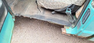

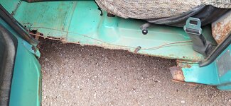

Are you planning to patch the rocker? Given your skills, it should be fairly quick and easy to put in a new rocker and prime it.. something that could be a daunting task for a potential buyer. I'm sure it would add a lot of value. Body panels for old Chevy trucks are pretty cheap..
madison069
Nov 5, 2010
4,126
Monroeville, PA
Truck is looking good! I installed a set of those hubcaps on my 78 Chevy crew cab when I was in high school. It cleaned the rims up a lot due to covering the axle hubs and lugnuts.
Like burger said, the missing rocker panel is the only thing that says to walk away for potential buyers. But without knowing what the underside looks like I wonder how hard it would be to just install them?
This.
Otherwise this is just a flat out tease...especially with your skills :ROFLMAO:
