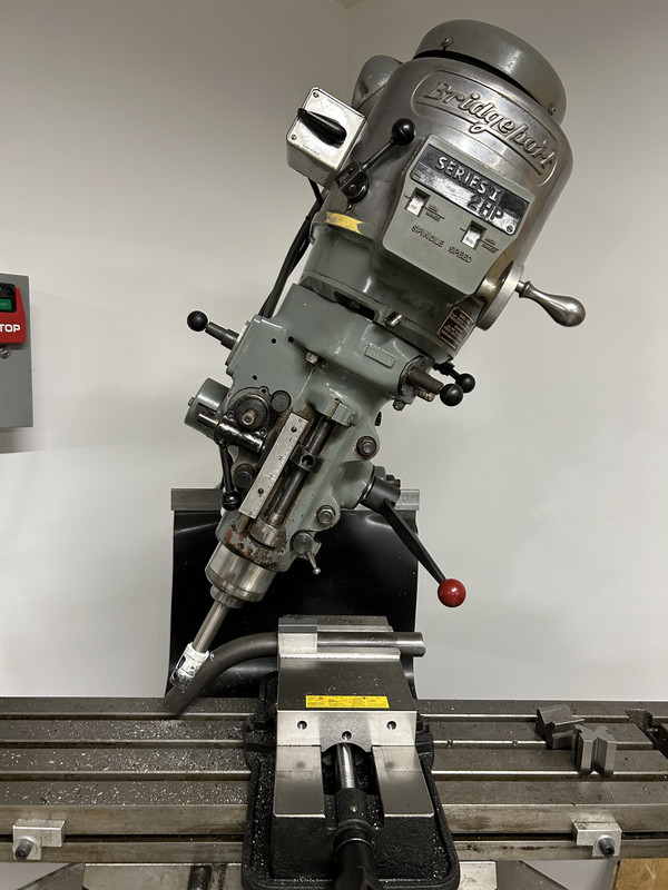

Updates have been slow recently however the project is still moving along at a "snails pace".
Tooling update
Tube notching is a difficult art to master and TBH this area has proved troublesome. Recently the angles have been more complex and this along with he hard material (4130) have caused all sorts of issues. My current set up is a trusty JD2 NotchMaster:
This device recently acquired a new name, "The Wrist breaker". This innocent looking tool will attempt to break you wrist the moment the hole saw looses a tooth. I run this thing pretty slowly and it still bucks like a rodeo horse. Therefore in an attempt to reach old age I'm changing the game.
The solution: some machined arbors that hold hole saws. This was a fun little project utilizing the lathe..
Note to self: Try to finish the metal with emery cloth before removing it....
Anyway I built several of these. They mount to the Mill using the standard collets.
This one simple change was transformational to my workflow. Its so much easier to set the correct angle by mounting the tube in a block. The accuracy is "night and day" compared with the NotchMaster and my wrists remain in tact! Huge win here folks.

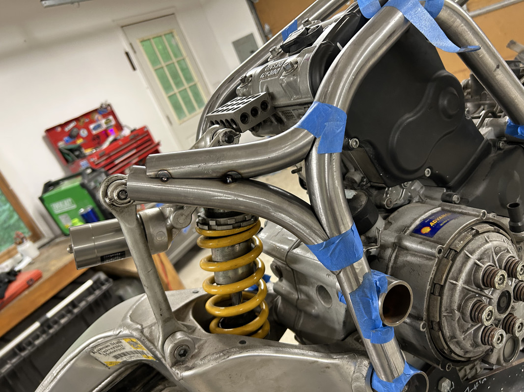

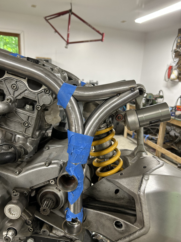

Bike frame update
Not a huge update, however progress is being made. The general look of the frame is slowly coming together and so far I'm pretty pleased.
The next job is to build all the cross bracing along with the rear shock mount. However I'm probably going to tack weld what I have here before moving on.
The tolerances are still fairly good..not bicycle build quality but not terrible.

Thanks @ez-duzit. Let me try one of these. I assume you cut the tube in a band saw and sneak up to the profile using this tool.
Simply cut the tube to length (I use a bandsaw) then clamp it in the milling vise at whatever angle is required, using a pair of V-blocks, and feed it into the proper size roughing end mill until the fishmouth is formed. Makes perfect fits. That is how I built this:

I started work on the rear suspension mounts. I noticed that things start to move quicker as my skills improve and the machine count increases. The Bridgeport has been a huge asset! My suggestion to anyone out there is to bite the bullet and get one....
So here is the initial stab at the mounts. Each mount will be intersected by a cylindrical mount and trimmed flush. Therefore I left plenty of material for this purpose.
and from the other side...
To achieve the extreme angles on the coped tubes required this...
Here I used the hole saw to start, then moved to the roughing end mill as mentioned by @ez-duzit. Sadly my end mill lacks reach...
Tilting the head to make these cuts its easy however it does require re-tramming the head once done...
