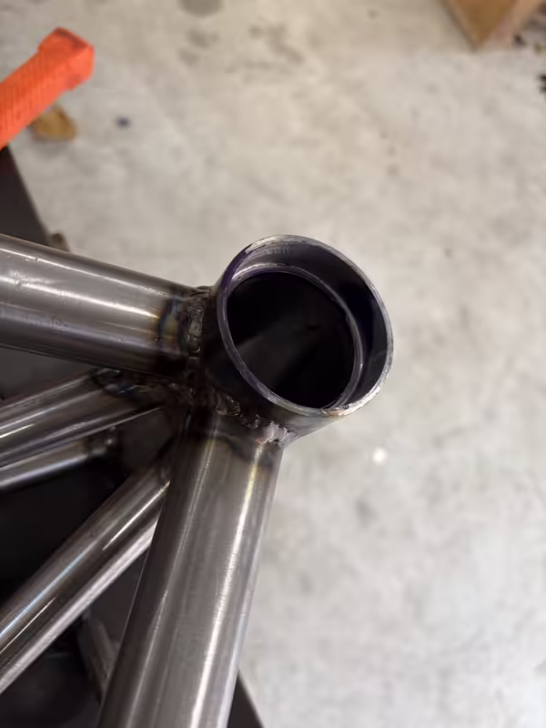

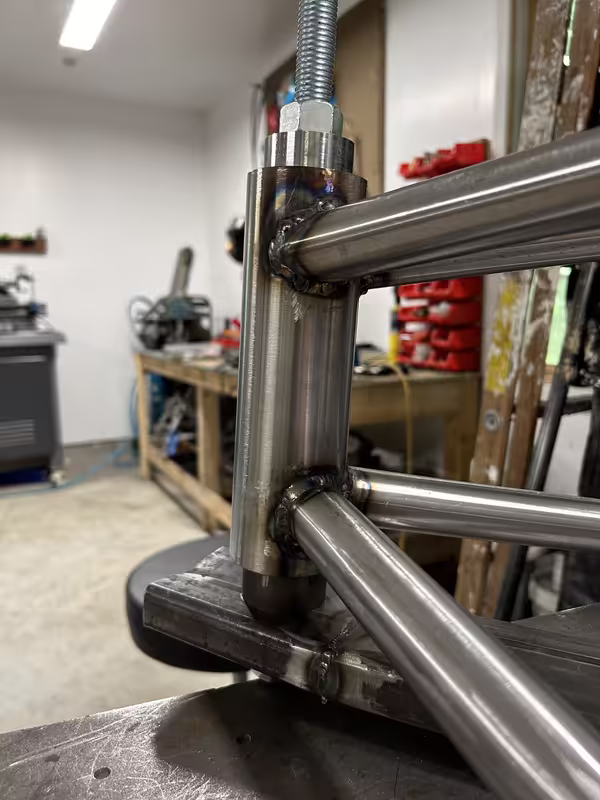

OK...Its been a while......

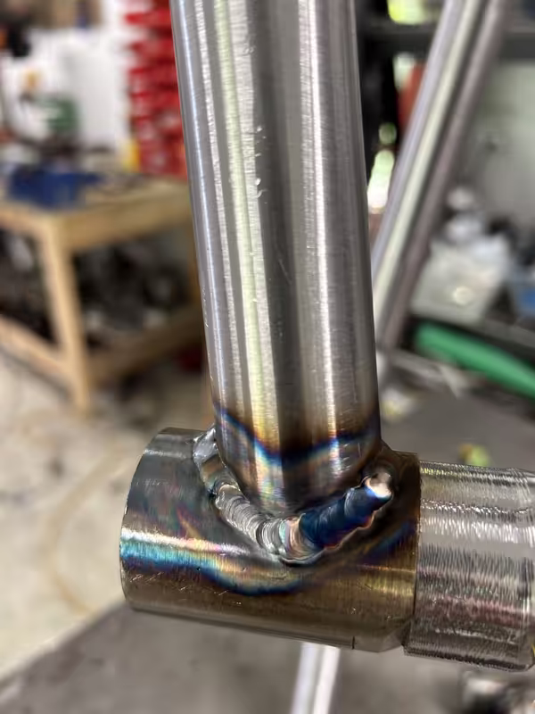

I spent the last few months trying to concentrate on the rear suspension. This task proved incredibly difficult, however I think I'm there...
First I had to calculate the geometry and ensure things were level. This included securing the mounts while I worked on the connecting tubes. The securing method was somewhat dubious to say the least!
The small connecting tubes were incredibly difficult to make. The smaller tubes are almost impossible to clamp when you have bends in two or more planes.
I wanted the rear mount to curve with the frame. Most builders avoid using bends in small tubing for a variety of reasons...However I feel the above is aesthetically pleasing to look at. It will remove some strength, however these tubes are extremely large and tightly triangulated.
Most of the "coped" tubes maintained an excellent fit. However there were many sacrifices along the way..........
The other side is not quite as pleasing to the eye due to the offset nature of the single sided swing arm. But it still works...
After completing this there is one "area of shame" that needs addressing. Removing this gap was really hard due to steep angle of the tube. I may still redo this one...however I may weld in a small gusset here.
Anyway here's the rear suspension done.
Time to move onto the cross bracing before building a welding jig for the frame....

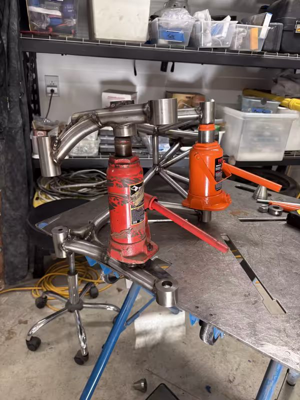

Just a quick update on the frame. The theme of this post is triangulation.... Triangle1.jpgtriangle2.jpg
It's slowly looking more like a frame. I still need to tackle the other side and that's usually tricky as it needs to match. Then there are gussets and supports to add....
I'm not sure how much this thing will weigh, however I might rename it to "Project Boat Anchor"....
Thats all folks...

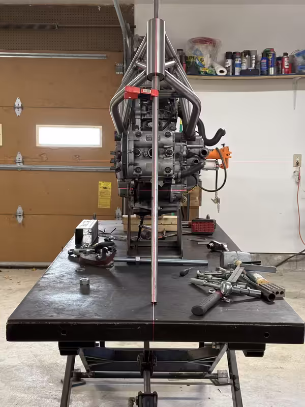

Wow its been a while... Things here have been slow...not really any huge updates...but progress none the less.
Cross bracing made to triangulate the frame towards the head stock.. See the top and bottom horizontal braces...
The frame is getting closer....
I redid the rear left side which i was not happy with....looks a little better and the gaps are gone.
Then I need to cross brace the rear suspension. This stops it "opening up".

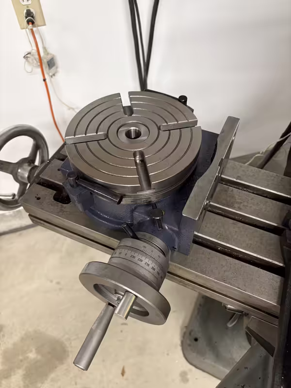

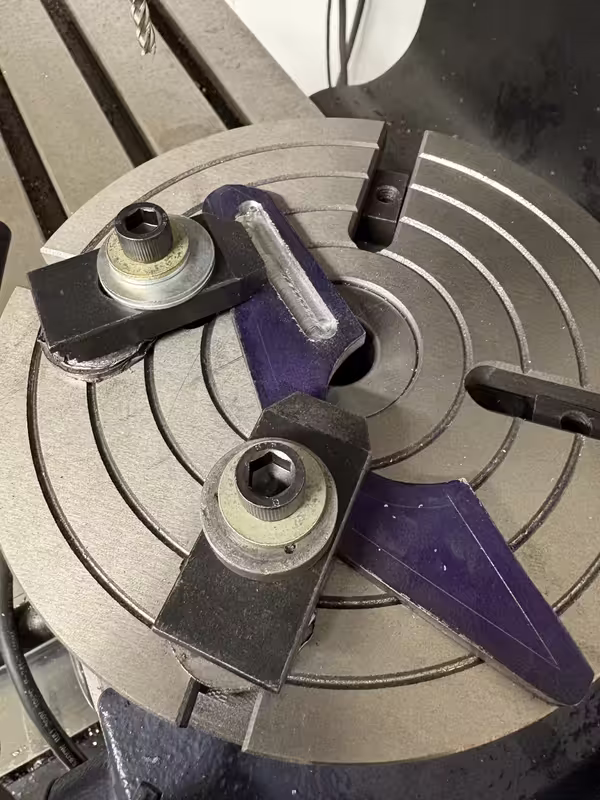

First I machined some "bat symbols".....
On the bike it looks like this. Possibly a little "chunky" IMHO....
Anyway....one last set of braces and then on to building the Jig....

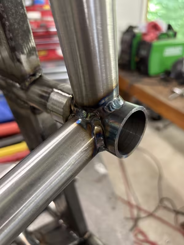

So onto the last few frame sections as mentioned before..
The cross support at the front was held in place...
Now the the last remaining rear mounts needed fabricating. For this I resorted to using CAD. I know... I said I was avoiding this, however occasionally I break my own rules...
The first task was to fire up the laptop. Then I had to choose the correct application, to support this CAD work. This inevitably was Apple Music with some kicking beats.....
Then after about 10 minutes this was the result...
Cardboard Aided Design has its place and I'm glad I leveraged this advance technology. This was quickly turned into steel with the help of literally every machine I had....
The other side required some clearance's but still turned out good.
Close up...

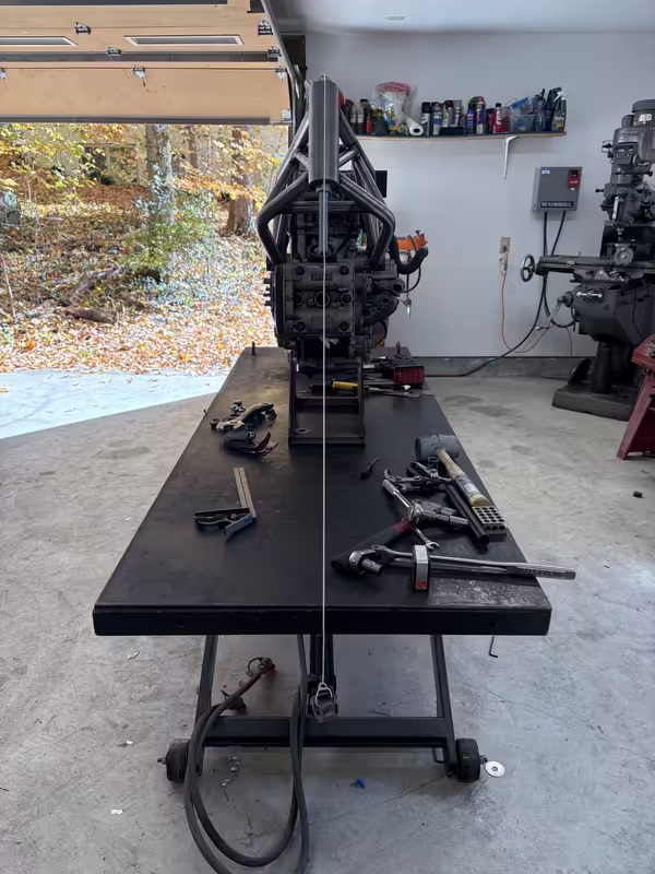

After that exhausting CAD work I got some time to stick some tubes together....9998 hours of practice to go....
Now I get to move onto the welding JIG. This should move a little quicker....

Soon I was moving along and things were going OK... however the harder challenge was always going to be the head tube...
Neck1.avif
The penetration to the thicker head tube is there...but I won't lie.. it could of done with more heat... although that in turn causes issues...which you will see later...
neck2.avif
Now if you look really closely you will see that my in experience really starts to show here.. The welds are inconsistent and the heat input varies.. a story that continues...
As time continues I feel at ease doing the simple tubes....but others are infuriating, as access gets harder and harder and the gas coverage is difficult.

The next task was to "tie in" the two mounts at the rear. Originally this was done using a flat piece of steel. However this looked really odd. Time for some more cheap tools which will allow me to add some features..
Enter a Vevor special...
Cheap1.avif
Which allowed me todo the following..
Cheap2.avif
Which of course resulted in a fair few broken end mills...ahhh learning on the job :)
The resultant part actually came out nicely.
cheap3.avif
The shot above really details some of the issues I faced with welding. the welds are OK...but they are incredibly inconsistent and not overly pretty!.. Again lack of seat time here...

Now, if you zoom in above you will see the two largest crimes on the frame:
  1. Where the three tubes meet the top tube the weld got out of control and way too hot! Its a huge weld that looks horrible.
  2. Where the down tubes meet the neck you will see I had to ground out some porosity! This is where my tank was running low on Argon again!

At this point I started to wonder what else had warped! I placed the frame back in the jig and noticed the frame had compressed at the rear due to the heat. So it was time to learn to fix a warped frame.
Some delicate heat (note it must be delicate with 4130...you don't want to make it brittle by heating it a lot!) then some pressure...
warp1.avif
Several cycles like this resulted in a fix!
Now to test if the head tube had warped....I again leveled the engine and lift, then marked the center points.
First the old fashioned bob line..
warp2.avif
Wow..now that looks ok...
Now for Lazers!!!
warp3.avif
By some sheer miracle this thing is as straight as an arrow! Result!!!
