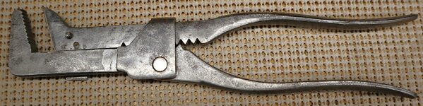

Here are pictures of my PowerGrip Tool Co. pliers. Also marked Mountainair New Mexico, Pat Pending. Appear to be patent 2361607 (Oct 31, 1944 by Charles D. Daniels. Several oddities. Mine has a broken U-shaped strap with the name Jack Rhodes in script on the one side. The patent shows springs, but I don't see or feel any. I plan on repairing this. I don't think is so rare that fixing it would hurt the value. (Correct me if you think it should be left alone).

@Eric Brown -
I have no answers for you, other than to offer some images which may be of help.
That device was also produced by The Powergrip Wrench Company of Shawnee, Oklahoma.
Time frame from Mountainair to Shawnee remains a mystery.
The patent document refers to it as "PLIER WRENCH". I would hope that would be the term we use, in order we're all speaking the same language. Ebay sellers are Ebay sellers - not "tool people".
Note the specimen below (from Mountainair) is marked "PAT'D" and the oddly abbreviated "N. MEX"
The Shawnee specimen ad apparently didn't show the other side of the tool, unfortunately.
Could not wait, I was curious. Took it apart. Mine does have a hidden spring. Next day or so will post pictures of it apart. Need to find some steel to make a new strap.

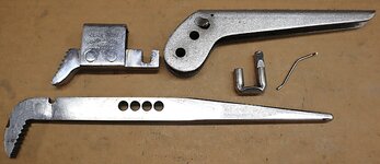

Just got done making a new strap. Here are two pictures. The first shows it disassembled. The second together. I am using some round head rivets to hold together. These will be pulled back out and everything nickel plated this spring/summer. Found out the main pivot was a press fit. Made a new one out of 5/16" steel. Also, replaced the ball bearing.

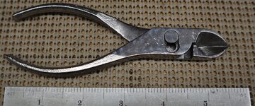

I have a pair of Bruno Will diagonal cutters also marked with the DRGM and Germany stamps. What makes these unusual is that they are adjustable. Can only think of two reasons for that feature. Start cutting something larger with them open and then smaller to finish. Or, ease of sharpening. They open about 90 degrees either way. So really not sure.
