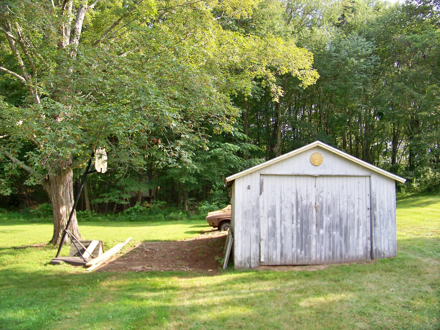

I just looked back through your photos and I noticed the old thermometer above the door. When you're finished with this job, I hope you decide to keep it mounted there -- it adds a bit of class to the shack!

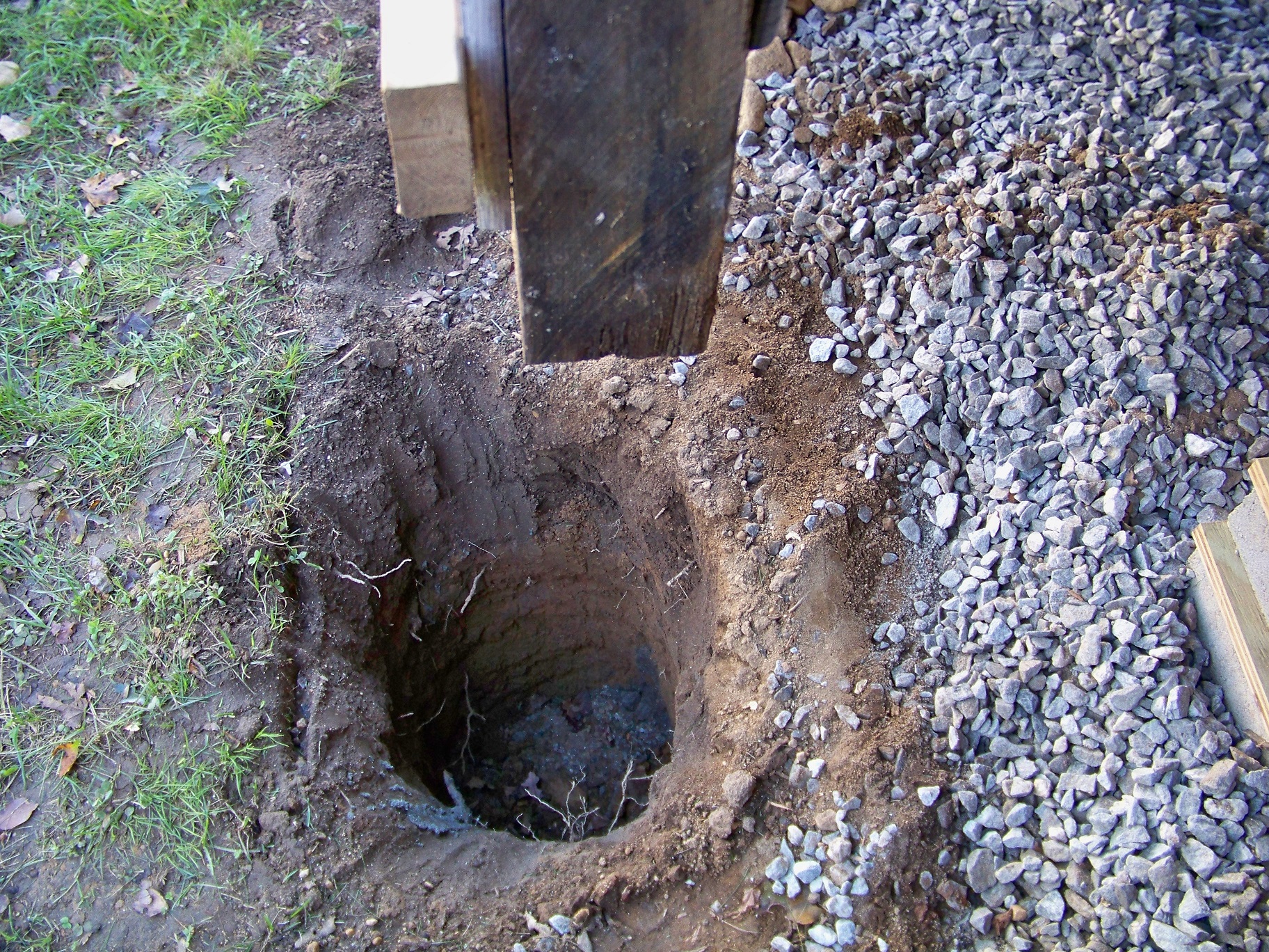

ambenz mentioned putting ammonia soaked rags in the holes. I suppose pouring it directly in the hole achieves the same result. I'll deal with that after I'm done. OT - I used to design blue print machines which use high strength ammonia. I remember hooking up the ammonia pump check valves backwards on a machine which created an amazing ammonia waterfall in the engineering lab.
The sonotubes are out. The holes would have to be huge to get the sonotube past the hanging walls above.
Not sure exactly which way to go. Here are the options as I see it: (I could be missing something.) FWIW, the holes are 15" diameter and 32" deep (still have 2 more holes to dig).
A. Put 4" gravel in hole - then pour 6"-8" concrete footer - place post - finish pour around post. (rebar?)
B. Same as "A" except skip gravel.
C. Don't put post in hole - put rebar in hole - fill hole with concrete - attach galvanized post base bracket.
In my research I learned that you're supposed to vibrate the concrete. That's not going to happen here, as I'm not spending another $300 for a ********.
I'd put the gravel in. That gives a place for water that drains down the concrete to be "stored" before it drains away. I don't know if that is actually how it works, but it always makes me feel better.
Have you hit something solid at 32"? You're 2/3 - 3/4 of the way to being below the frost line.

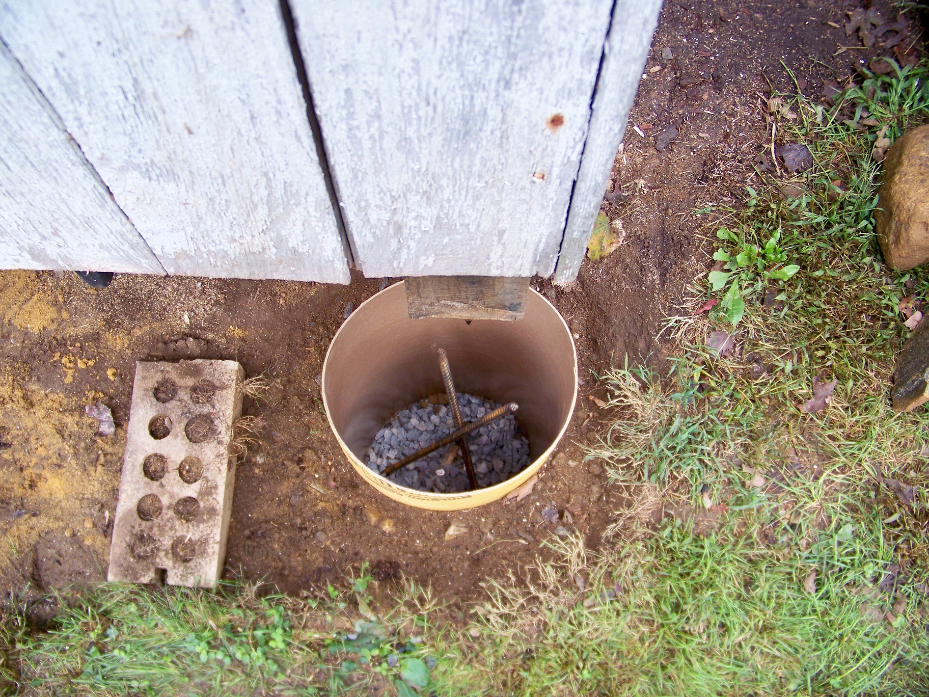

Contrary to my previous post I realized that if I keep the cement tubes short, then I can easily angle them in place. I already purchased the cement mixer so I'm going to use it, (yes, I have other projects I will use it for. Wait.. I have a huge gravel driveway - lol) though after lugging 16 80lb bags of concrete from store to truck and then from truck to shed, my love of concrete is fading fast. I could barely move the 1300lb cart through the store. Naturally, no HD employees offered assistance.
I also decided that I'm not willing to deal with 130lb. 12ft 6x6s, so I went for 12ft 4x6s. Had I seen RickP's and FMC1959's post before shopping I'd have done this differently, but it is what it is. My fault for posting my questions too late.
The Sakrete form tubes state not to use a ******** (unlike the Sonotube website), so that works for me since I had no intention of using a ******** anyway. The instructions (link) do state: "Rodding may be needed to eliminate air voids during concrete placement."
I haven't poured any concrete yet. I only placed one concrete form so far and stuck a 3 legged rebar teepee in it. I decided against using the Simpson post base due to price ($21 x 6 = $126). I have six 18" galvanized 5/8 threaded rods left over from when I was buying lifting frame supplies (not sure why I bought so many). I'll stick them in the concrete to hold the 3 side to side 4x6s. Guess I'll have to make a clearance hole for the nut and washer in the 4x6s that will be mounted along the walls - or I could go through both beams. Still thinking ...
I still intend on using gravel for support. I just thought having something solid at the 6 posts was a good plan.

RickP - Yes, the thermometer stays. I'll have to see if I can buff the yellow out of it.
Don't fill the tube to the very top. Use a 2-3' 1x3 and plungit in and out of the wet concrete. You will understand what they mean when they say the "cream comes to the top". Then add the required amount to finish.

theoldwizard1 - Everything I can find online says 5/8" rod for 12" column. I was just going to use 1/2" rebar.

theoldwizard1 - I did understand you. See this video. I thought I needed to put rebar in the tube.

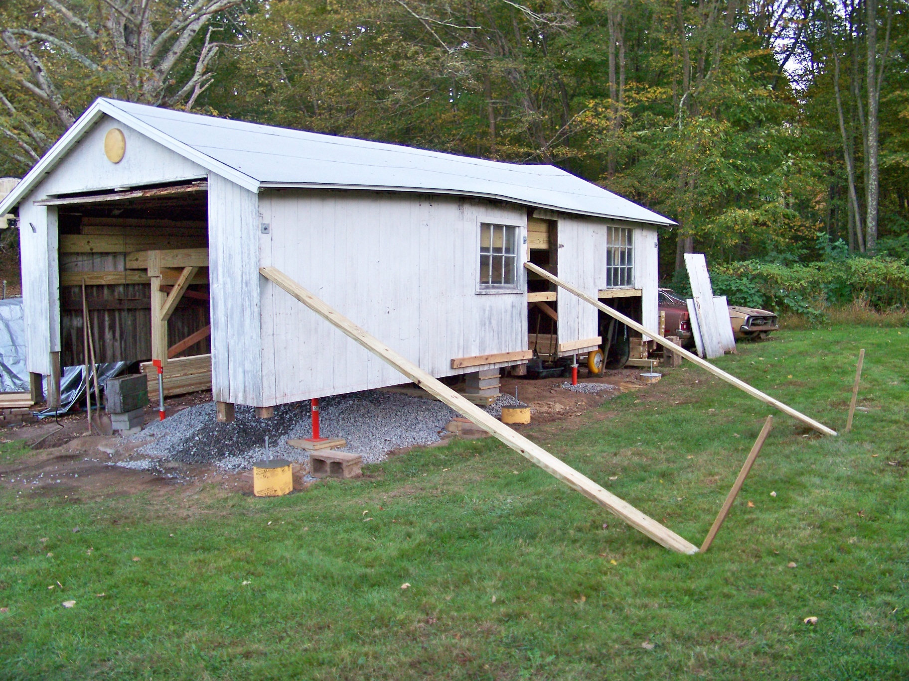

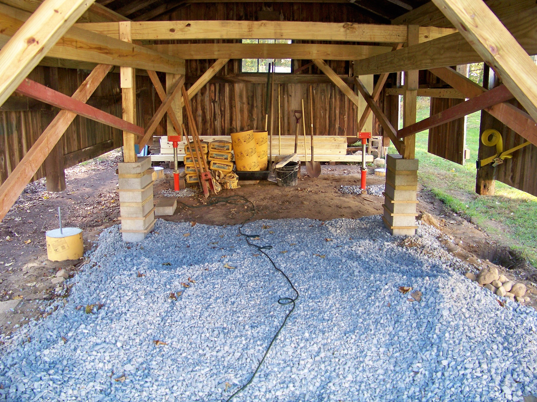

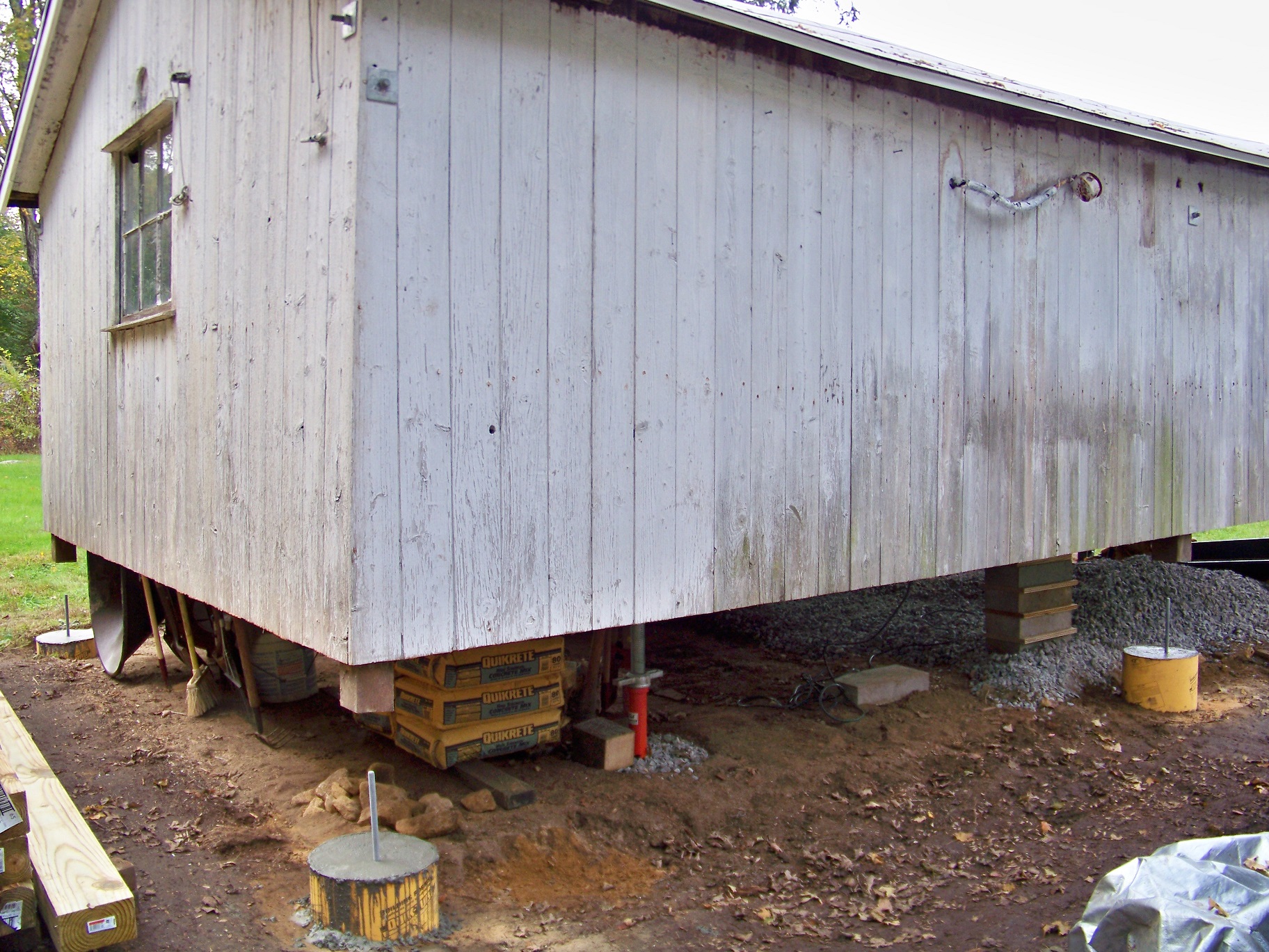

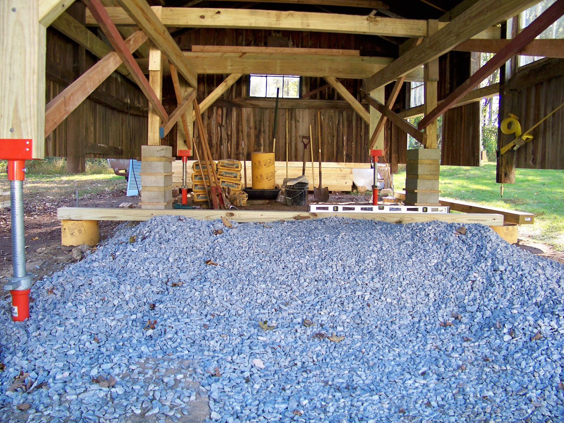

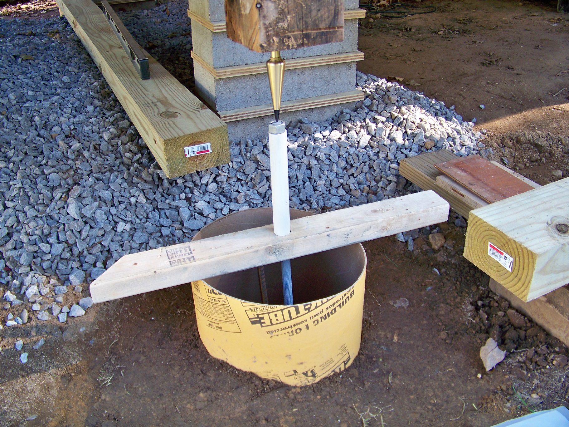

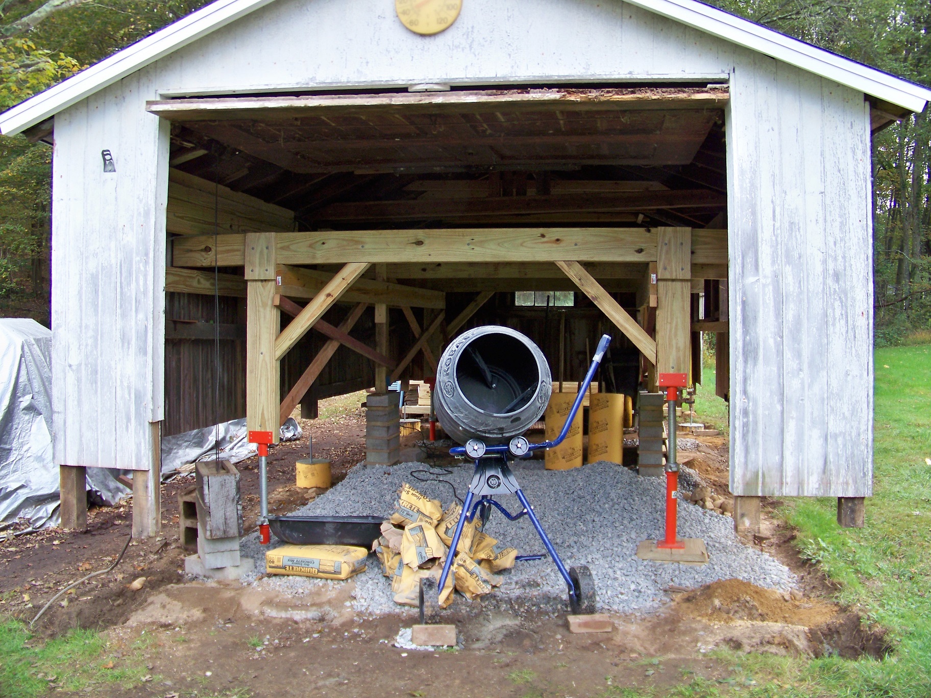

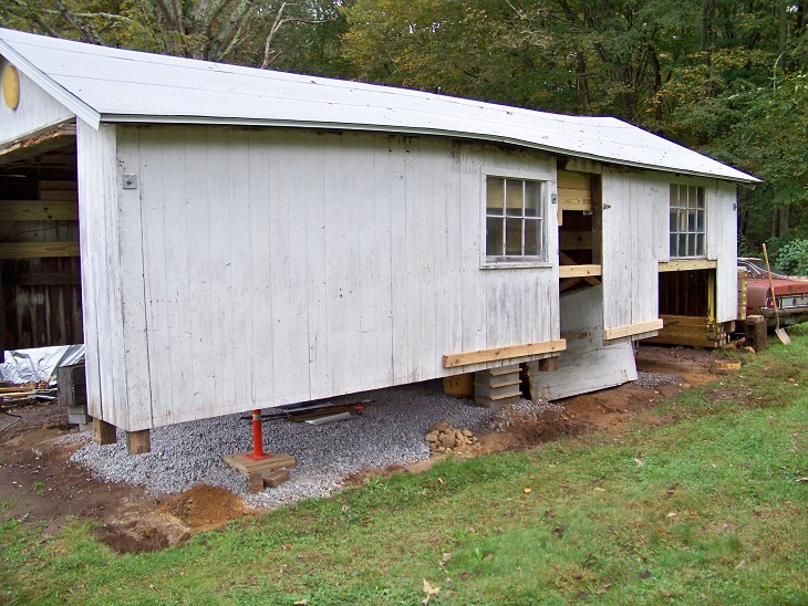

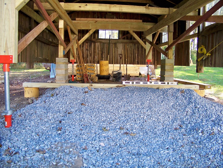

Progress pics.
Rained until early afternoon, but still managed to get the first tube filled. I lost way too much time shopping yesterday. I really should keep shopping as a night time task so it doesn't impede progress so much.
Concrete tubes are 12" diameter, 2ft long (4ft cut in half). Top of tube is at grade in an attempt to keep the resulting floor as low as possible. Rebar is 2ft, 3 pieces tied together in a teepee. Threaded rod is 5/8" x 18" sunk in cement 9". Bottom of threaded rod has nut + washer + nut. It only comes with 1 nut, which seems odd to me as there's no way to know if the washer made it all the way to the bottom. Getting the threaded rod in + on center of plumb bob and square was more of a pain than I expected. Cement mixer worked great. I followed the instructions of a mixer reviewer (linked) (see the review: "Misleadingly good value - ready for hard work" if you're interested).

Nice.. you do good work. :thumbup:
That photo with the plumb bob and the threaded rod is suitable for framing.

You know getting the hole in the 4x6 to correspond with the threaded rod will be tedious...
Hell... make your own straps. The strap doesn't even need to have holes in it. You can bend a piece of flat bar steel back onto itself, bend the lower end of it into an L-shape, place it in the concrete and then drill the holes once your ready to screw it to the 4x6...
Agreed, getting everything to line up just right will require some precision measuring, cutting and drilling. Worst case scenario, I drill the holes a little bigger and use the same big *** square washers I used to raise the structure with. That would be using those washers for their intended purpose and I have plenty of them already in hand.
I'm going to use the threaded rods cause I have them here and now. Too much time is being lost to shopping. Apparently these rods are intended to be installed after the fact in drilled holes with adhesive. I have no doubt the way I'm doing it is stronger than necessary.

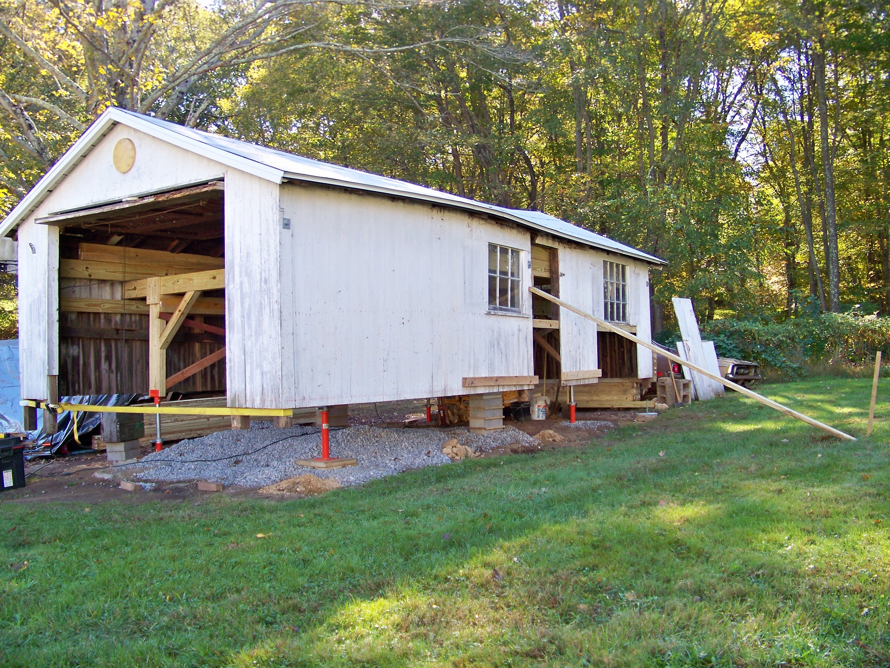

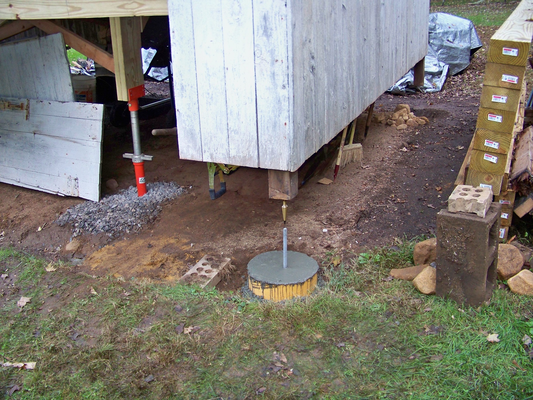

Progress pics:
Nothing exceptionally exciting. Feels like a lot of work, but I only got 2 more tubes done. I used a 4x6x12' beam as a level to get the heights right. I lucked out on the last (middle) tube - just barely had enough concrete to fill it. That works perfectly: I purchased 16 80lb bags and I used 8 so far to fill 3 2ft tubes. I enjoy working with wood, concrete - not so much. Also had to shorten the shed posts so I have a fighting chance of getting the sills on there. The corner rod looks crooked in the picture. I know it was straight when I set it.

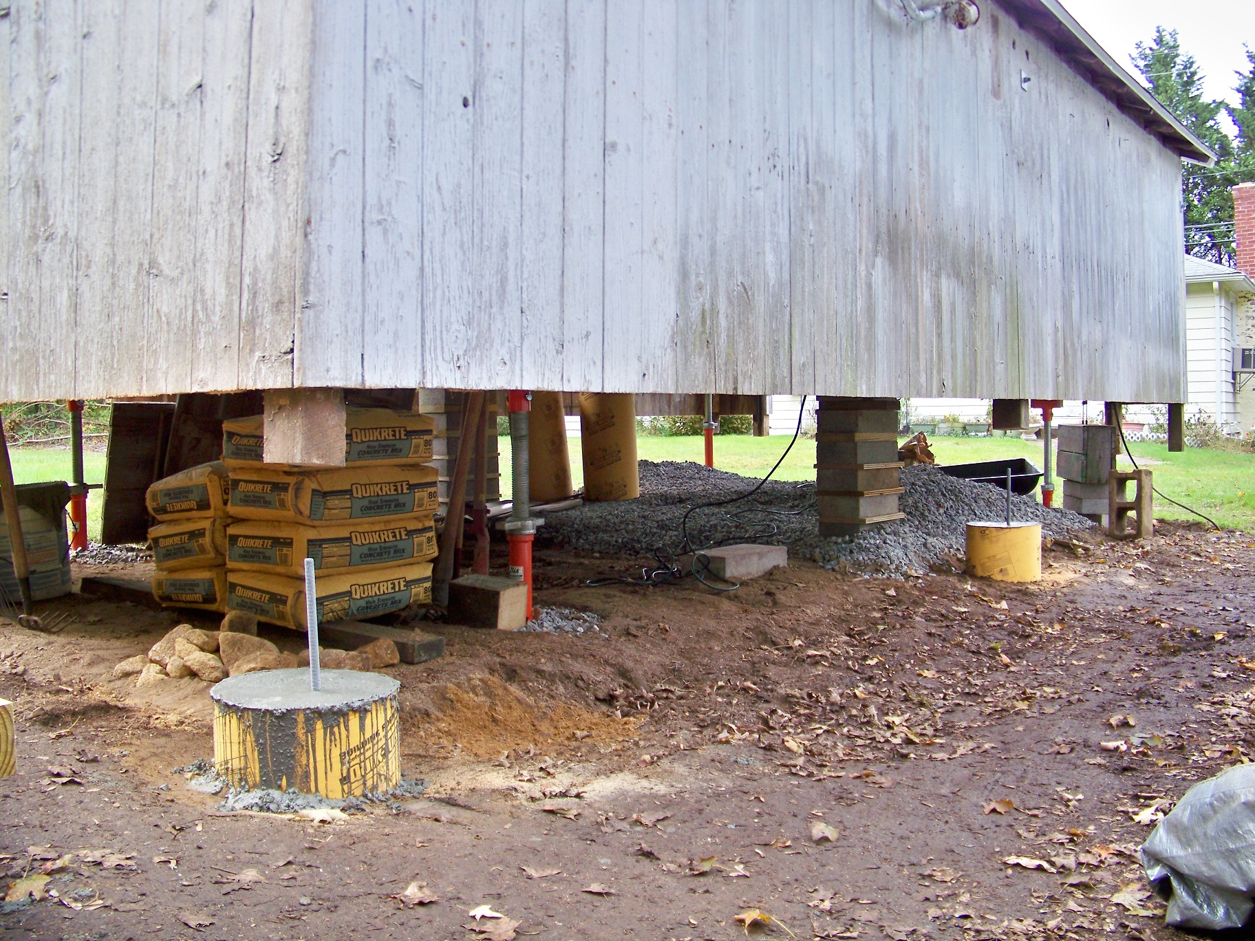

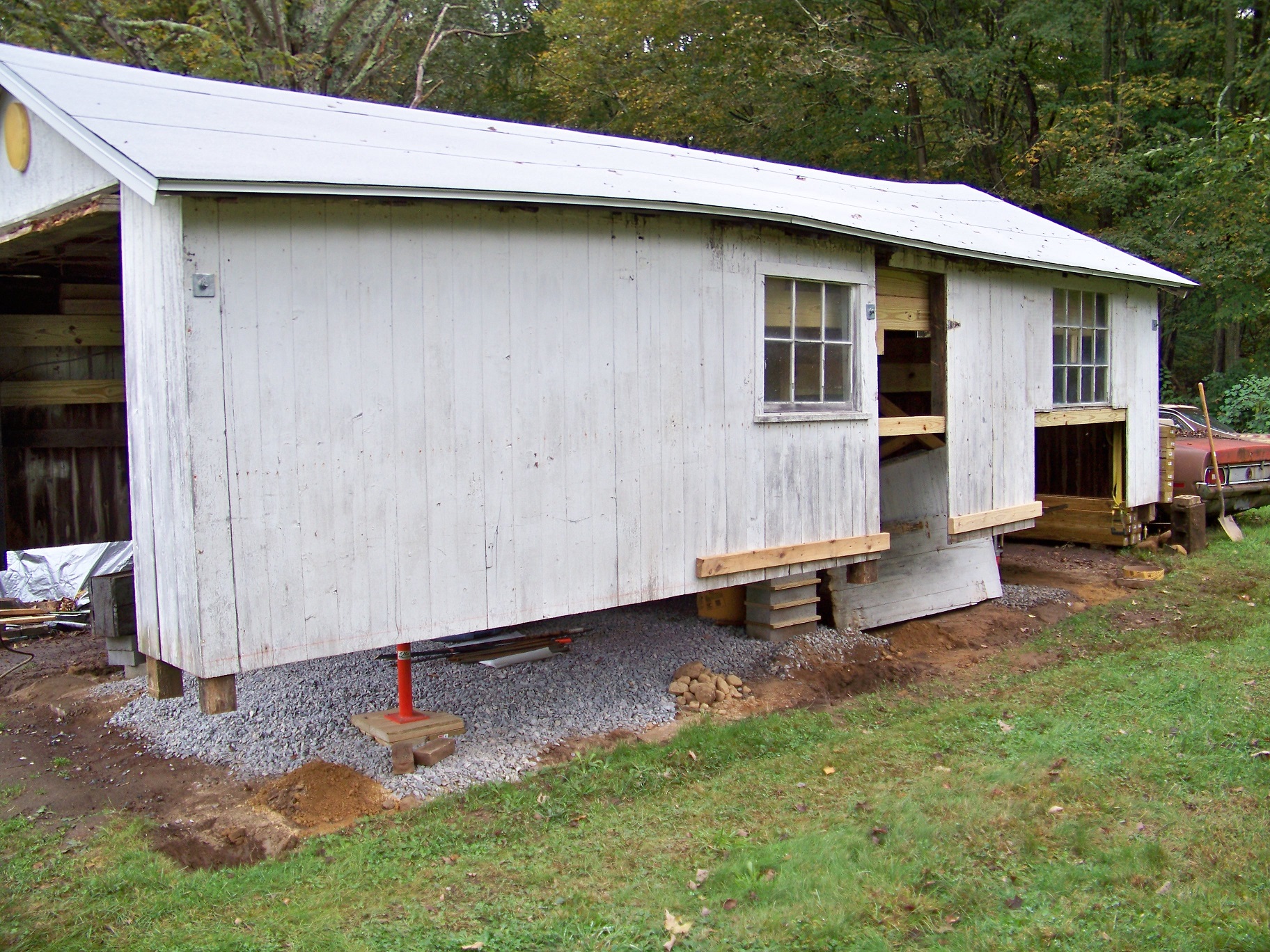

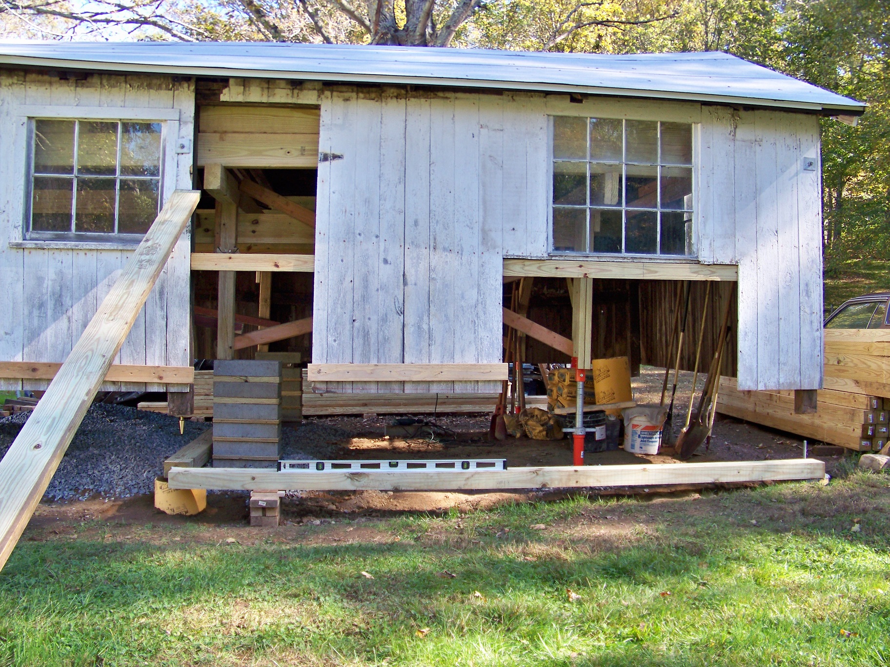

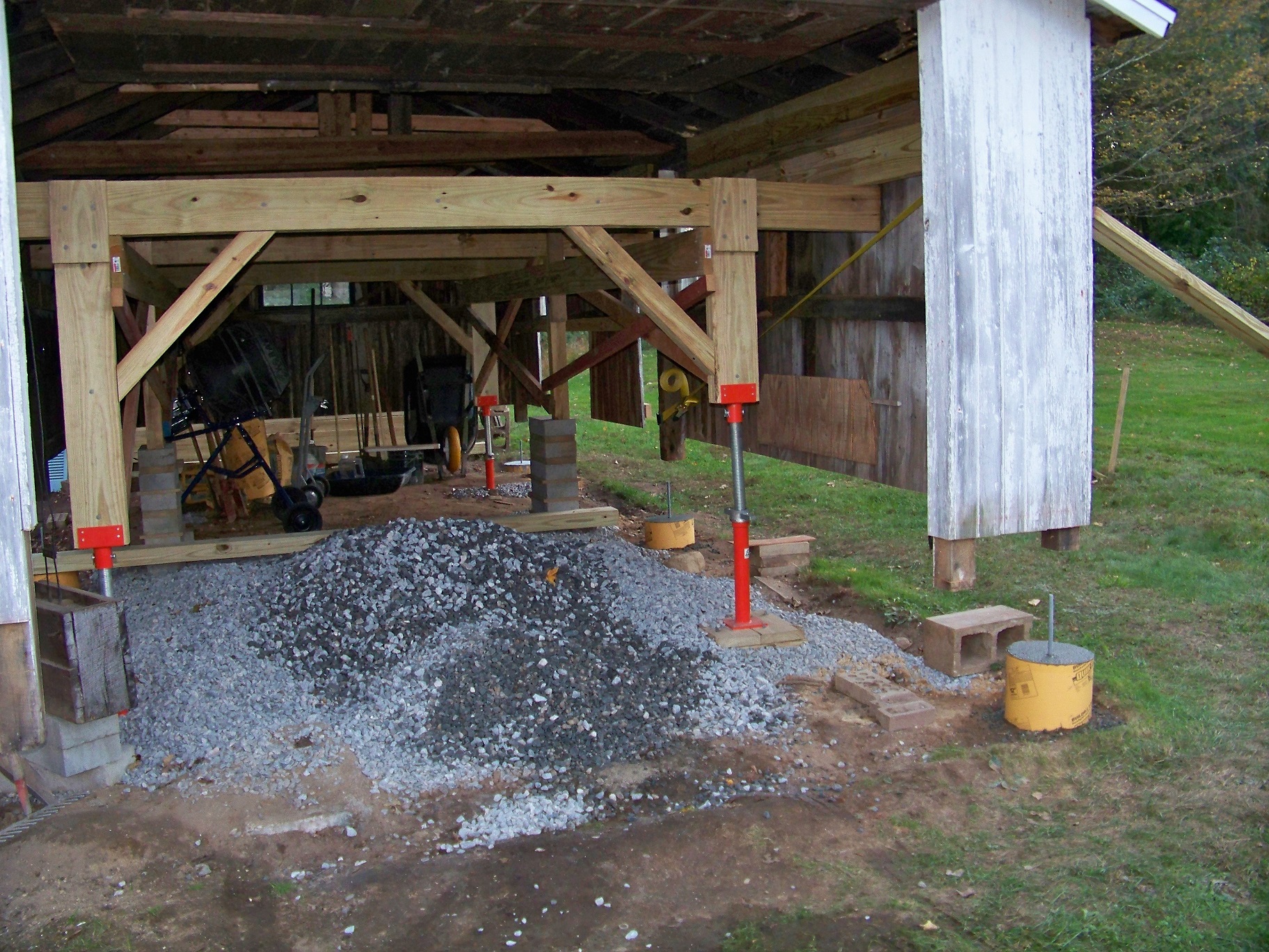

Progress Pics:
Moved the center cribbing so I could put a 4x6 from pier to pier and confirm level. Looks precarious, but the whole thing would stay up just fine without any center support.
Straightening the walls. Attempt #1.
After straightening:
The rear width exterior post to exterior post dimension = 12ft (144 inches)
Center = 147 inches
Front = 146.5 inches
When I bring the center and front dimensions to 144 inches, the walls are then angling inward and the garage door opening will not be big enough for the door to close.
With the center wall plumb, I see my pier hole needs to move. I should have predicted that.
Determining the height level of the center pier.

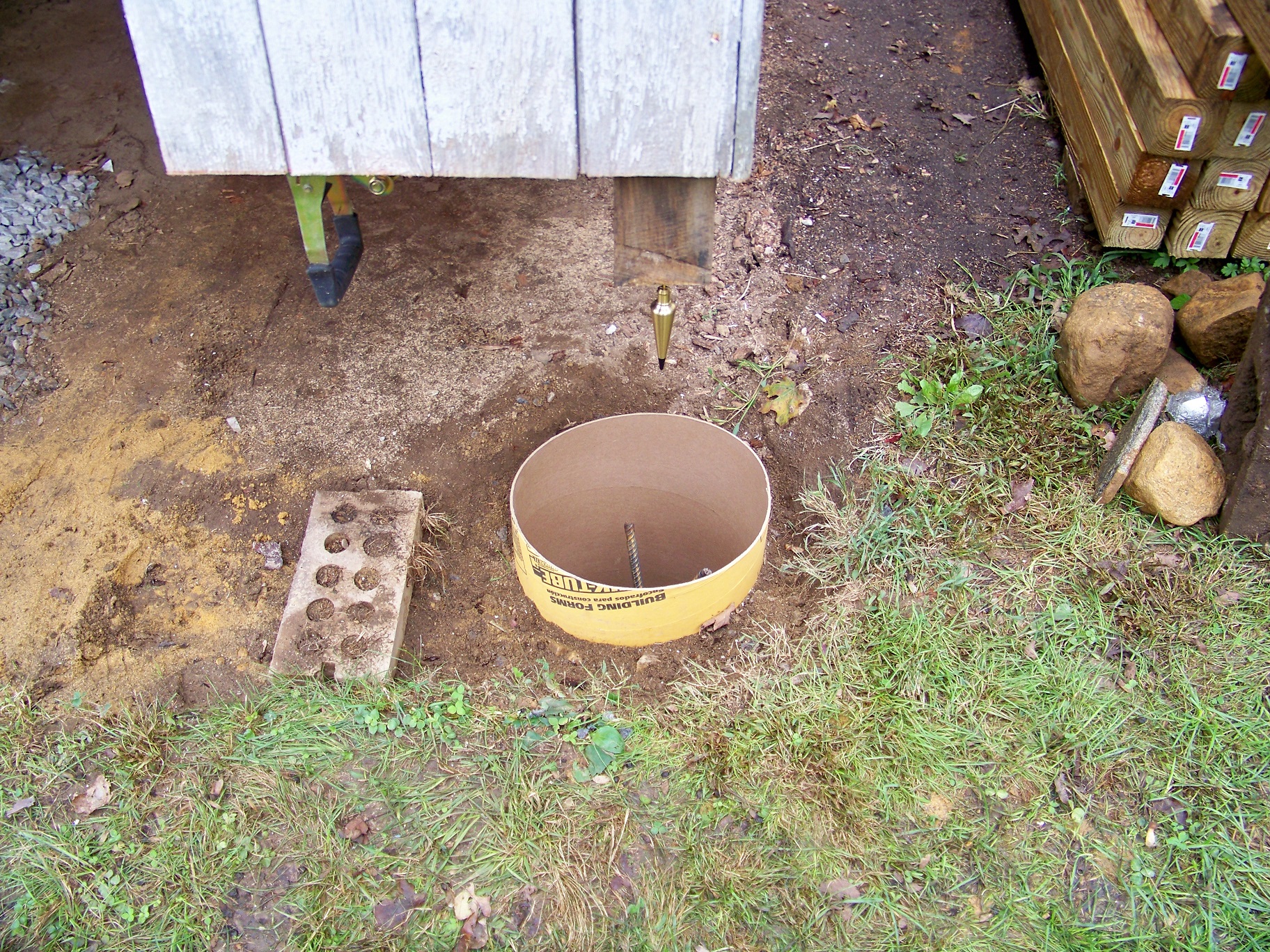

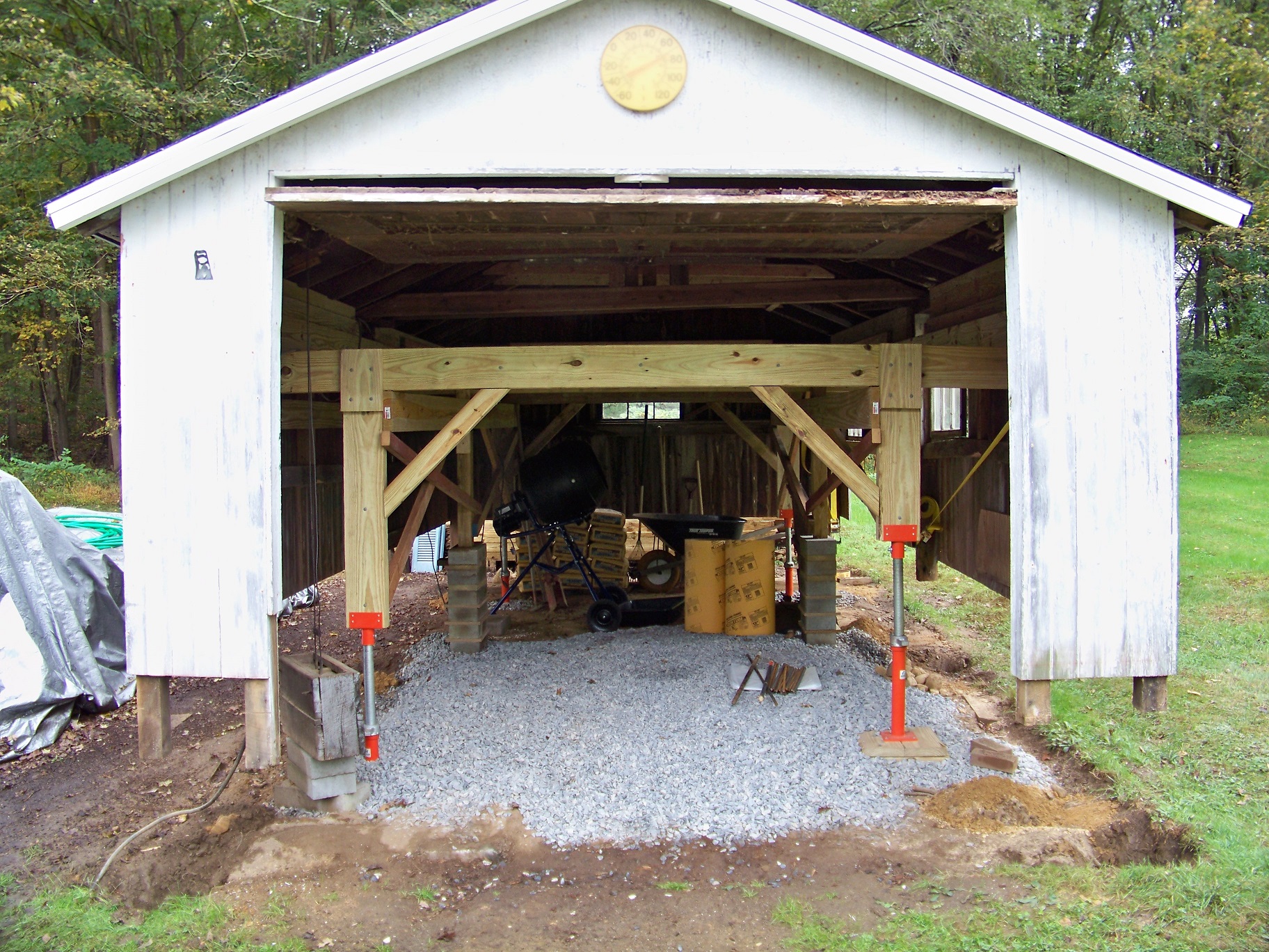

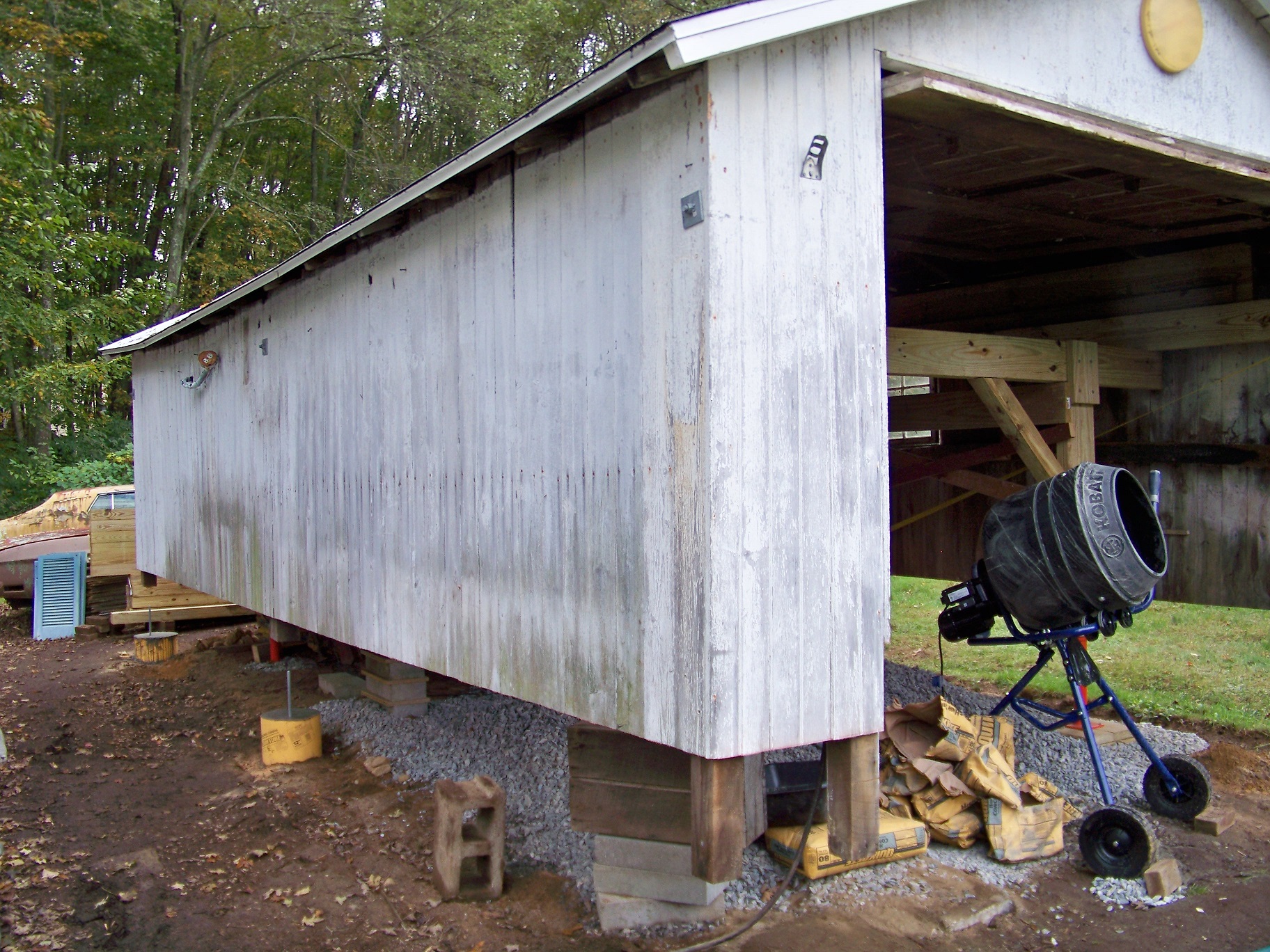

Progress Pics Continued:

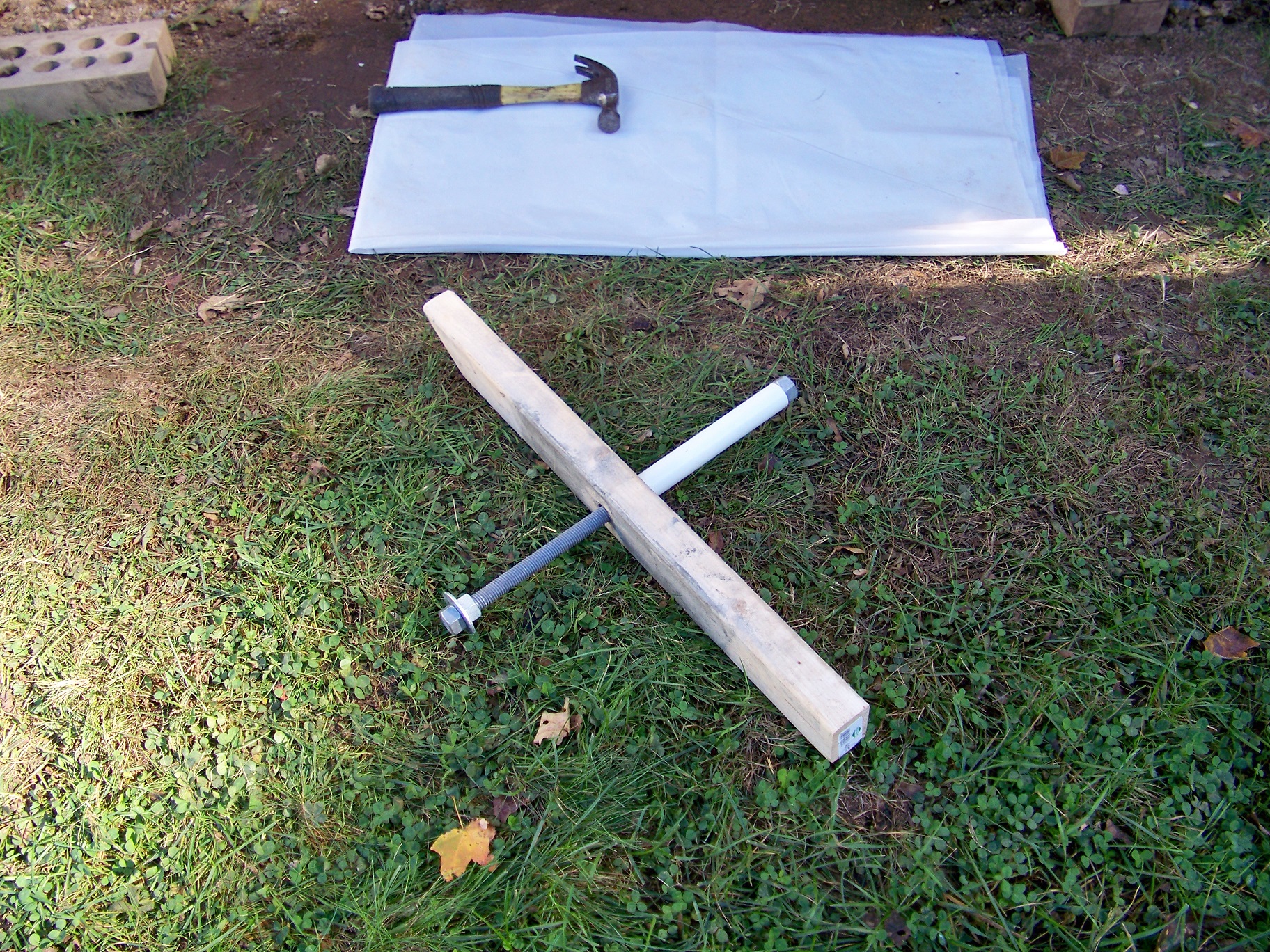

I made a jig to help install the threaded rod at the proper height and so I can put the rod in before the concrete. Inserting the rod after the fact is a PIA.
Seemed like a good idea until after I put the concrete in when I went to remove the PVC spacer the post above it was in my way. Still made it easier, but tool needs improvement. With only one pier left to go as I write this, I'll just use the PVC as an unattached guide.
Abandoned the ratchet strap in front in favor of another 12' 2x6 to plumb the front. I moved the threaded rods in towards the center of the garage (away for post center) since I need to make sure I have enough engagement with ends of the 12' 4x6s and I'm not sure I can solve the 147" post issues without messing with the top plate.
Another ton of gravel shoveled from the pickup. That makes 4 tons so far.

Being 3 inches wider at one end maybe the way it always was? I wouldn't dwell on it too much, just get it functionally straight and leave it be. After all, its not a Church!
