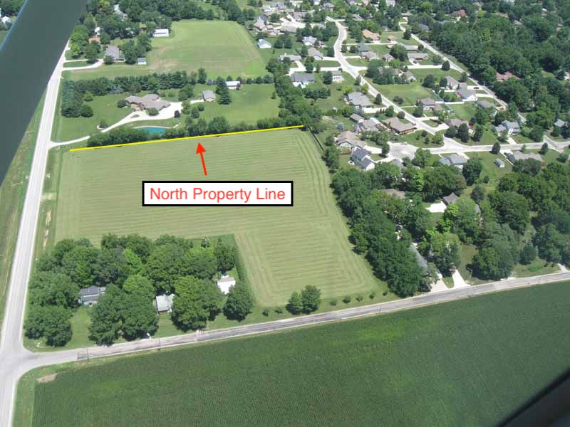

For David, asking about yield map information and what we do with it.
The corn yield map showed very poor yield along the north property line. As you move further from the property line, the yields increased in direct proportion to the distance from the property line. My neighbor to the north lets his side of the line grow naturally for several feet from the line. There are large trees and bushes there that we suspect are sucking much of the moisture from that part of the field. I keep my side cleared back to the line except for grass. I didn't realize the impact those trees and bushes were having on the crop until I saw the yield map. The reality is, there is no need for me to plant too close to that line since the crop won't do well due to lack of moisture. It doesn't affect alfalfa to any large degree, but it certainly had an impact on the corn production.
I can see the same problem to the east side of the field (right side) where there are hedge trees, but to a much lesser extent.
That's because I already keep the edge of the planting 30' or more away from those trees.
A yield map can also show problem areas in a field such as poor drainage. That can be from the lack of drain tile lines or a collapsed tile. It also can help with seed variety selection, management of nutrients and herbicides/pesticides which could be targeted into that area. Going forward, research is being done to tailor crops for specific fields and their soil conditions. As I understand it, it's all theoretical right now, but GPS is making it possible. World leading crop research at the University of Illinois, less than 10 miles away from here, is ongoing. There's some exciting stuff on the horizon.
https://www.ag.ndsu.edu/publications/crops/yield-mapping-and-use-of-yield-map-data
Others here might add what they're doing with yield map data too.

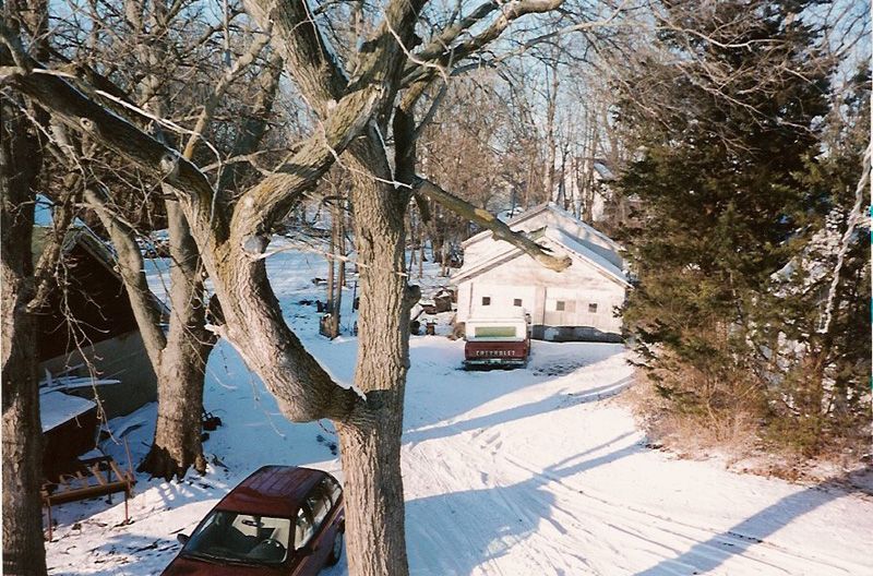

Hi everyone, for today's subject, I hope this is going to be a fun post for all of you, especially those who are long time readers. Here's a little bit of a reminder/background information because it's been a while since this topic was on here.
Mr Johnson was a bee keeper of the first rank, with dozens of bee hives kept on the property at one point. You can see many of those hives on the YouTube video, Restored 1930's Auto Shop:
To store hive material and to aid in harvesting all that honey, he built a small, dedicated building next to his detached 2 car garage. It can be seen in it's original size, 16 and again at 56 seconds into the video. It was always referred to affectionately as The Honey House.
Above is the Honey House (HH) in 2006, after I had refreshed it, repairing rotted boards, new siding and roof, rear roll-up overhead door, etc. This was it's final size, about 22' (6.7 m) long, overall. Originally it was roughly 1/2 this size.
Looking inside the HH in the above picture, right in the middle of the picture is a double wall stud. To the left of that stud, the interior is painted and the walls are unpainted to the right. The right side is where the rear, approximate 11' (3.3 m) was added to the building at some point. You'll see why this information is important in a moment.

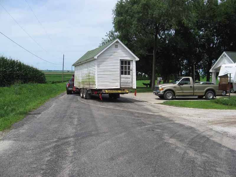

Looking back at page 495, post # 9896 you get to see the HH in 2016...
...being prepped, placed on a trailer and then moved off the property, rather than be torn down. Throughout this whole property resurrection, from day 1, I've tried to save, restore or recycle as much material as possible and not waste anything.
So the Honey House was placed on a trailer and moved to a friends house, 7 miles away to begin a new chapter in it's life.
Steve, the new HH owner, had the building initially placed on the side of his driveway. He then proceeded to cut the building into 2 parts, right where it was originally spliced together. That left him with 2 smaller building about the same size. After he installed new walls on the ends where it was cut apart and did a few other minor modifications, he had them moved onto their final resting spots. Here's a look, present day, of Mr Johnson's wonderful, little Honey House.

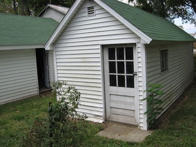

Above is the front half today, 2020, while below...
... this is from back in 2006 for comparison.
His wife uses it for a potting shed.
He added an extra window to the left of the door and in the back for more natural lighting. It still wears the siding on 3 sides and roof I installed in 2006.
The back half of the Honey House had a new front end installed and it now looks like...
...this. Steve installed the new front wall 2' back from where he cut it apart to create the 2' overhang. It looks like it has always been that way. On the front windows of the building...
...note he installed Beeline gas and Johnson Gasoline decals in the windows. He's got a very nice Johnson Gasoline gas pump that will be installed out front next spring. He gets the whole Honey House history and heritage thing and has embraced it. Steve knew Virgil from back in the day.
In the back...
...I had installed a roll up overhead door on the original building seen above. That same door...
...is still there and used.

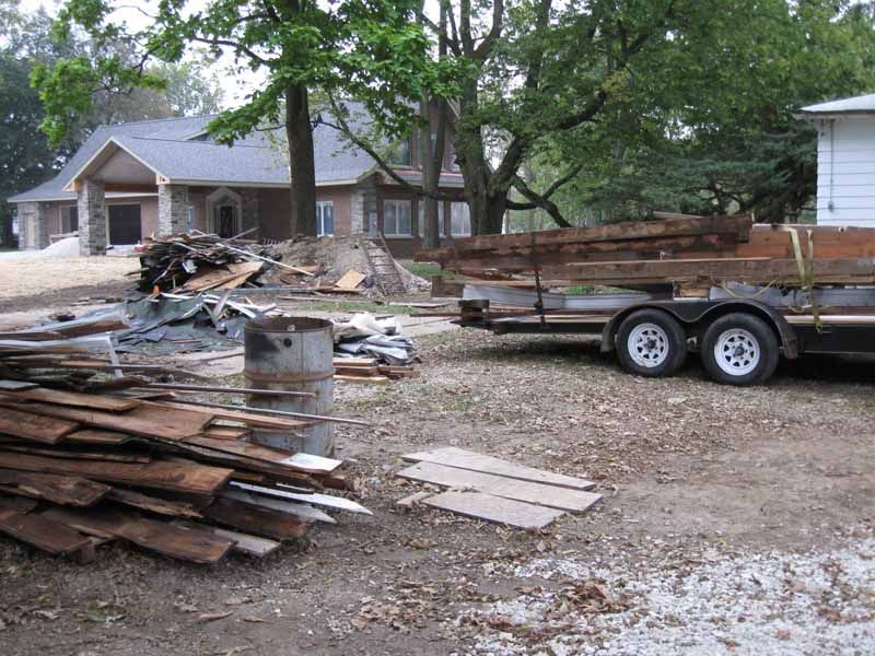

Slowly, Mr Johnson's 2 car garage...
...was taken apart piece by piece, to be saved and rebuilt in another location. The trailer in the foreground is how the various...
...pieces/parts were transported. These are wall sections loaded up on the trailer. It took several trips.
Soon, all that was left was the concrete slab the garage stood on. Note in the background, the exterior of our house is nearing completion.

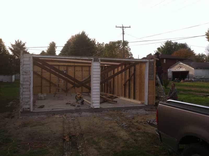

In another small town, 20 miles away, a new concrete slab was poured for the garage's new location. Here the old wall sections have been placed on the slab in preparation for the rebirth of the 2 car garage.
In the end, because the garage was so well built, removing the outer shiplap walls and sub-roof couldn't be done without destroying them. That necessitated new OSB siding and sub-roof but the heart of the old building remained. The wall studs, roof rafters and the new garage doors that I had installed in 2006.
Today, fall 2020...
...is Mr Johnson's 2 car garage, renewed and rehabilitated as it now looks some 65 years later. The new owner has done a marvelous job saving the old garage. So like the old shop, Honey House, 2 car garage and many, many tools and equipment have been saved, repurposed and will live on. I find that all most satisfying.
