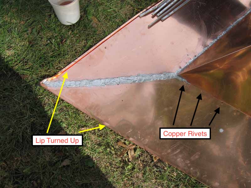

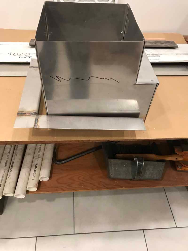

As I recall it was all counter flashed in a very traditional method all around the chimney. A shallow cut was scored into the brick face that the copper reglet counter flashing was let into. Similar to the other three sides that were counter flashed into the mortar joints.
Construction of the various solid copper saddle parts were all riveted together using copper rivets. Those seams were then...
...lead soldered to make them water proof. On the outer edges where the flashing is under the shingles, a small lip was turned up to prevent water from being driven up under the shingle and past the edge of the copper flashing.
This is a seam being soldered using a soldering iron and lead solder.
The saddle is done and ready for installation. All fussy work but the end result will stay dry and last for decades. The saddle was a very large piece so it was placed on a pallet and lifted to the roof using a forklift.

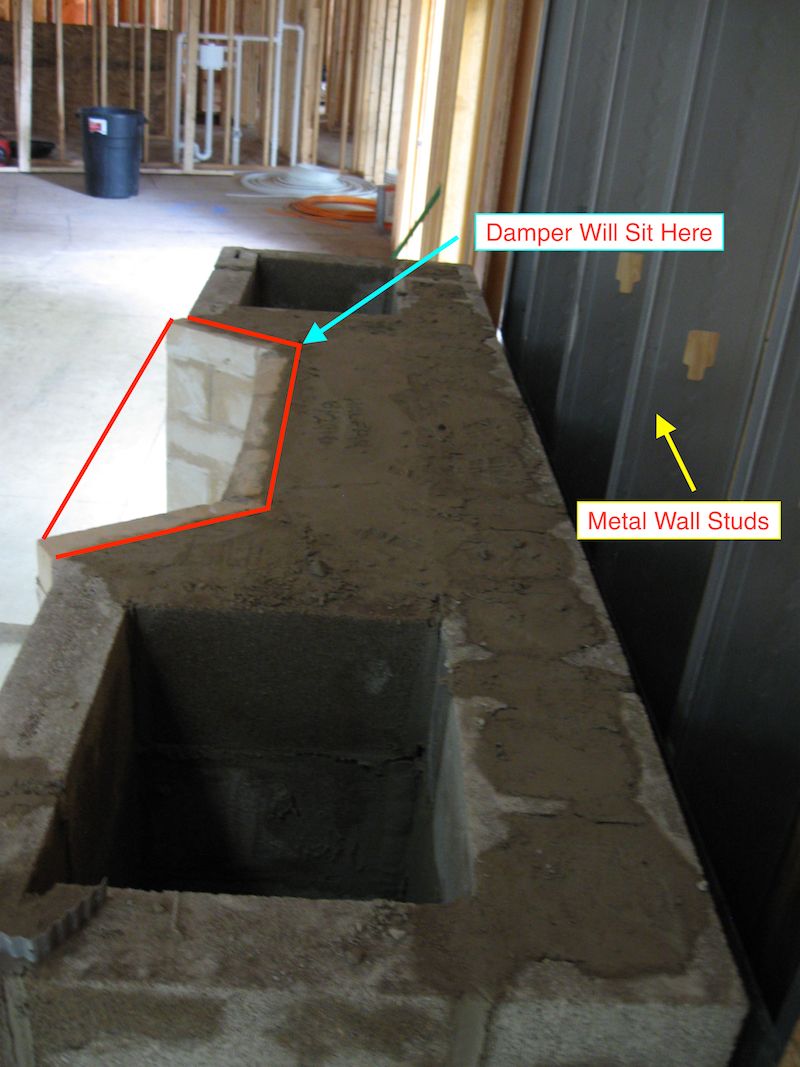

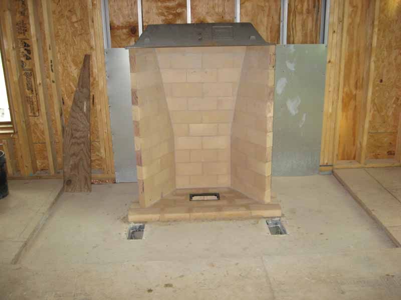

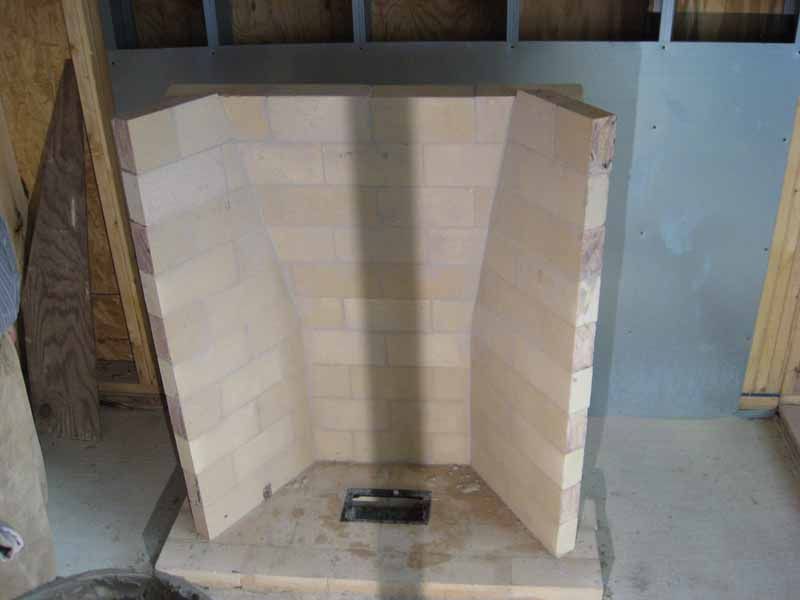

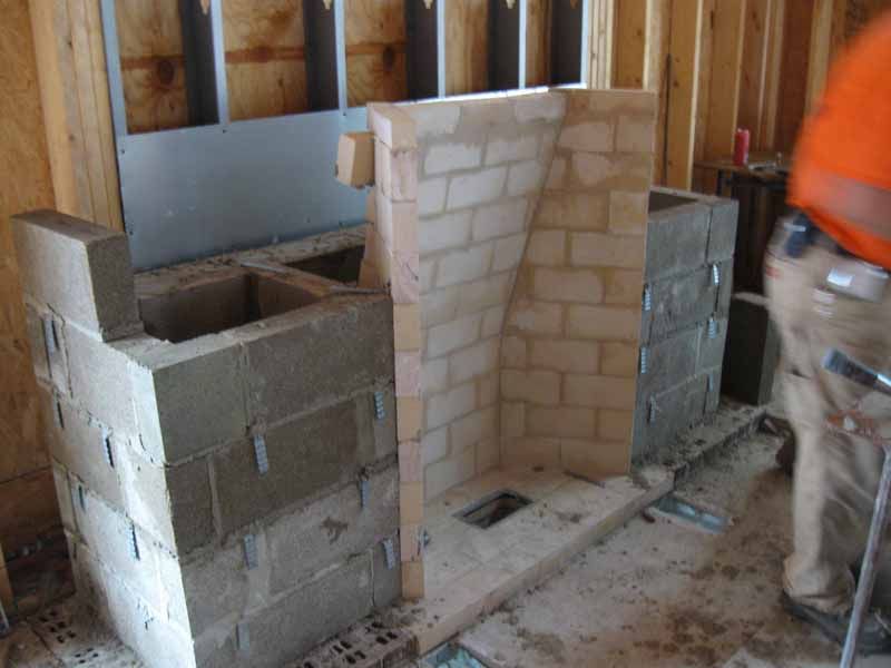

I'll start with the basic firebox. An overlooked design/construction factor is sizing the firebox mortar joints themselves. On the firebox, those joints are much thinner than normal mortar joints. The firebrick itself is high temperature resistant and high temperature refractory cement was used in the construction. But to aid in making the firebox last longer before the joints breakdown, they are made very thin so the surface of the firebox is almost exclusively firebrick with very little of the joints showing.
The damper I used is an infinitely adjustable damper. That will allow for fine tuning of the damper opening when in use. The hotter the firebox, coals and flue are, the more closed the damper can be resulting in more heat output into the room. It will sit on top of the firebox as seen here. The damper is made of cast iron which can rust over time. It is literally buried within the fireplace during construction and should it ever rust out, it would be an enormous and expensive undertaking to replace it, so I had my entire damper powder coated. That will give it an almost indefinite, useful life.

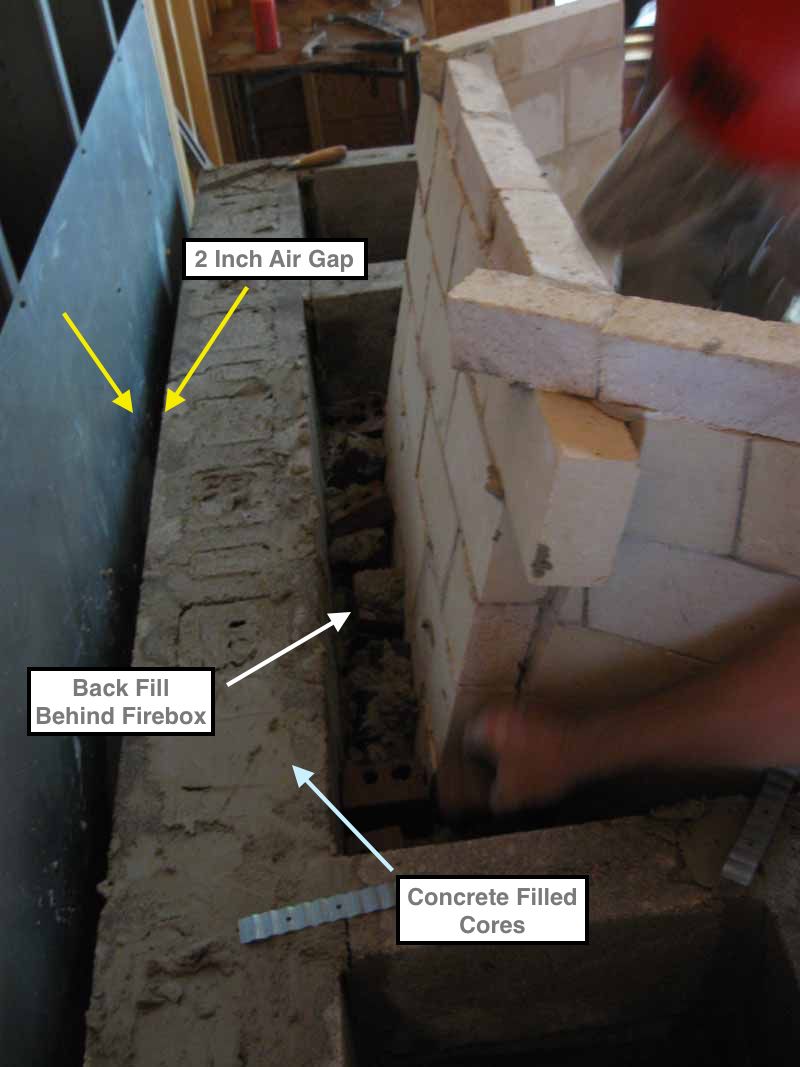

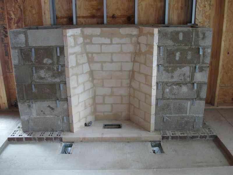

This is the backing block competed which surrounds the sides and back of the firebox.
Looking at the rear of the firebox you can see a 2" (5 cm) insulating air gap is used. The hottest area of the firebox is at the rear of it. Heat migrates out the backside and if there were combustible material behind it, over time it could ignite. To prevent that, behind my firebox we used only masonry material, the air gap, a shinny metal sheet to reflect heat back into the firebox, metal wall studs, fireproof insulation in the wall cavity and finally fireproof plywood on the outside of the wall which was then faced with exterior brick.
The space between the firebrick and the concrete block was loosely filled with masonry rubble if you will. Pieces of brick, stone and hardened mortar were placed there. The reason this material was left loose was to allow for expansion and contraction of the firebrick. If that space behind the firebrick were filled and hard packed with mortar or cement, the firebrick would eventually crack from being restricted in movement.
Lastly, as seen, the backing block cores themselves were mortar filled. This added to the masonry mass of the fireplace, giving a place for heat to be absorbed and held until the fire is out and then, releasing heat slowly back into the room. This is why the entire fireplace is located within the heated envelope of the home. I don't lose any of the heat out the back or sides of the fireplace to the outdoors. It greatly enhances it's efficiency.
Here's a look at the blocking area behind the firebox once it was completed. On top of the loose fill material next to the firebrick, about a 1" top layer of mortar was placed to seal it off. Note where the damper will be placed, right over the top opening of the fire box.
Next is the start of the construction of the smoke shelf and smoke chamber. The damper in set on top of the firebox as previously seen. Then, 2 courses of ordinary brick are laid up around the opening at the top of the firebox. On top of the second course of brick, a secondary, steel angle lintel is laid. It's the grey angle iron Steve is seen installing above. The magenta colored line, running top to bottom behind Steve, is the plumb bob line that was used as a reference point when laying the stone corners.
Here's another view. The black object in the center is the damper and above it is the grey, secondary lintel. I had it powder coated as well. I'll explain what the fiberglass insulation was used for in a moment.
From the other side here's a good view and description of all the various parts. One thing to note is to leave clearance between the 2nd course of brick and the side of the damper blade. The damper blade needs to move freely and it needs to be removed when properly cleaning the flue.

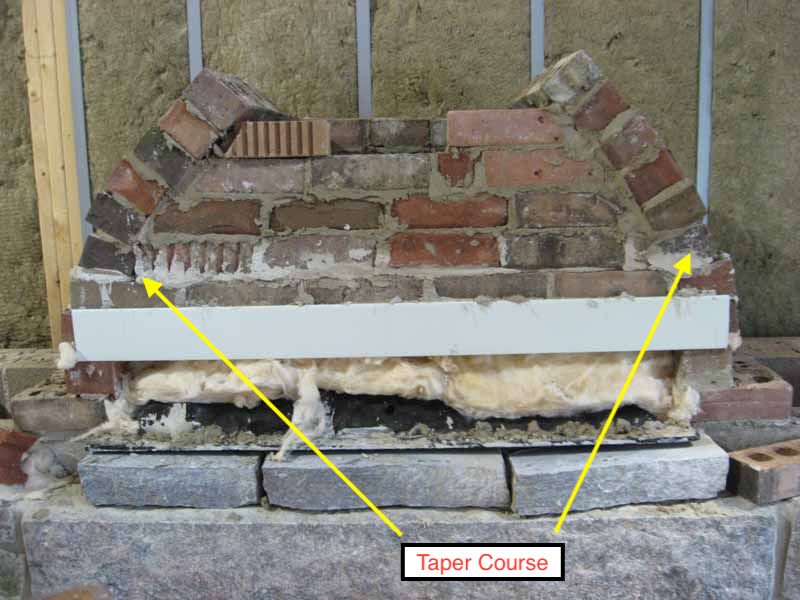

Here a 3rd course of brick has been laid, starting the forming of the smoke chamber behind the damper. Now the reason for the small, little rolls of fiberglass insulation, placed on the ends of the damper and secondary lintel. They prevent mortar from getting into the ends of the metal damper and secondary lintel. Those metal pieces need room to expand from heat longitudinally so the fiberglass gives it a little cushion room for that expansion. If mortar gets in there, solidifies and tries to prevent the metal from expanding, the metal will expand from heat and crack the mortar joints that will eventually gravitate to the outer stone and crack those mortar joints.
This is an overview of the smoke chamber being completed using taper bricks on the 5th course of brick.
From the side...

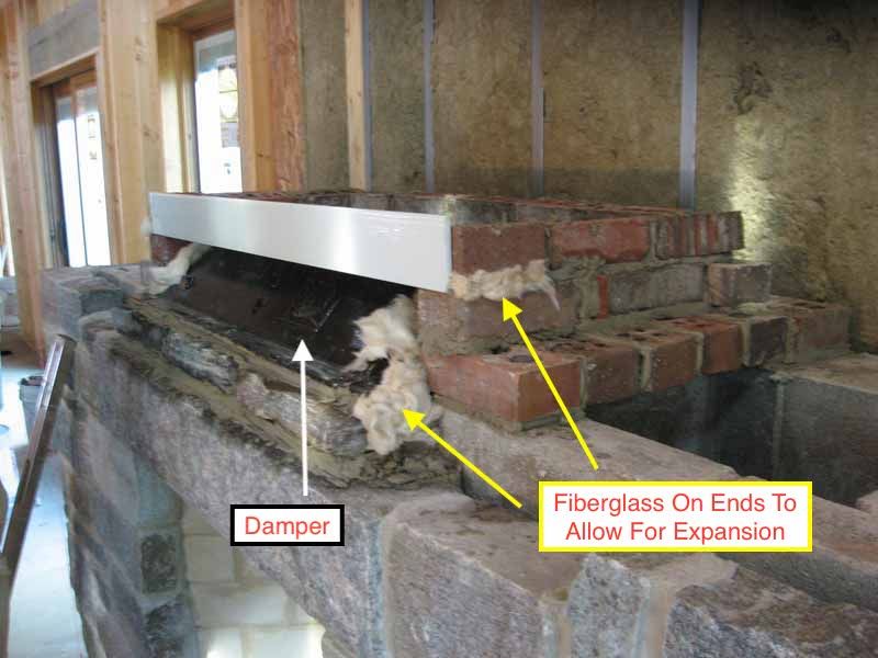

...and as seen from the front. The course that is being pointed out; those bricks have been cut on a taper or wedge shape, to start the arch of the top of the smoke chamber. You can now easily see the need for the grey, secondary lintel. It is necessary to support the bricks that are above the front of the damper. The front of the damper slopes and cannot support any bricks above it, hence a secondary lintel is needed.

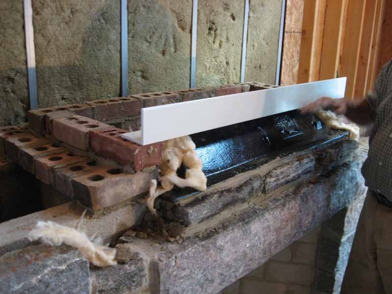

The first or primary lintel...
...is the one across the top of the face of the firebox opening.
Note that fiberglass was placed on the ends of it as well to provide room for longitudinal expansion of the metal.
That steel lintel supports the lintel stone as seen here before its installation. Using steel angle iron will help the lintel stone carry the weight of all the stone above it. Due to expansion and contraction from the heat of the firebox and the wide opening it spans, the lintel stone, without any additional support, would always be at risk of cracking. :eek:

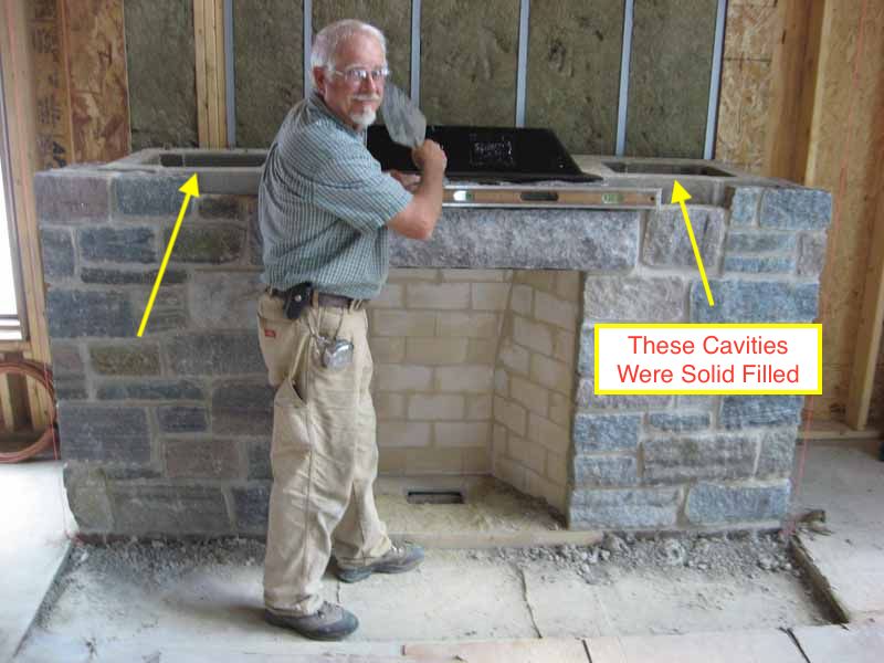

Those are excellent questions Fix Until Broke! Let's see if I can further illustrate and clarify how and what we were doing with this fireplace.
With this being a clean sheet custom home, to start out I had to decide where I wanted the fireplace in that room. I chased it's placement on the blueprints all over the great room from 3 different walls and a corner. There were pros and cons with several of those different locations. Ultimately I choose the east wall. Then I had to decide how large overall I wanted the fireplace structure. It's a large room with a tall ceiling which I felt needed an equally large fireplace for best overall visual balance and appearance. I decided to make it 8' (2.4 m) wide, so into that space, Steve and I decided a 36" (91 cm) Rumford firebox would work nicely. That size Rumford would give good heat into the large room and overall would have a balanced appearance with the large fireplace structure.
So if the firebox is 36" wide ( and since it's a Rumford, that makes it 36" tall as well) and the overall fireplace structure is 8' wide, there will be void spaces on the sides that are necessary.
I believe these are the voids you were referring to. The basement fireplace block foundation...
... seen here on the left, is separated from the upper fireplace structure by...
...the concrete slab that was poured above the block foundation. That slab was re-bar enforced and is over 10" (25 cm) thick. That keeps those voids you mentioned from going all the way down to the basement.
Over time, eventually those rectangular voids or cavities were solid filled with masonry rubble and mortar. Doing so made them part of the masonry mass and they then provide heat storage when the fireplace is in use. Don't confuse these 2 rectangular void spaces with the area right behind and next to the firebox. That space is loosely filled to allow the firebrick to expand from heat.

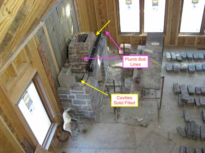

As an aside, here are the 2 plumb bob lines that were used as reference for the outside stone corners.
Here is the fireplace going through the roof, that's the flue in the center. On the right, you can see those void spaces or cavities have been solid filled up to the roof line.
The filled void spaces were then capped with 4" block seen above to the left of the flue. All above those capping blocks...
...those void spaces, were left empty all the way up to the crown. No need for masonry mass in the chimney above the roof line.
At the top of the chimney, to construct the crown, those voids needed to be capped. Re-bar was set on the inside corbel space and...
...4" concrete blocks were placed on their sides.
Tar paper was then placed over the blocks and the concrete crown was poured. More information on the chimney crown installation can be found on page 509, post# 10,177.
So, to sum this up, the void spaces are there because of the width of the fireplace. In the heated envelope of the house, those voids were solid filled to add to the masonry mass. Above the roof line, they were left empty or void up to the crown.

One more question regarding the fireplace, near the top of the voids, the is a row of bricks on end. Is this to let the voids breath a little? I would imagine that they heat and cool quite a bit, just curious
Thanks for the excellent tutorial on the Rumford fireplace...fascinating stuff.
offroadtoad, thank you for the nice words. Steve reviewed the fireplace posts and felt they were a good explanation of how and what we did on the fireplace.
As for the brick question, I'll assume the picture and void you're referring to was of the very top of the chimney, just under the crown. Those bricks were just used as space fillers and had nothing to do with the voids needing to breathe. I'm glad you asked though, thanks.

A small, powered, temperature controlled, vent fan was installed near the peak of the garage gable end as seen above.
In the garage attic, this is where a hole was cut for the vent fan. It's situated high enough to assist the roof ridge vent in extracting hot air. It's a slow turning fan, moving about 300 cfpm of air. That slow speed also helps to keep it quiet when operating. That is the north end of the house and I do have ample overhangs there, but I was still concerned about rain being driven into the fan unit resulting in leaks there.
To prevent water from getting in, I had this stainless steel shroud fabricated to house the fan unit. It is installed through the hole cut in the side of the house. The air inlet for the fan is from the attic and it's exhausted out the bottom of the unit so water, realistically, can't be blown into the fan. The exhaust outlet has a stainless steel screen over it to keep critters out, mainly birds. I fabricated the stainless flashing to seal the whole assembly to the house. The flashing was installed opposite of what is seen in the photo and the sides of the flashing were placed under the shingles on the exterior wall.
Here's another view if that helps you visualize the shroud and flashing. Disregard how it's all oriented.
In the summer, I replace the garage ceiling attic access panel with a louvered panel so hot air in the garage space can be drawn up, into the attic and exhausted outside by the vent fan. The vent fan is controlled by a thermostat situated in the attic.
When all completed, it's fairly unobtrusive and since it's on the back of the house, my neighbors are the only ones who get to admire the craftsmanship of it all. :eek: I'm happy to report that it works well. Virtually silent in operation, summer garage temperatures now rarely get above the low 80's by day and by morning, the temp is all pretty well down to ambient. The overall system is very simple and basic. Works good and should last a long time!

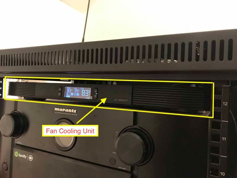

Three things became a problem as time went on. One is, I wound up installing more equipment in the rack than I had originally envisioned. Two, the components operate at a much higher temperature than I had thought and lastly, many components turned out to be larger in size. I did this part of the initial design around 2014-15 and electronics, outside of the run-of-the-mill audio visual components were not considered. Cable boxes, routers, switches, WiFi components, SONOS components and other miscellaneous equipment over time had to be installed. As a consequence, the equipment is bunched close together and it all generates heat. Some components run over 95ºF (35C) when they aren't being used, and operate at even higher temps when they are in operation.

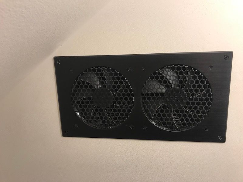

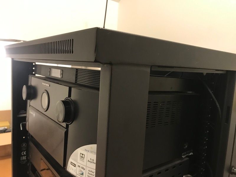

Heat is the enemy of electrical equipment. Excessive heat leads to a shorten life span and less than optimum performance. I had hoped that the passive vent placed over the doorway, seen in the second picture at top, would provide adequate venting of hot air out of the room. It turned out that vent wasn't enough, I had to mechanically move hot air out of that room.
I installed this wall fan unit above the rack that in turn exhausts air out of the small electronics room and into the chase. Since the attic air spaces in the house are conditioned, I had no worries about evacuating hot air into a really cold space. I just wanted the hot air removed from that room.
Additionally, I installed...
...this enclosed fan unit on top of the rack. In that location, it pulls air up, through and out the top of the rack. Then the wall fan unit removes hot air out of the room. New, cooler air is drawn into the room under the door. The operation of these fan units are tied together with a common temperature controller and are whisper quiet.
The upshot of it all is, the room stays near house temperature (it's about 6º warmer) when no high heat equipment like the receiver is operating. If the receiver is operating, the temperature on top of the rack rarely exceeds 88ºF (31C). I don't have a A/C outlet in there, so just circulating ambient air through the rack and evacuating it out of the room keeps the equipment temperatures cool enough that they won't be damaged from heat.
In retrospect I would have provided for more air circulation in that room. As it turns out, the actions I've take seem to be adequate enough. I hope this information is helpful for anyone out there that might be doing some electronic installation in a small, enclosed space. Live and learn. :dunno:
