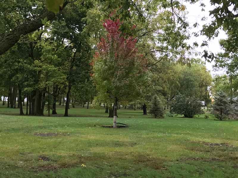

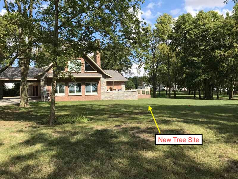

Mature Tree Transplanting

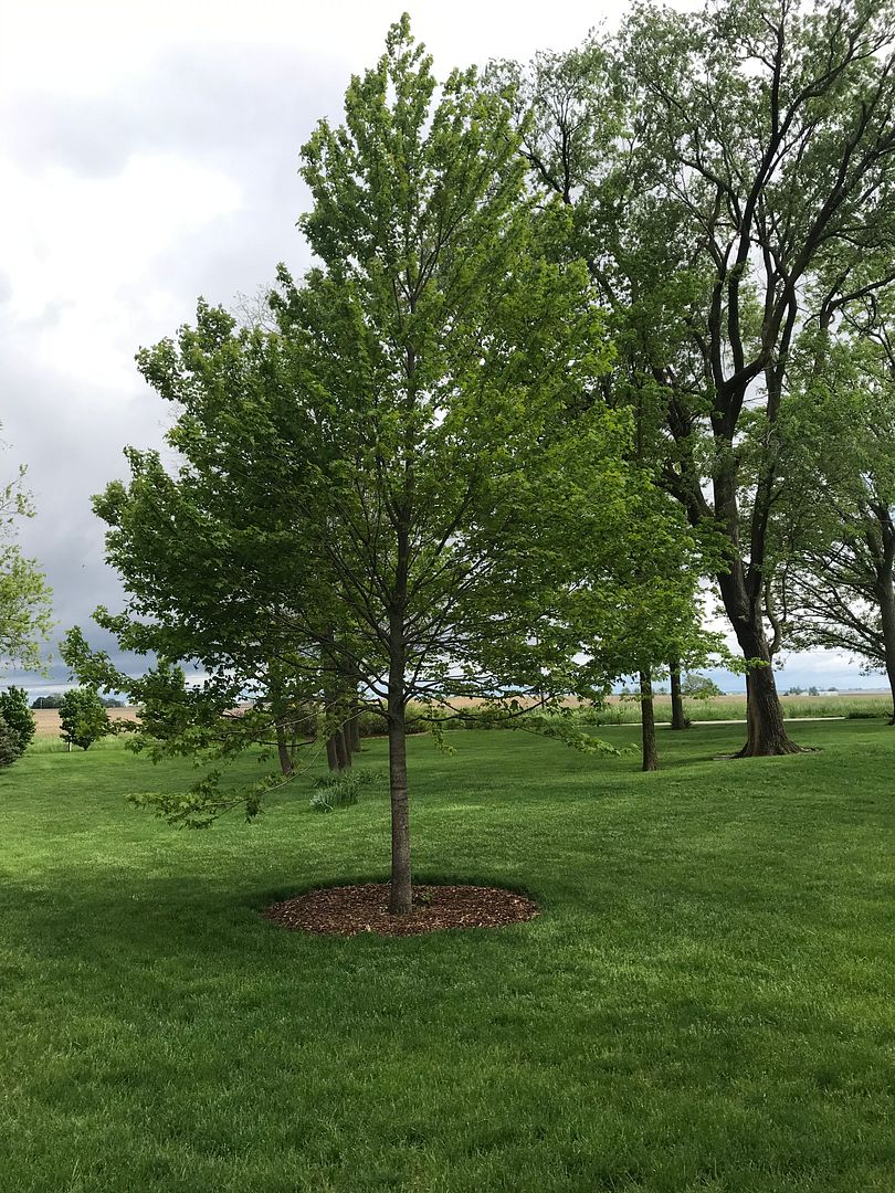

We're in the heart of winter right now, Feb, 2021. The low temperature this morning was -2ºF, with a high of 9ºF. With those thoughts in mind, I'm going to discuss the loss of our one and only pecan tree and it's subsequent replacement.
The pecan tree was blown over in a storm, summer of 2018. It was a very mature tree that happened to be well placed, south of the deck. It left a large area of the yard open and to my eye unbalanced. I was determined to replace it with as large a suitable tree as I was able.
About a year later, fall of 2019, I found a local fellow, Rolly, who has been successfully transplanting very large trees for over 25 years. I met Rolly at a local tree farm and gave him my general idea of what I thought would be good replacement candidates. From that we narrowed the selection to available trees and I settled on an extremely nice and straight Belgium Maple. It was close to 30' (9M) tall and 6" (15cm) in diameter.

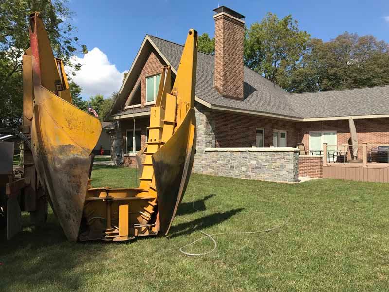

After the new tree site was identified...
... Rolly brought his large tree spade over to dig the hole where the new tree will be placed.
As you can see, it is a very large tree spade.
With the hole dug...
... Rolly returned with the new maple.
You can see the hole that Rolly is backing up to on the right, behind the truck.
Checking to make sure the tree spade is positioned correctly relative to the hole.
The tree is then lowered into the hole...
...and the spade knives are withdrawn sequentially making sure the tree sits completely in the hole at the right height and remains straight.

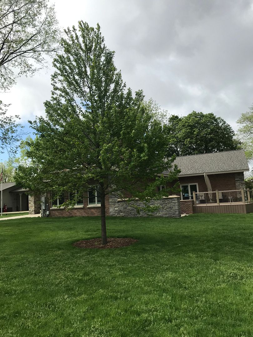

Voila‘, we have a new tree!
You can see where the new maple is relative to the old pecan.
This give you an idea of the size. Reference the stone corner of the house in the background and you can see how straight the trunk is. Fall is the ideal time to transplant trees. The maple leaves are turning red, indicating it is starting to go dormant.
I love trees, we have several dozens...
...spread over the property but there's always room for one more! This was fall of 2019. Looking ahead one year after it was planted...
...2020 and you can see the maple seems very happy in it's new surroundings. A welcome addition that should prosper, and grow for decades to come. Someday, someone who is as yet unborn, will enjoy the shade this tree will provide. Speaking for myself, looking these pictures certainly warmed me up! Really looking forward to warmer weather this spring!
As it turns out this weekend is our 4th year living in the house. We moved in Super Bowl weekend, Feb. 2017.
It's been quite satisfying to date to develop this property. The above picture was taken in 2006, roughly in the same area where the house now sits. I'm still tweaking things as you'll see, but it is all coming together nicely. Now I'm off to put a fire in the fireplace. If you're still interested in what's going on around here, check back. More is in store. Enjoy the big game tonight. Thanks everyone. :thumbup:

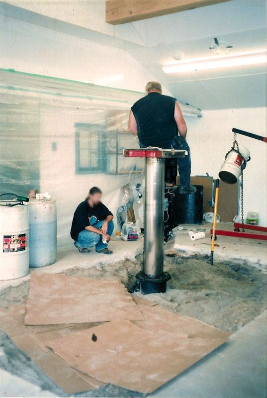

Lift Repair Details
I've never smelled Pecan wood burning and I'm wondering about how it smells. Do you know or if you don't, could you describe the fragrance of it burning. Thanks.
That's a good question. Unfortunately I haven't burned any Pecan yet. Probably.... no wait...... I'm sure I won't burn any Pecan until next year. My understanding is that it's good wood to burn in a fireplace. Presently, I'm burning mostly Hickory, Oak and some Walnut. I have burned some Apple before and it smelled very nice as well. I'll try to remember next year when I start to burn Pecan and let you know or you're welcome to remind me. :eek: Thanks!
Hi, I just checked out the restore of your shop and vintage lift. Get job! Wanted to ask you for some help with my 70's Rotary in ground lift. It apparently has a leak and I am going to dig it up and hopefully fix it. You said you found 2 pin holes in yours. How did you find them? Did you somehow pressurize it? Any help/ info you can give would be greatly appreciated. Thank you, Armin
Hello Armin, and welcome to our merry band! Congratulations for wading your way through some or all of this material. It is growing all the time. I'd be happy to help you as best I can with your Rotary repair.

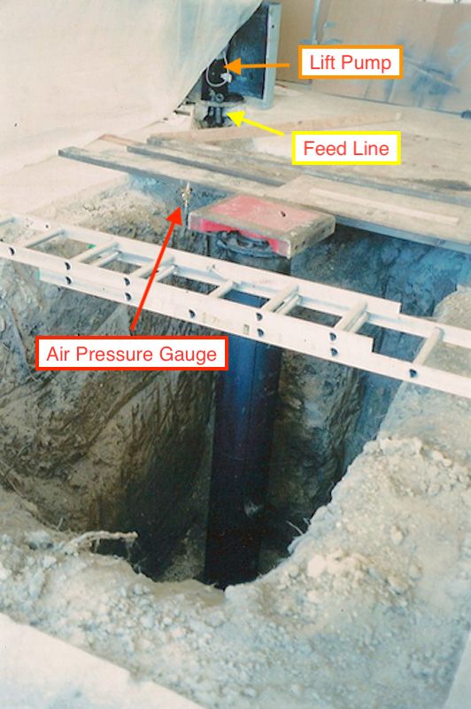

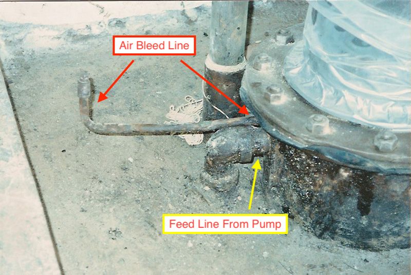

Thinking back almost 16 years ago (!) when I did my Rotary repair (spring 2006), let's see if this will help you.
The hydraulic fluid is an oil, so any leaks it has, it should leave a trace where it's leaking. My original hope was that the leak would be confined to the feed pipe or fittings to the lift cylinder. If it was only leaking there, I wouldn't have had to dig up the lift cylinder. So in the above picture, you can see by using a concrete saw and demolition hammer, I exposed the feed line from the lift pump to the cylinder. All the soil and sand around the feed pipe was completely dry, so the leak had to be somewhere in the cylinder itself.
With the lift cylinder out of the ground, I could see the outer surface of the cylinder was in poor condition. There were some stains on the metal where fluid had leaked, but to be sure I found the exact leak or leaks spots, I pressurized the cylinder with air. Doing so easily exposed the 2 leaks.
Your cylinder will have a feed line to it from the pump and it should also have a way to bleed air from the cylinder. This is how my lift looked before I removed it from the ground. Note the poor condition of the bleed line from corrosion. Using the old bleed line provided a way to introduce pressurized air into the cylinder.
A cap and short pipe ****** was threaded on to the feed line cylinder fitting to allow the cylinder to be pressurized. Note the new outer cylinder casing I welded completely around the old cylinder. I did that just in case a new leak developed in the old case later, once it was reinstalled back in the ground.
Here is a pressure gauge and air chuck fitting installed on the bleed line.
Here's a look at the same thing from a different angle. Using air pressure will allow you to find any and all leaks there might be in the cylinder. I do apologize for the poor quality picture. That was the best I could do with the camera I had at that time. Once the leaks were repaired, by using the pressure gauge, I could pressurize the cylinder, close the shutoff valve below the air chuck and wait 12 hours to see if it held pressure. I did move the lift ram to the top of its travel while the case leaks were repaired. That was to prevent any damage to the ram seals from the heat of welding.
All the leak checks and welding repairs were done with the cylinder laying horizontal on the ground as seen in the second picture from the top. I just don't have any pictures of that being done.
I did pressure test the cylinder once more after it was placed back in the ground, but before I back filled around it.
Once I was convinced all leaks had been repaired successfully, I back filled all around the cylinder with sand that was watered in every few feet and hand tamped it.
I used all stainless steel pipe and fittings for the bleed line and heavy, galvanized pipe for the feed line to prevent any future leaks from corrosion in them. I also coated the outer lift cylinder with automotive anti-corrosion material.
After it was back filled, with the lift plumbing all completed I tested it once more before concrete was re-installed and poured over the top. A heavy friend volunteered to use his weight to assist the lift in going down since it's only gravity return.
So there is the lift repair in a bit more detail than described on page 10, post # 181. Does that help Armin? Don't hesitate to ask for more information. Also don't forget Rotary Lift would be happy to give advice. Contact them here:

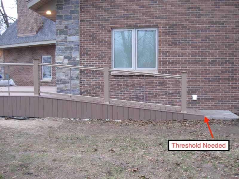

Deck Ramp Threshold
Hello Bill and everyone! Thank you so much for the post. Yup, Chris and I are both hale, hardy and healthy! We've had both vaccines and are good to go moving forward.
This has been an especially long ATP I'll admit, but I've been really busy as of late and didn't think there was much of interest to post about. But take a look at the following...

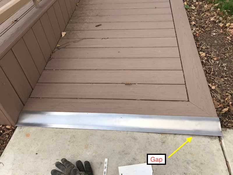

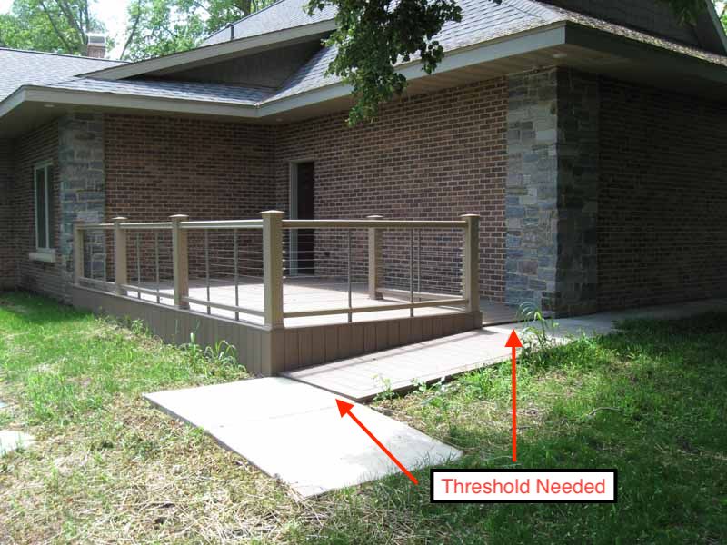

You might recall the decks both have ramps on them. To finish off the bottom of the ramps...
...I fabricated thresholds out of 12 gauge stainless steel.
To fully finish off the thresholds, 2 of them needed end caps...
...so these small triangles...
...were TIG welded...
...to the ends of them. Now when viewed from the end, there isn't an open gap.
Since the deck side of the threshold was screwed to the deck, I used stainless steel pan headed screws. Those holes needed to be...
...countersunk. On the concrete side, concrete screws were used...
...and normal holes were drilled there.
One ramp had a gap on one end where the sidewalk was tapered for better water drainage in the rain. To fill that gap...
...a piece of composite deck material was jointed...
...to create a tapered wedge piece that was installed in that gap...
...as seen here.
The view from the side.
This is the bottom of the ramp on the main deck...
...and here it is finished off.
This is how the end cap looks which finishes off the end of the threshold nicely. In time the stainless will weather and blend in better with the deck ramps. 12 gauge material is beefy so there is no flex on the thresholds and stainless will last practically forever. Do it once and do it right.

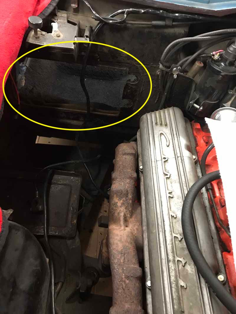

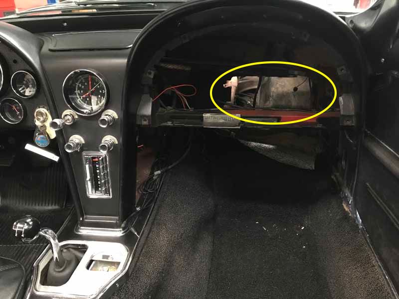

I've been doing other small projects as well. Presently out in the old shop...
...I am repairing the heater core in the '66 Corvette convertible. More about that later.

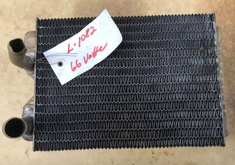

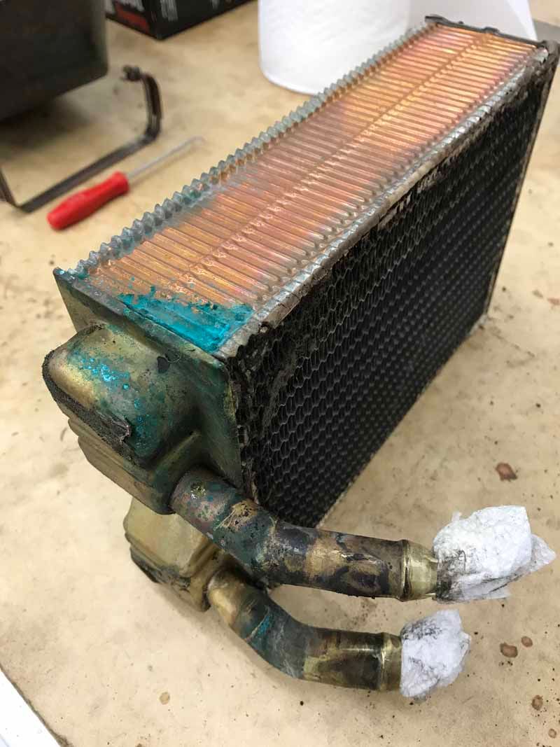

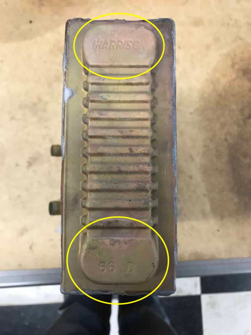

I got the original heater core back after it was repaired...
This is the original heater core from the '66 Corvette convertible. It was made by Harrison, top circle and bottom circle shows 66 D. That decodes as made in April, 1966. My car was made in May of 1966.
It was re-cored and the hose *******...
...were reinforced and strengthened. I much prefer to keep everything as original as possible. These old cores and end tanks are made out of much better metal than a new replacement heater core and you know it will fit!
These are the folks ...
...who did the core repair. Nice work!
Presently I'm cleaning up and re-conditioning all the various pieces - parts that will be reused.
This is the view of the firewall where the heater housing is installed, seen from the engine compartment and ...
This is the view from inside the car where the heater core lives.
An awful lot of "stuff" has to be removed to give you access to the heater core, including the passenger seat. Not an especially difficult job, but it does require patience and time.

Breeze, I had number of people suggest while I was restoring the lift that it would be much easier and maybe even more cost effective to cut the ramps off and abandon the cylinder in the ground. Then install a modern 2 post lift. Now imagine that room today with a brand new lift in it. It just wouldn't even remotely have the same feel. It's again a case of those who "get it" and those who don't. The story you related is unfortunately all too familiar. Sadly that's why those types of lifts are becoming so rare today. I did have to put a lot of thought and effort into that lift, but I feel it's the crown jewel of the shop. I really wouldn't trade it for anything. In retrospect it was well worth all the effort and expense. Not even close.
The sharing part afterward turns out to have been rewarding as well. Thanks for your comment.

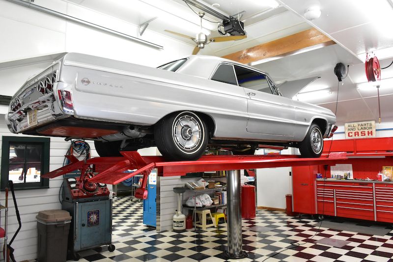

The last couple of weeks I've been using the lift pretty regularly getting this Impala ready to sell. The lift restoration was accomplished 15 years ago now and it still operates just as smooth and sure as it did when it was new. It's 92 years old now (!) and I see no reason why it won't be around for another 92 years.
It's such a pleasure to hear the whine of the hydraulic pump as it goes up and it's totally silent when it lets the car down. To spend the time it took to restore it was totally worth it. It's nice a few of you have gotten to see and hear it in action during your visits.
I've never operated a twin post lift but watching them in action makes me very grateful I've got a single post! Thank you Mr Johnson!

Here's a look at the old shop and barn this morning from out of a great room window in the house. Spring is here and my attention is shifting to outside work.
I've tried to save as much as I can from the old property, including Mrs Johnson's plants. The dogwood (not seen) was moved before the old family house was torn down and I tried to move as many of the flowers as possible but...
...the odd flower beds still pop up in the middle of yard. The one circled in the foreground was by the front of the family house and in the background are some that were near the back door. They now live by...
...Mrs. Johnson's persimmon trees and out of harms way. Additionally a couple of years ago I moved Mrs. Johnson's Tiger Lilies from what seemed to be the middle of the yard to...
...behind the address rock out front. So what use to look like this...
...now looks like...
...this using all material, rocks and plants from around the property. Some of the plants I've moved are over 55 years old now. Mrs. Johnson planted many of them in the mid 1950's when the family house was enlarged. They are historic to the property and I felt they should be saved.
So nothing glamorous this time around but the property is shaping up. I expect to be planting alfalfa next door in the coming week. Just did some soil tests but haven't seen the results yet.
