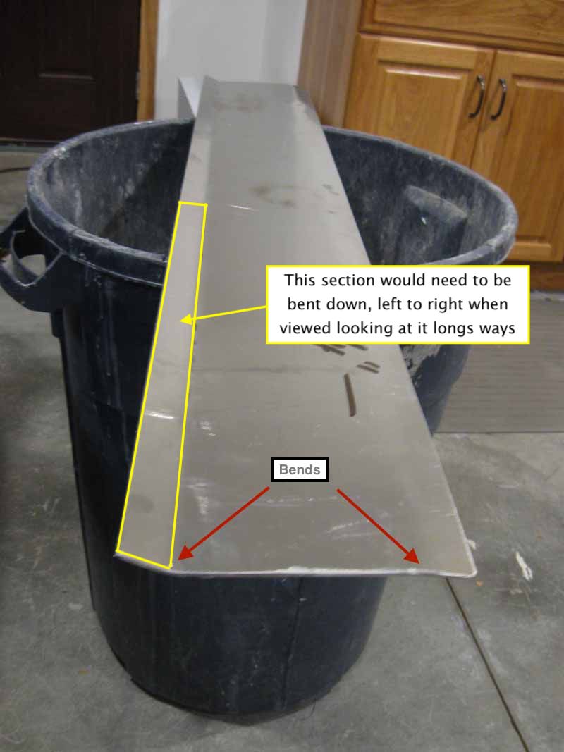

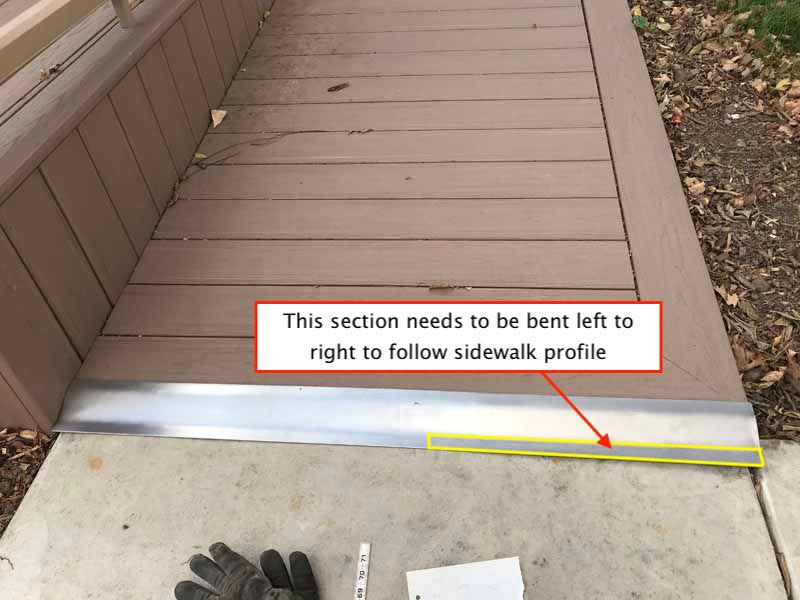

I'm another one who was surprised you needed to put a wedge under that stainless threshold ramp. Maybe I'm not understanding what you meant by a 'compound bend', but surely the sloping part of the ramp could have had a taper on it without needing anything other than straight bends?
Confused Pete :headscrat
Pete I've uploaded a couple of pictures and diagrams to Photobucket (PB) that might help explain what the issue was. PB has changed how I can post pictures so it just give a link and you have to click on the link to get the image to appear. Very unhandy but I'll try to make it work.
https://hosting.photobucket.com/images/u288/BB767/WedgeBend_2.jpg
In the above image if you click on the link, you'll see the area that has already been bent in one direction and where it needs to be bent 90º from that bend. To follow the contour of the sidewalk...
https://hosting.photobucket.com/images/u288/BB767/Wedgebend3.jpg
...seen in the above image. You'd need to bend either the small area I indicated or the whole area above it to follow the sidewalk. Using a brake to bend it can't be done, bending 90º across an already existing bend. 12 gauge material can only really be bent using a sheet metal brake, so to bend that second area from left to right to follow the sidewalk realistically can't be done, at least not that I'm aware of. :dunno: For the sake of discussion, I'm certainly open to how else this might be done.
Seeking Knowledge Thomas

Thanks for the links Thomas, but I'm still not getting it. What if the area between the two bends was tapered so it was wider on the low side of the sidewalk, the nearer end in your first link?
Oh, maybe I'm getting it - the sidewalk isn't flat so the bottom edge would need to be curved?
Confused Pete

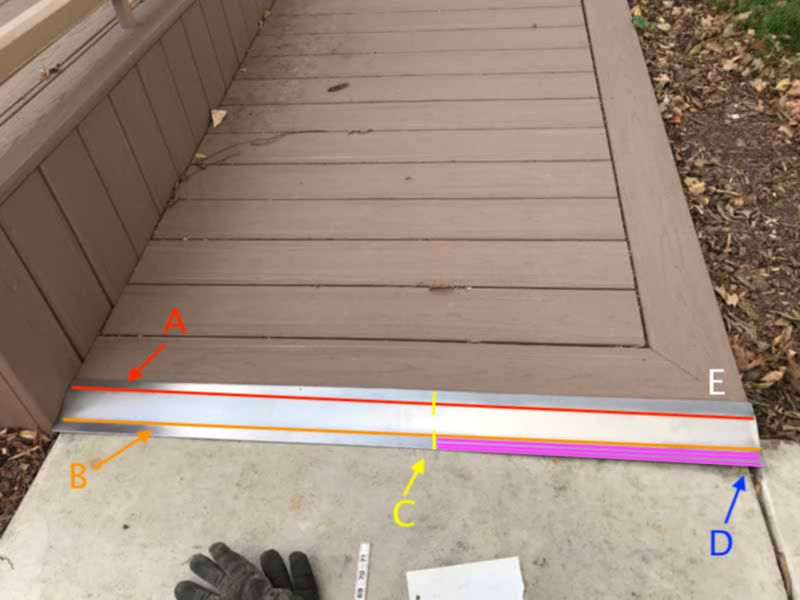

No worries Pete, this is something that in person would be much easier to explain and see. Let's try this...
https://hosting.photobucket.com/images/u288/BB767/TaperExplain1.jpg
Lines A and B are horizontal bends, that are from the left to the right, across the threshold as seen. Starting on the bottom of the threshold, in the middle at point C, the bottom of the threshold needs to be bent down to meet point D on the sidewalk. The sidewalk is not curved, from C to D is a straight edge, but bending the threshold at point C can't really be done since line B is a bend in one plane from left to right and the new bend at C would cut across the existing bend on line B. The magenta colored area of the threshold on the bottom right somehow needs to be brought down to the sidewalk surface.
That threshold stainless steel is so tough, it can only be bent with a sheet-metal brake and a brake can't be used here. The bend in the threshold would start on a line at point C (dashed yellow line) and continue down to point D. So my solution was, rather than bring the threshold down to the sidewalk, I put a wedge under the threshold in there to effectively bring the sidewalk up meet the bottom of the threshold.
The compound bend I'm talking about (maybe wrong terminology) are lines A and B are running in one plane and the new bend starting at point C would be cutting across existing bends at lines A and B almost 90º in a new plane.
Pete don't let this go if you're still not seeing it. I'm kinda hoping someone will come up with a more elegant solution on how the threshold could be manipulated to make this work. I learn new stuff all the time from you guys. Cheers.
Hopeful Thomas

Re: Deck Ramp Threshold, 2.0
OK, if the sidewalk isn't curved, why isn't that bottom edge in contact all the way along, not just from B to C?
I understand that you can't make the fold line a compound one(I'm not sure if that's the right word either, but can't think of a better one), but I was thinking that the upper and lower bends could be made not parallel, so the dimension E to D was greater than dimension A to B.
Alternatively could you make the fold line in two parts, slightly angled? Cut a notch at C, make one fold from A to C, then another at C to D at an angle to bring D down to the sidewalk. It's been a long time since I used a press brake but I think that could work.
Imaginative Pete
