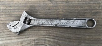

16,744
Here is a series of pictures that I was saving for the Crescent thread but I’ll post them here. Like Lugz, if a tool is seriously rusted I usually leave them behind but my daughter reported that my 3 yr old granddaughter had found a crescent wrench partially buried in their front yard. I volunteered to clean it up for her before I saw it. I was tempted to pitch it but I didn’t want to disappoint her so I worked on it a little every day for over a week. Multiple evaporust baths were involved. It will never be like new again but at least it opens and closes and she’s happy with it.
-Don71DAC54C-7163-4684-9D64-522F9454B856.jpgE25B0C4F-2755-4D18-9E33-7BE85357DB3F.jpg9C186475-9D9A-4B7D-86AB-31287A34859A.jpg15A3CE20-64A5-4AF7-B806-04C841A1D8E3.jpg90A19CB4-42C0-4F62-A0EF-1AC301F06E14.jpgDD402302-DAA9-4335-857D-50180289E808.jpg158E6D2C-563C-445D-8654-FE647FA66004.jpg
