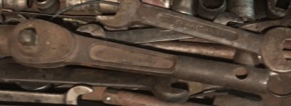

One of the tools that Shiftless picked up for me on Saturday was this rusty New Britain 1/2” drive ratchet. An evaporust bath and selective polishing with the 3M disk and it now looks like this.
-DonB3EC1156-247B-4459-87E5-BF2C82D33757.jpeg2BB0B00B-D0A8-4B22-898D-256ECC69D962.jpg8A901FCF-4372-42A8-83F6-194541C7E9C6.jpgCE5A5898-1BA8-4ED4-87AF-EBA8679DD9F4.jpg

nice work on the ratchet. do you also take out the innards and clean up and regrease or were they ok even though it was a rusted mess outside?
16,744
I took it all apart before the evaporust treatment and reassembled it after cleaning all of the individual pieces. Even though I have a few of those ratchets, it was the first one I had taken apart. They are usually pretty bulletproof. Here are the ones in my WW2 toolsets and my double knurl 1/2” drive socket set.

Here is another project that combined the 3M 220 wheel and evaporust. I buffed first and then did the evaporust, just as an experiment. It seemed to work out okay. After the pictures it got a rubdown with Fluid Film.

Looks good Jeep,
Have to say its a little of a trial and error for each item, a lot depends on the rust amount and type of finish and hardness of finish.
The Evaporust works much better when knocking the big crud of rust off item first that would take a long time in evaporust to dissolve; also degreasing the items as much a possible before evaporust as the grease will become a stop barrier for the evaporust to get through.
If you have big amounts of crud and rust, then a soft thin wire wheel or brass brush works best, just don't push in hard and try to feather items into the corner side of the wire wheel to help avoid pitting in item from wire needles hitting dead on. I also rinse the the items in rubbing alcohol right after evaporust to remove any gunk left that will effect the Radial bristle brush wheel.
Today, I did a bunch of items and several Starrett surface gauges, they were badly rusted and needed a bath. I hate doing it as I love the Bluing/Browning on the finish of these when in nice shape but there's no way to keep it and clean them up to be used again; that beautiful finish comes off so easily, even just using a de-greaser and rubbing alcohol will remove it. I then lap the bottoms to 6 microns.
This is another project I'm working on, long way to go but as photo above in post #192 shows, they're coming out pretty nice but still waiting for the arbors to arrive to test runout to determine if they're still good or not.
