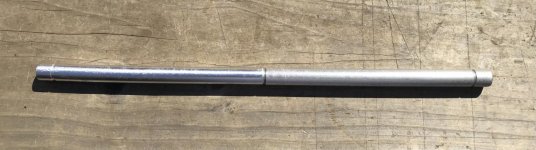

Shift: I bet there are a lot of inexpensive options to extend your arbor on your little motor. the key is trying to keep the debris and dust and gunk out of the motor so longer arms might help.
one of the machinist was making longer extensions for the block guys, but they cost about as much as the grinders so he didn't make or sell many.
so if you can somehow find or make a 4-6 inch extension for your wheel and maybe make some sort of shield over the motor you might have yourself a nice little tool to shine up more old steel.
