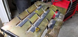

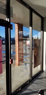

SWMBO opened a new office and asked me to figure out how to install some fancy acrylic shelves that hang from a pair of guy wires. First pic is the finished product to give you the idea. The ceiling is drop tile and the floor is concrete. After ruminating a while and noticing the aluminum window frame already had screw holes in it from other equipment, I decided to weld up a set of brackets to mount to the frame. The brackets had to project outward for the shelves to clear the glass and be strong enough to hold tension on the guy wires. I ended up using 1-1/2" angle iron and welding on 3/4" solid rod cut on two forty fives. I then cut a groove and a notch in the end of each rod to hold the screw and nut for each cable anchor. The angle iron is drilled for two butterfly anchor screws and sprayed with Rustoleum hammered brown. It worked out pretty slick, I think.20bef7b6b533041e6678e3140f655b89.jpg5c45acc45ce553d2866e5c61a24cd78c.jpgff25ee876e8279071b1520b25fd07a2f.jpg06ca163a673458080c65afdafc358e43.jpg84b9d9fbe17b6e31d0f3c979b02e2128.jpg
