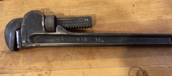

JoCo:
When you get a chance, would you please remove the floating jaws from your Craftsman pipe wrenches, put the floating jaws and adjusting nuts aside, and snap a photo of the inside of the channel in the static jaw handle housing in such a way as to capture the entire spring steel guide that is inserted there.
If the guide looks the same on all three wrenches, I only need one photo. If the guides are different, please take a photo of each one that is distinct.

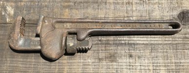

Don,
Would you please do the same for any Erie pipe wrenches you have that are 30's or 40's vintage?
Secondarily, if you have older than wartime Ridge pipe wrenches (with the trapezoidal swash plate), would you please do the same for those?
Why?
Since we can't seem to find patents for Nye or Erie, and we can't find any external distinctions between Nye, Erie, Craftsman, and Ridge, other than the shape of the plate extending from the detachable jaw pins upwards along the edge of the static jaw on the housing, I am hoping an examination of the channel guides will be insightful in one way or another.
Not many people pay attention to these guides, and they weren't necessary to figure out how to date Ridge pipe wrenches on my 'Dating Ridge pipe wrenches thread', but Ridge patents in 1929, 1932, 1933, and 1940 introduced a new and distinct design for the guide first included in the 1925 patent. They were obviously trying to perfect a way to stabilize the floating jaw. In 1954, believe it or not, they went back to the 1929 design for the guide, re-using the very same figure! It's not known if any of them were actually produced.
The internal guides in all my wartime Ridge pipe wrenches look like this...
...which is the 1929 design.
Basically, it's a spring steel strap wrapping around three walls of the channel. There is a hidden coil-spring in a recess inside the top of the hump putting pressure on it and those three tongues on the bottom.
I am very curious to see what the guides in the Craftsman and Erie wrenches look like.

Lugz,
I know of no way to positively date the Erie wrenches. Going with the Ridgid indicators, my black Erie has the wartime shaped jaw and solid knurled adjuster and the red Erie has the different shaped jaw and the split knurled adjuster. Either way the jaw spring is totally different than the Ridgid. They both consist of a coil spring and a spring steel clip to push against the jaw.
The early and wartime Ridgid clips are quite similar to one another. Here are pictures. I’ll show the Erie wrenches first.

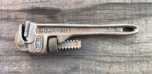

16,551
Just in case you think that will positively ID the Craftsman OE, here is another maker that uses the Erie spring method. I noticed that the method of securing the replaceable lower jaw is different, but this is only a 6” wrench.

30,580
Thanks, Don. That separates Erie from Ridge. (Because that doesn't match any of the many Ridge patented guides.) I'll be eager to see what the Craftsman guide looks like.

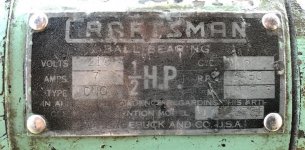

I picked up this Craftsman 1/2 H.P. grinder from the flea last weekend. It didn't work so I took a chance at $25. Dunno why, but these things are BUILT, so I had high hopes.
I get into it today and notice that the power cord is all kinds of old and crumbly. So, let's start there... Well, one replacement power cord and it was back in business. Love it when it's a simple fix!
Probably could use a repaint. The original royal blue color can still be seen under the base of the grinder.
Looks like this model was made from about 1934 through the war years. Model number 115.6332 makes this a Packard Electric Co. sourced motor.

I would love to find one of the old Long C grinders. I don't think that many were sold on the left coast before or during the war...
bmwrd0
Nov 7, 2010
5,475
Beaver Fever Oregon
I have one, that I picked up in Berkeley years ago. And yes, this thing is a breast!
I restored it, going off of the colors under the base. Not perfect, but it look not unlike yours at the time, and it also had a crumbling power cord.
Username already in use
Sep 4, 2015
2,177
Shipping is probably prohibitive, but if you ever make it to Ohio... ;)
Wow. Dude you been kinda quiet and absent but you came back with a vengeance!
Haha! Thanks, Lugz. Lots of demands on my time recently. Plus a well needed vacation! It's getting warmer with every passing weekend, so the local fleas should be in full swing soon.
Damn. Nice grinder! I'm insanely jealous
Thanks! I'm super happy that it was such and easy fix.
I have one, that I picked up in Berkeley years ago. And yes, this thing is a beast!
Yours looks great! That color looks about spot on to what's on the underside of mine. What color did you use?
