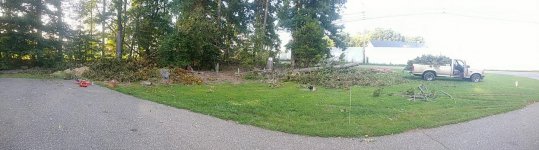

My understanding was that the holdup was due mostly to the excavator. Wet ground means limited work, and limited work for months on end means delays. These delays meant that we had to wait a long time for anything to take place.
The first action, was some tree work. I asked them to leave the trees in larger pieces so that I could get it milled into some dimensional lumber for future projects.
This also meant that they did not haul away most of the debris (or perhaps any) from the tops. Lots on cleanup to do……but I don’t mind, I really do enjoy breaking out the Stihl.
But in the end, here is pile that I have to work with, should be able to get a couple hundred board feet of Oak and Walnut. Mostly oak, one or two walnut.
After the excavator came, he piled everything together, so here is a current picture of my lumber pile.

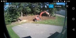

Exciting times! Although it took forever for them to start work, I am very impressed with the speed that they have been able to work. They did all of the excavation over 3 days, but they were by no means full days.
They started with making everything flat(ish). And they hauled a bunch of the tree debris away, even some that was just laying around in the woods (yay!).
This is where we ran into some issues. The excavator determined that our ground was too soft for the interior (the footers were okay, they would be on solid soil). Therefore, we were encouraged to clear out the soil, down to 24”, and replace it with compactible soil. Turns out that they needed to dig down nearly 6 feet to get rid of the root ball from one of the large trees! But, after Day 2 of excavation, they were able to dig everything out, and get it ½ way filled with the new soil.
The new (expensive) dirt is much harder, although I am sure if they ran this thing over anything it would be compacted……
