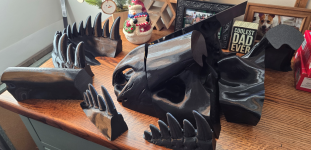

It came out well!

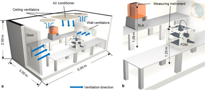

I would suggest reading this test (one of the ones I linked previously)
It was done using Ultimaker S5's. Those are open printers. They setup a print room with limited ventilation (a situation similar to my setup) and found:
The measurements of formaldehyde, PM10, and PM2.5 were conducted using test–retest with the PLA, ABS, and TPU of the ME and the Clear, Dental LT, and Flexible 80A of the VP. In tests, the formaldehyde concentration in the 3DP workspace using most ME and VP materials exceeded the WHO recommendation of 100.00 µg/m3 for indoor formaldehyde14.
Conclusion
During 3DP without ventilation, formaldehyde was detected in all materials and it exceeded the international standard. However, it was confirmed that the formaldehyde concentration significantly decreased with ventilation performed during test–retest validation. Therefore, installing and operating the ventilation systems in a facility equipped with 3D printers is recommended.
ME is material extrusion (ie FDM printers like the Ender 3 etc). In some of the other studies they were using printers that already had built in air filtration. This study shows a relatively open printer. It basically shows that ventilation is important and that with ventilation things shouldn't be an issue. When setup in a work shop or someplace outside of our living space I don't see these printers as an issue. However, in a living space is something that should be done with awareness. That is why I've mentioned this.
Cruzan80
Jul 22, 2015
4,493
Denver, CO
The weird part though is that when you look at the actual tables and charts, the resin printers are over the 100 threshold, and almost none of the ME filaments are (TPU being an exception).
The room they are measuring is 9x15, with no other ventilation (closed doors, etc). I would posit that is trying to find an ideal test case, not what most people have going on. The standard deviations for formaldehyde were also +- 50% of the values in some cases, meaning the number could be varying wildly from the average (especially ckmpardd to Pm2.5 and Pm10). The test vs retest for that with ABS was barely inside the min/max ranges as well.
As has been stated above, how many people are printing ABS or other exotic filaments in a small closed room, without any real airflow, on an open bed printer? The report also says it dissapates quickly, especially once any other ventilation occurs.
Not saying that it isn't research, just that it certainly isn't a "smoking gun".
Regardless, I run anything besides PLA thru an enclosed printer with filtration built in.

Also working on a 1/2 scale T-Rex skull - not even half way there yet...

Cool projects and stories!
As far as the safety concerns, and I can only speak anecdotally, I'd vent the machine if possible. I once worked sales for a large plastic fabrication shop that worked with all types of sheet and rod. The shop always gave me a headache if I was in there too long; I don't think there was any ventilation. I was friends with a lot of the employees so when I went back to buy some parts about six years after I left, I was stunned to find how many had died, it was around 12 out of 40 and those 12 worked in the shop, or next to it, in an office. Real nasty deaths like stomach and brain cancer, age wasn't a factor, most were between 40-60.
Sorry to be a downer but there's lots of info on venting the machines online, keep up the great posts.
