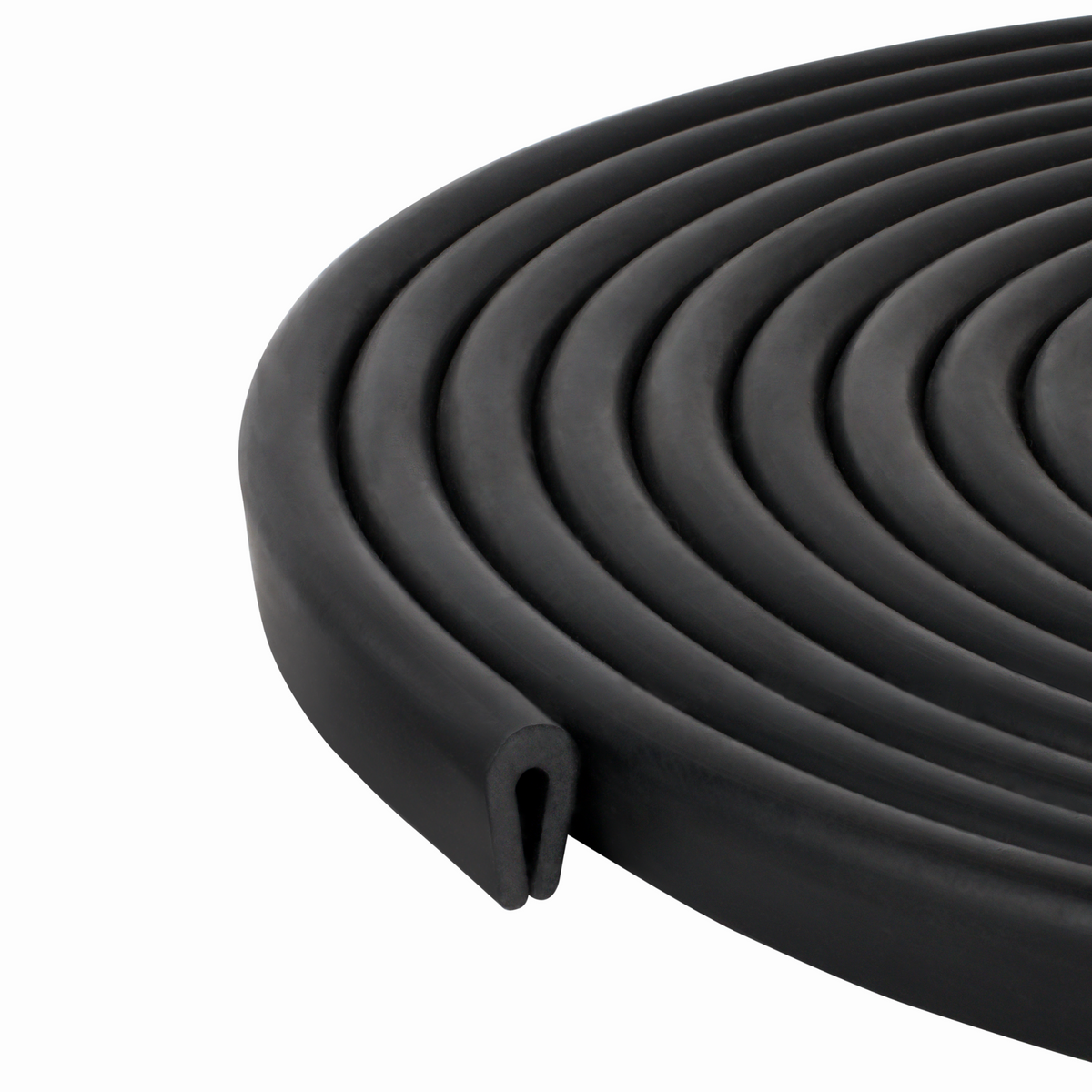

Use some of this to trim the edges of the cupholders?

E6000 or 3M 5200?
The 3M 5200 looks like some serious stuff. The river is floating a tube to my house. It looks like it will stick any two things together in harsh environments. What's your experience with using it? Does it dry up in the tube after opened or harden at the tip?
kaymccampbell
Feb 27, 2015
29,812
Upstate New York
It's not something I stock. It does expire and there's dates on the tubes. Be wary.
I've used it to stick things on boats together. Like gluing down a fishing bridge or a center console or a hatch. I've seen it used to attach an ultra high flotation motor pod to the back of a speedboat. Strong, vibration, water and fuel resistant. I believe it's moisture cure. There is a debonder. I forget what it is, but it's something to keep in mind.
It takes a good area to be structural. Like a 3 inch band around the perimeter of what you're gluing. Both surfaces want to be clean and wax free. It's got a stupid open time like 24+ hours and a cure time about a week. Structural time is longer. I leave it for at least a couple weeks.
It wants warmth and humidity for optimal results. If you do it in a cold shop in winter, it'll wait to June to cure. Any time I've used it, it has been for a job, so I used it all. The only time I tried to save some it went off. But then it did sit for several months in an opened tube, so...
