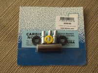

Yesterday the Tie Rod for my Honda 2013 Lawn Tractor arrived in the mail.
The original Flange Nuts seem to be some sort of Top Lock type nut. I think I can reuse them but I'm going to temporarily use a couple of regular 3/8"-24 nuts to install the Tie Rod.
...and that's what I did. When I finish the pickup's Water Pump installation I will pull the Lawn Tractor over the "Tornado Shelter" and replace the Main Drive Belt. When I glanced through the Shop Manual it indicated I would need to unfasten the forward end of each Tie Rod as a part of the Belt Change Procedure. At the moment that doesn't make sense to me.
Still, by putting those regular nuts on the new Tie Rod, the potential to damage the male threads of the Tie Rod when I replace the Main Drive Belt should be eliminated.

The Carbide Nozzle kit I had ordered earlier in the week for the Blasting Cabinet arrived a day early.
The other item I ordered was a Small Parts Basket. I was surprised and pleased to see my initials drilled into the bottom of the basket. "What a nice little touch", I thought.
...and then I realized that SB probably stood for Skat Blast, the name of the company that manufactures the Blasting Cabinet I have.
HA!
I installed the new Nozzle .
