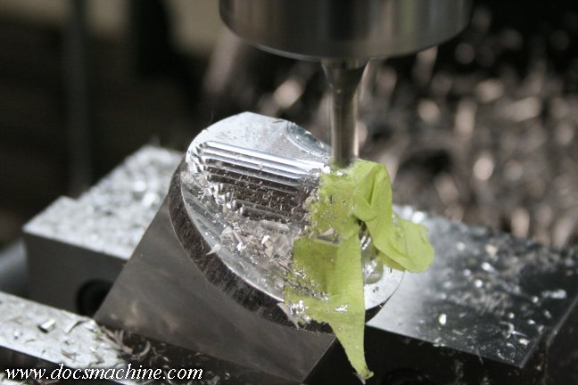

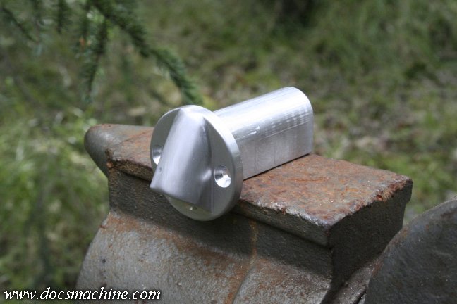

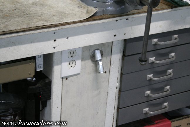

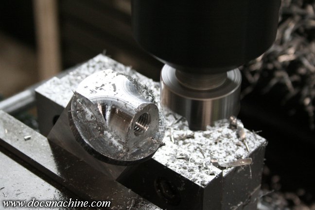

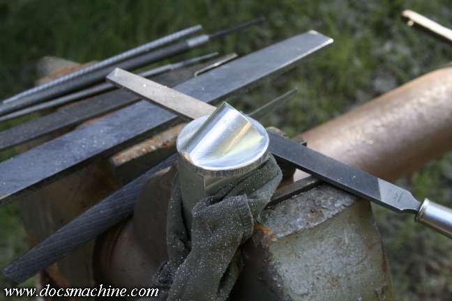

DocsMachine
Sep 16, 2006
1,948
This 3-1/2" chunk of 2" round aluminum...
Got turned into this happy little fellow...
Which, when connected to my shop air system, attaches to my workbench like so:
It points down at 60 degrees rather than 45 so it doesn't stick out as much, but is still easy to access unlike a straight-down 90 degree fitting. Makes for a nice and handy connection right there by my vise.
Doc.

DocsMachine
Sep 16, 2006
1,948
Patience? I only have about five hours, spread over two days, into that fitting. :D
Doc.
