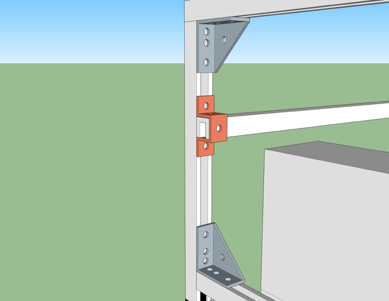

My gut tells me that a vertical post placed at mid span would reduce your racking (parallelogram) issue. The cabinet will help if it is secured to the frame well enough but the "real strength" in that case would come from closing off a section or more of cabinet. i.e. Like sheathing on a house. You probably are opposed to that but that plane of material doesn't need to take up all the bay's in the cabinet & it could be installed toward the middle or say 1/3 the depth of the table.

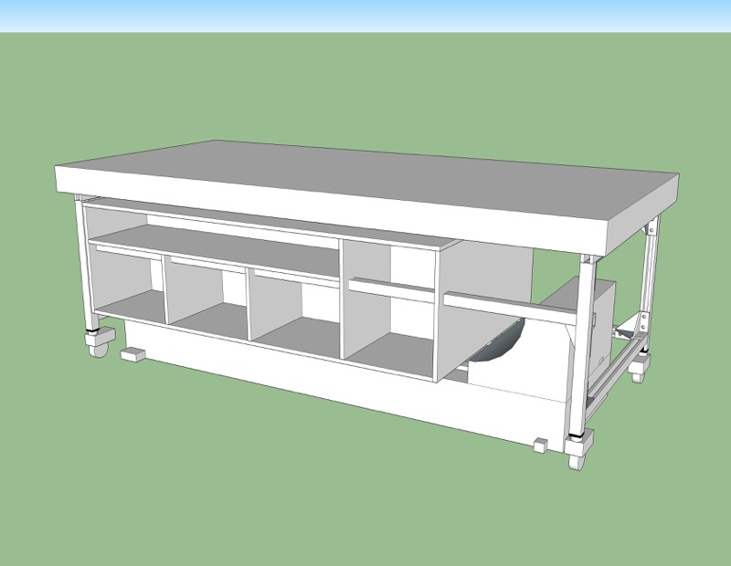

I think it would depend on how much the post could hinge where it was attached. Parallelograms are great in that all the edges pinned across the surfaces that are in shear will move in unison. So with proper angle brackets (or better, angle brackets with gussets) it would add additional resistance to the hinging effect that would improve the overall structure. In practice, even a very well-tightened 1/2" bolt and swivel nut combo (the usual strut channel fastener) will have some give to it when you apply leverage from the far end of the strut.
All that said, I might find it convenient to place just such a vertical connection between the top and bottom stretchers on the left, just so I'll have something additional to bolt the cabinet to. And the angle brackets that I will inevitably use there will definitely help the overall structure.
Yes, and in most situations I would let the cabinet be part of the overall picture. But at this point, I feel compelled to prove that the strut channel frame can be made sufficiently rigid on its own. So using the cabinet would be cheating.
The cabinet design includes a plywood panel running vertically through the middle. This gives me a left side and right side set of cubbies, but it also makes the cabinet into a giant I-beam. Okay, it's made of plywood. But I believe it will be extremely rigid and resist any attempt at parallelogramification. It's essentially the same design I used on my Sortimo cabinet, and that thing does not change shape.

the cabinet is open on both sides, right? but there's a divider down the middle-ish?
If you anchor the cabinet to the top that divider will also serve to triangulate the frame from doing the parallagram thing.
It's like a lotus 7, steel space frame to provide all the hard mounting points with a stressed skin attached to give rigidity.
Yes. The middle divider is offset to one side a bit, but it's basically middle-ish.
Oh, absolutely agreed. And again, in any other context, I'd be satisfied with that.
But dammit, I'm going to make this frame rigid, all by itself.
There are many obvious ways that my workbench differs from a lotus 7. My workbench will be much sexier, for instance. But the most relevant and objective way they differ is that weight is a disadvantage for a lotus 7, and an advantage for my workbench. Thus, I'm not concerned about adding more metal to the frame. It's not very expensive, in the grand scheme of things, and the added mass will improve the bench. Or, at least, until the casters fail.

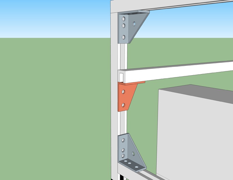

the flex is not because it's strut or because it's bolted. It's because there are no diagonals other than the small gussets in the corner. but adding cross braces goes against having working cabinet space. if you could build a strut channel truss between the long span on the right and the top of the frame, bet that would do it.
Here's some inspiration:
Modern Jess
Jan 2, 2011
1,362
Bay Area, California
The bolted connectors really do move with enough leverage. I've watched them. And then it stays in that position until I un-parallelogramify it. The struts aren't bending or flexing, the connections are slipping. At least, that's the current weak link.
Agreed that bracing is the answer, though it does interfere with the design goals. But that's what engineers do -- find creative compromises that give as much weight to the stated objective as possible. And when that doesn't work, we throw out the design and start over.
That said, I'm not 100% clear I follow where you're proposing I add bracing. You might have to resort to MS Paint. ;)

Got it. And agreed that would stiffen it. But...
As my motto is "make every inch count", I had a plan for that space. I'll have to think hard about whether it's worth sacrificing that storage.
A solid plate along that space would have the same effect. Like siding on a building.
You could still attach a bar to that plate for things like an angle grinder rack or pry bar storage.

figured that was the case. so, move the truss to the centerline so it does not get in the way of accessing the storage. could also use floor anchors to mount the frame to the top, to take advantage of the stiffness of the torsion box.
Modern Jess
Jan 2, 2011
1,362
That's an interesting idea!
Can you go into more detail there? I am counting on the torsion box for some of the eventual stability / rigidity, but I'm not sure what kind of floor anchors you had in mind, or how that would be an improvement over screws.

My friend Patrick (OopsClunkThud on this forum and elsewhere) dropped by today, and we talked over some possibilities for stiffening and strengthening the frame. He had some good ideas, and came up with an optimization that saved me a lot of unnecessary drilling through steel. So much thanks for that, Patrick!
I don't know if it will be necessary to go to all the lengths that we talked about, though. After he left, I swapped out one of the existing brackets for a new one that was just delivered yesterday. It wasn't my complete order of brackets (the company I'm ordering from is kind of driving me up the wall with their random shipments) but it was still one I could use.
Specifically, I swapped out this bracket (shown in a kind of orange / burnt sienna):
With this one:
And what a difference a single bracket makes! This single bracket took out most of the tendency for the frame to parallelogram. Coupled with the cabinet that's going to be inside the frame (and bolted at many places), this would probably be enough.
But!
I'm still going to go a little farther. Because I have to. And I want to. And maybe I'm a bit unhinged at this point.
If the rest of my order of brackets ever gets here, I'm still going to mount the top rail across the right-hand side. Once I do this, I'm expecting that it will be finally be rigid enough for me to wrap up the frame and move on to mounting the torsion box top and building the cabinet.
