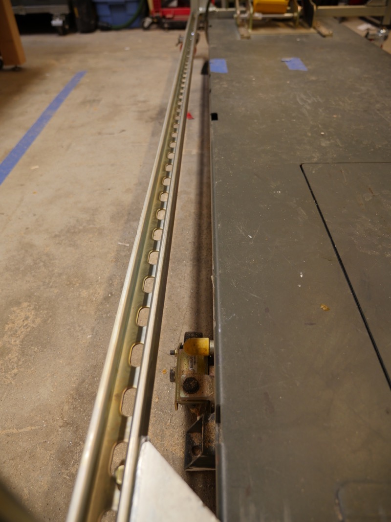

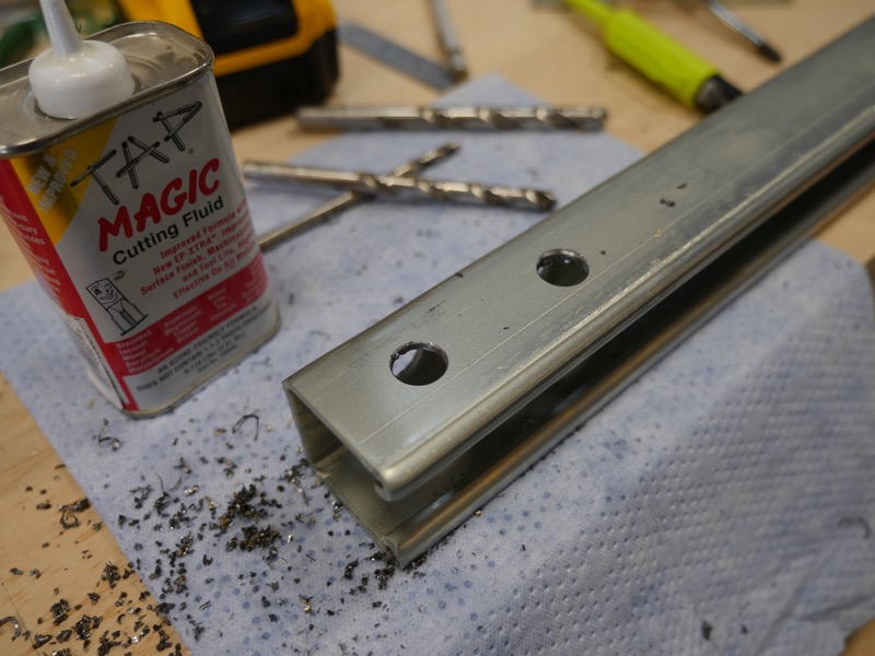

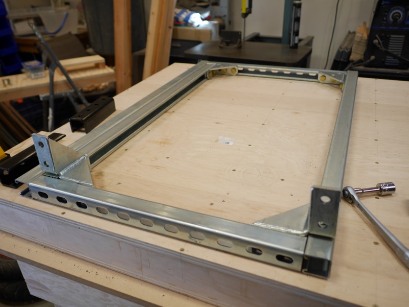

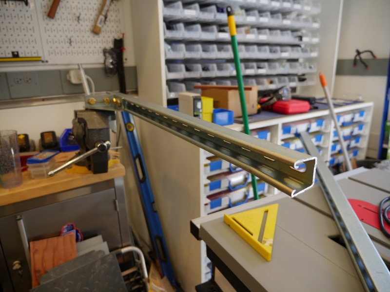

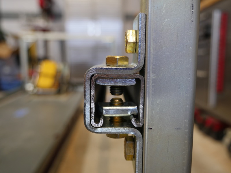

While I'm waiting for more brackets to arrive (which, I'll admit, is getting repetitive and y'all are probably getting tired of hearing about it) I am making progress on other aspects of the frame -- tweaks, mostly.
In my conversation with Patrick yesterday, I was pointing out that the lower stretcher on the right-hand side wasn't oriented in the strongest plane for beam loading, due to the way the brackets had to fit together. Patrick protested that it didn't matter, that the cabinet would be an evenly distributed load, and was probably more than capable of supporting the weight of the cabinet. He demonstrated this by (and I swear I am not making this up) laying down on the strut channel and balancing there. Of course, he only weighs about 100 pounds, so that doesn't tell us anything.
I had a plan for sistering another piece of strut to it, and it involved drilling about 10 holes into the existing piece of channel. He asked why I couldn't just re-orient the channel so that the stronger plane was oriented the way I needed it to be, and I pointed out the way the bracket is designed. He pointed out that I could just drill four holes in the side of the strut, rather than ten, to which I didn't have anything to say except "derp".
So today I got busy on his (admittedly, excellent) suggestion.
Drilling some holes:
This member is now mounted to the bracket in a nonstandard fashion:
Which gives me a stronger orientation for supporting the cabinet:

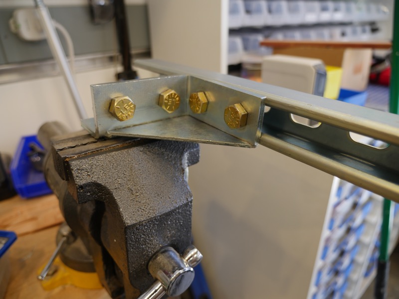

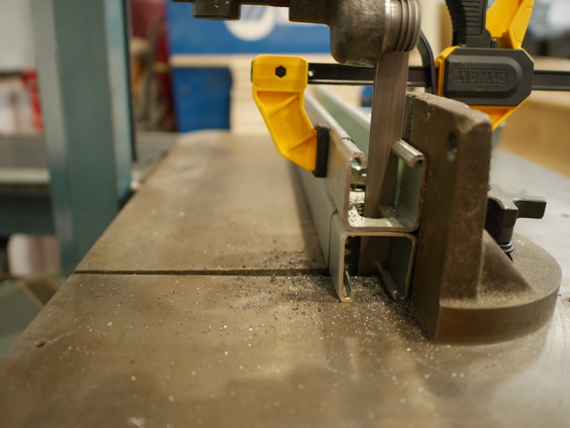

The next thing on the docket was to figure out why some of the pieces of strut don't quite align right. Getting everything squared is unexpectedly fiddly with strut channel -- you'd think it would all just end up square when bolted together, right? Okay, probably not. But still, things were a bit wonky in places.
Turns out that two of the brackets weren't actually square. Fortunately, it was in a direction without gussets, and after thinking about how to bend them a bit, I came up with this:
Attached to this lever, I was able to get it approximately square. And yes, it deformed the strut channel a bit. So be it.
Finally, I've been unhappy with the one remaining U-bracket that secures one of the long stretchers. It only had a single nut/bolt holding the stretcher in place, and that acted more as a hinge than a securely-fastened attachment point. I really need that bracket there, because the cabinet would interfered with just about any other method that I can think of to attach that piece of channel to that leg.
Fortunately, though, the U-bracket has holes for securing a piece of channel in any of three orientations, and I was lucky enough to have one of the slots on the back of the strut channel line up nicely with one of the unused holes. I also had a 1/2"-13 square nut meant for just such an occasion, which I put to use.
This one little tweak was surprisingly effective at further reducing the ability for that piece of channel to hinge at that bracket. And thus, the frame got a bit better.

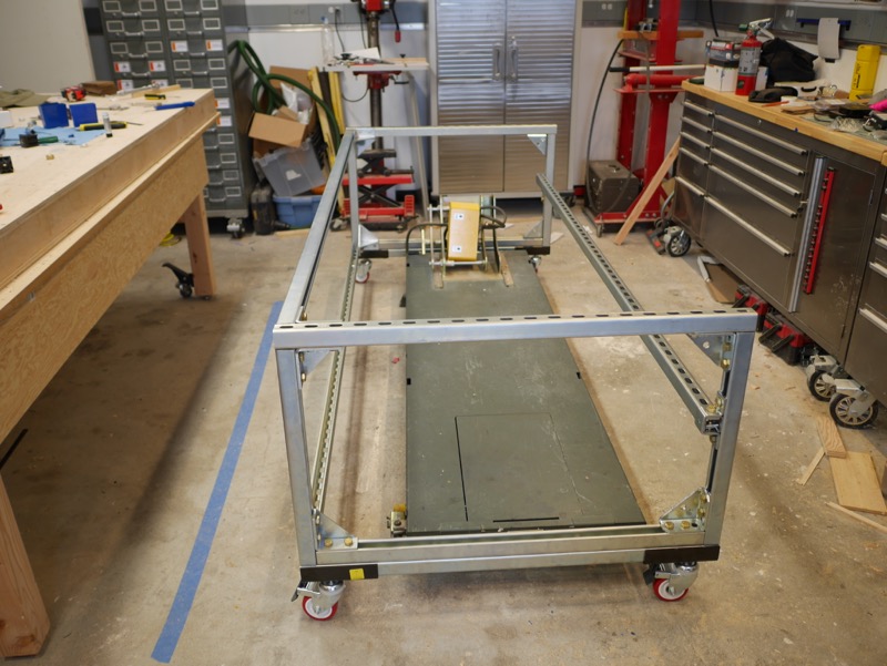

All these little tweaks, taken together, have resulted in a frame that is really very, very rigid. I can certainly flex it in certain places, but it now takes some effort. I could almost just put the torsion box top on and call it a day.
Almost.

There are many obvious ways that my workbench differs from a lotus 7. My workbench will be much sexier, for instance. But the most relevant and objective way they differ is that weight is a disadvantage for a lotus 7, and an advantage for my workbench. Thus, I'm not concerned about adding more metal to the frame. It's not very expensive, in the grand scheme of things, and the added mass will improve the bench. Or, at least, until the casters fail.
:lol_hitti **** is in the eye of the beholder... but, I'm pretty sure the workbench frame will not be as quick as a 7! :D
Your latest mods to the strut mounting are very nice. I can imagine that they are a big improvement! At first I thought that your storage would be accessible from only 1 side, but based on your comments, is it correct that you plan on accessibility to storage from both sides? If you do not plan to store stuff that is longer (roughly) than half the width of the table, tying the storage boxes to a unistrut trellis down the (near) middle should make it uber strong.
I'm guessing that using the end (or ends) of the storage box(es) to skin the ends of the frame might also help.
Again, nice (and interesting) improvements!

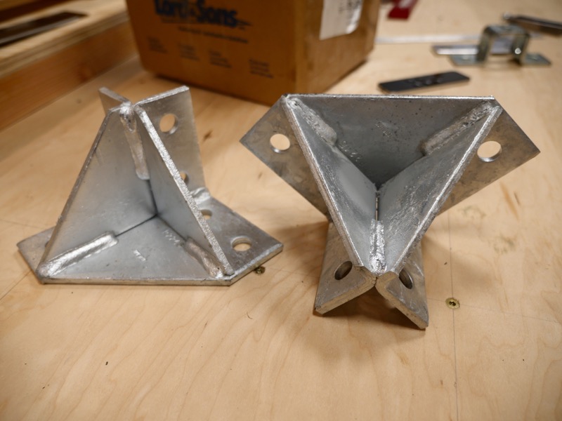

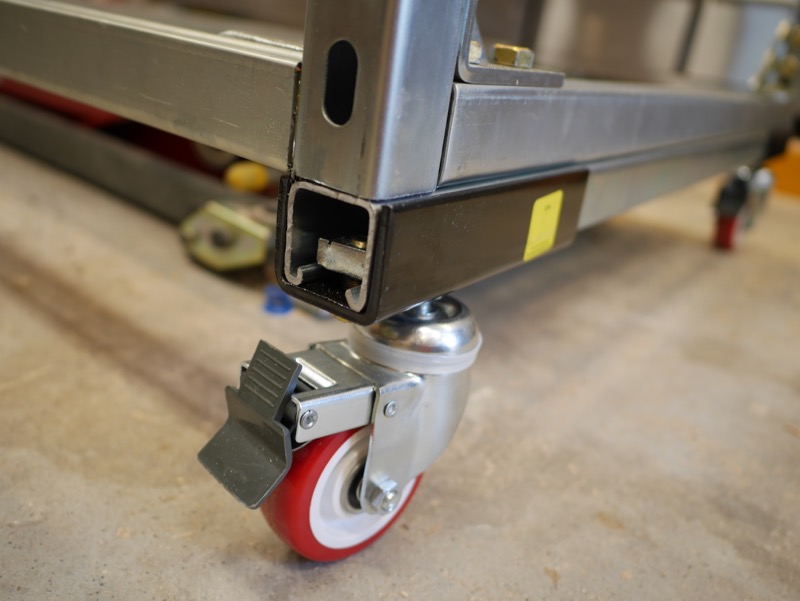

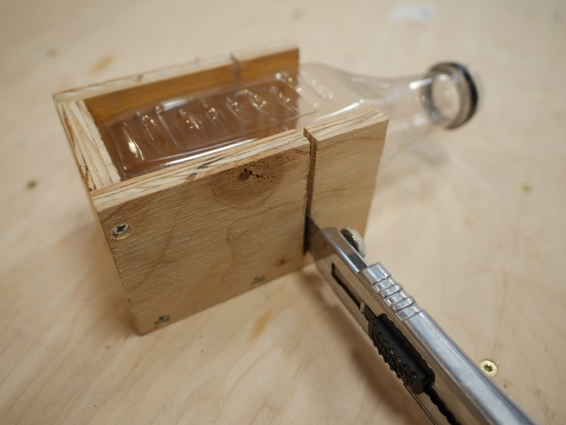

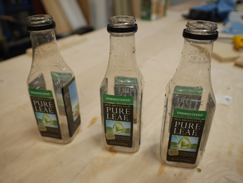

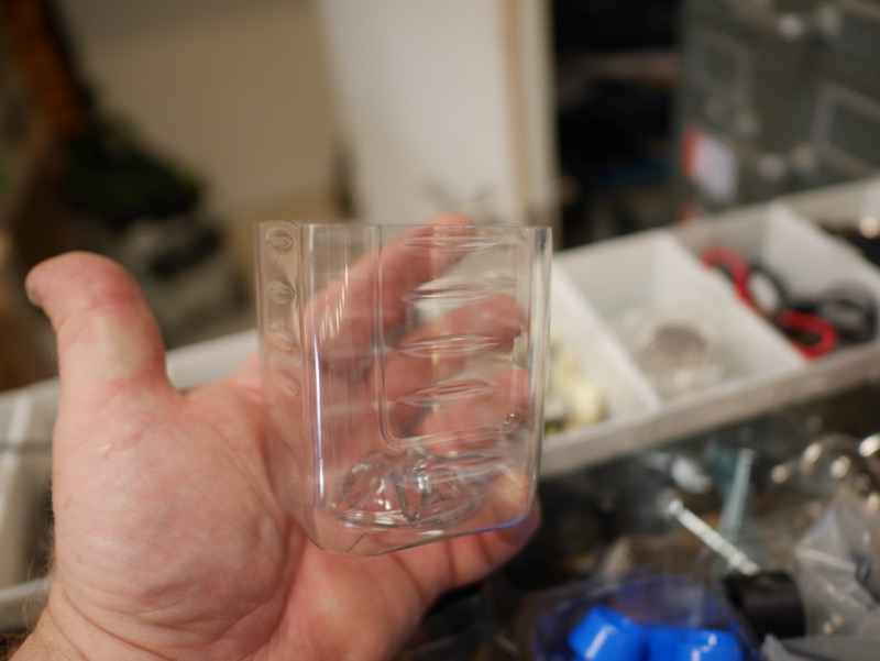

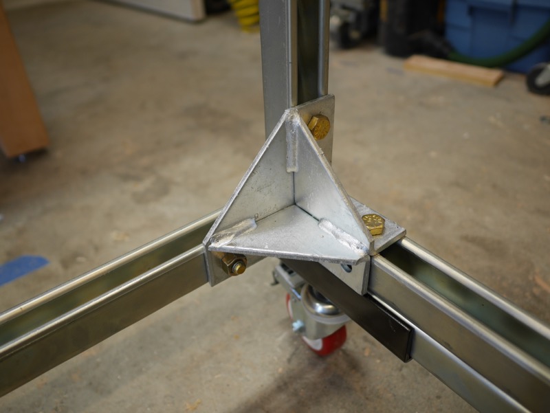

These monsters finally arrived. I'm not super happy with the galvanized coating on these, but they will no doubt improve the rigidity of the frame well past the point of anything reasonable.

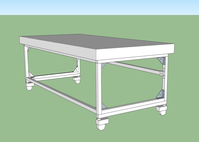

Which brings me to my next topic. As the frame has become more rigid, I've become increasingly aware of the fact that my brilliant idea for mounting the casters is not cutting it. The culprit is the tube-end inserts:
They're not really made for strut channel, but they fit. And if this was a shelf with leveling feet, completely stationary, with only column loading to worry about, they'd probably be fine. Casters, however, are neither stationary nor strictly column-like, since they have an offset to allow them to swivel properly. This results in some undesirable effects in strut channel that would probably be no big deal in square tube -- the force can make the ends of the channel deform a bit, which allows the threaded insert to wiggle, which allows the caster to angle a bit more, which just exacerbates the problem. It's a vicious cycle, and I can see where the cycle ends.
So let's call the tube-end inserts a failure. Or a learning experience. Moving on.

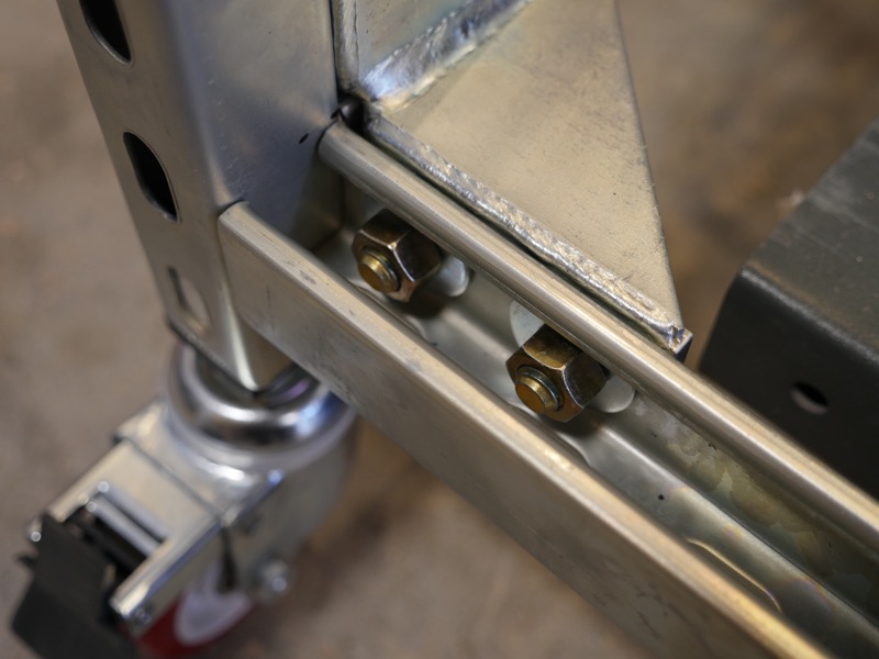

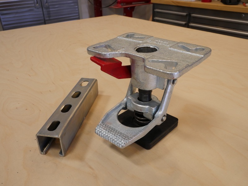

While I have in fact entertained a more radical redesign using almost all the same parts in a different configuration, I think I'm going to try to keep it simple for a change. The simplest fix for this that I can think of is to shorten the legs and mount another piece of strut back-to-back below the existing short stretchers. This gives me the spacing I need to mount the casters I already have, using some standard strut channel hardware. Everything else remains exactly the same.
Here's what that looks like:
This still leaves the ends of the channel -- where the casters mount -- slightly vulnerable. The channel nut that will hold the caster stem in place will also tend to hold the sides of the channel together, reducing the tendency of the channel to flare out right at the bottom corner. Still, I'd like to make sure that there's plenty of reinforcement there, so rather than the thin, flat plate that is shown in the design above, I'll probably use some of these, bolted along the length of that new piece of strut channel:
I'll put the caster stem through one of the holes and then bolt all the others to the channel. I think that will do it.
Oh, and some good news: I have almost everything I need to do this new modified design. The only pieces I don't have I can get from McMaster, which will be shipping them this morning.

Jess,
If I understand you correctly, the issue with the inserts is that they deform the shape of the channel, and that leads to poor fit, correct? Could you either make/find/buy some square collars that would fit around the strut? This would prevent the deformation of the open side of the strut and almost make it more like a square tube.
-Adrian
Modern Jess
Jan 2, 2011
1,362
Bay Area, California
That's correct.
I considered it. Fastening the collar to the strut becomes the main problem there. The insert itself prevents any standard channel nut from being used. If I had longer leg protrusions below the bottom rails, I could fasten a collar up higher that would wrap around the leg, but that would interfere with the bottom rails, which have to be in that fixed location due to all the other clearances and design requirements of the frame.
I also considered having my machinist buddy mill some custom inserts out of steel that would allow for that collar to be fastened there. I think this additional-channel approach is simpler, though, and ultimately more robust. I will add a couple pieces of channel (that I already have) and cut down the legs a bit. A few more pieces of hardware are required, but nothing exotic.
Simples.

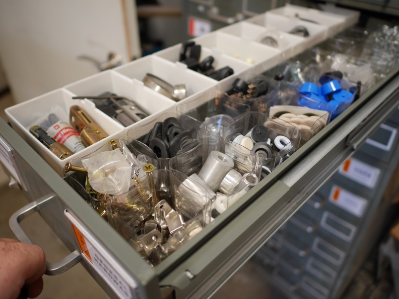

Lest you all think that I overthink everything in my shop, some of my solutions are actually very simple.
As an example, let's look at a staple of any workshop: hardware organization. Sure, I have a fancy Sortimo system, but that's good for sets of stuff. I have many bits of hardware that defy categorization, and together they make up a couple of drawers in one of my salvaged card file cabinets.
Okay, I might have overdone it a bit with the drop-in label. It's actually a vinyl ID card, and I have a printer that prints them. Actually, it prints CDs, but I spent some time searching and found a replacement tray that lets you print vinyl ID cards instead. Okay, it wasn't actually for my model of printer. Nobody made that at the time. So I modified it. Just had to weld a bit of plastic with my plastic welder, and add some reflective markers that the printer reads to know where the tray is positioned.
But never mind all that, this is the drawer I'm talking about:

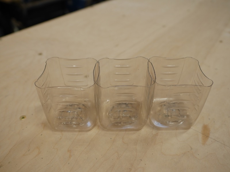

Inside, it's just an ordinary drawer full of recycled bins with lots of bits and bobs:
I use these, which happen to fit perfectly side-by-side in a 5" wide drawer.
They're the bottom half of a bottle of Pure Leaf tea:

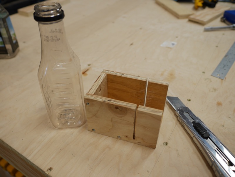

To get them consistently cut, I made this jig. Hmmm. Maybe I'm not making a very good case for myself.
You just put the bottle in -- it's a snug fit -- and then use a utility knife to cut along the slots:
Voila:
Nice, consistently cut bins that fit perfectly in a properly-labeled and immaculately organized drawer. What could be simpler?
Okay, you guys might have a point. Maybe I'm prone to overdoing things after all. Is there a support group for this disorder?

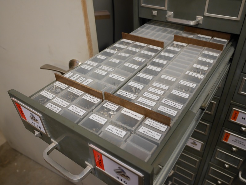

How do you label those drawers? I use a low rent version of your Sortimo system, but find myself putting "miscellaneous" on so many bins I can't find anything without looking through several of them.
How, as in how do I print the labels? Or how, as in how do I think up what to write on the labels? The categorization is one of the reasons I swing wildly from one extreme to another -- in order to organize something, I first have to decide how to group it with other things. "Misc" is inevitable -- you will always have random stuff that defies categorization. But I also have sections like construction screws, drywall screws, plumbing fixtures, and so on.
Here's one way to solve the "Misc" problem: if you have one of something, and you can't figure out how to group it, buy a set of all the other things like it and tell yourself you're "stocking up". :lol_hitti

Workbench Update
All the parts I was waiting for finally arrived, and we're in the middle of a long weekend. So time to do some workbench rebuilding! Of course, I needed to completely disassemble the frame in order to cut the vertical legs down to the correct size.
Here's an action shot of two legs, bolted back to back, on my handy Roll-In bandsaw:
I assembled the short sides first, since they're a little easier to handle and move around:
Then it was just a matter of connecting the two sides:
The casters are bolted to the channel through this long black U-shaped piece which fits around the channel very snugly. I also moved the caster inboard by one hole, as the end of the channel is the weakest point. The U-bracket is also bolted to the channel in two spots, in addition to the caster stem itself. I think this is now sufficiently strong:
These corner brackets -- with gussets in three planes -- are really, really beefy, and there's just no way the frame is going to parallelogram now:
I then managed to convince my wife to help me lift the torsion box -- all 260 pounds of it -- onto the frame. And here we have, at last, a mobile workbench:
So, final thoughts on this. The frame is now ridiculously rigid. It does not flex. You can, in fact, build something like this out of strut channel. Even though strut channel can twist, once you bolt something together like this in a square, the ability of the channel to twist is completely nullified.
There is one flaw, though. And it has nothing to do with the frame. Having eliminated all other sources of wibbly-wobbly in this bench, I am left with one bit of shakiness, and it's from the casters themselves. The swivels on these casters are sloppy, and there's a good deal of play in them as I shake the bench back and forth. Sigh.
I'm going to try to remedy the problem with a step-down floor lock (which, USPS willing, will arrive today). Not sure how I'll mount it to the channel yet.
And if that doesn't work, I'll have to source some better casters with stronger / tighter bearings. Which will mean rebuilding the frame again to account for the inevitably different mounting height of the casters.
Let's hope it doesn't come to that.

The floor lock that I ordered late last night on Amazon miraculously arrived this morning at about 10:00am. No, seriously.
It is quite a bit bigger than I imagined it to be, though. I ordered based on mount height, and didn't really look at the other dimensions. Wow, the thing is a monster.
That's probably for the better. The nice big foot should stabilize the table nicely.
