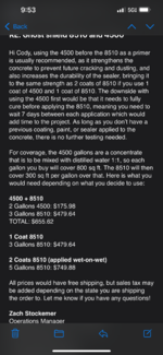

I did get it ordered and when I emailed garage flooring I got this response from them.
So, I think I will do a few test spots where I know it will be covered by benches and see which one gives me the best results.
I’m sure every concrete is different but this would ensure I get the best results for mine.

I just spoke to them as well, I did the "water test" this weekend and it beaded up, so at their recommendation, I am going to use 3gal of the 8510 and be prepared to back roll it if/where/when it puddles/pools.

So let the testing begin….
The left square has just 4500 on it, Middle square is one coat of 8510, and the right square has 2 coats of 8510.
Have to wait a week for the 4500 to cure and then I can put a coat of 8510 on it.

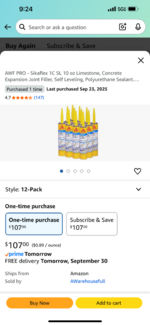

How many tubes of the sika flex did you use for your garage? I am going to order some for my project, but dont want to buy too much, that stuff is kina pricey
I have to check, it didn’t go far I will say. The tube said it can go 25 linear feet but I think I was using a tube for every 15’. I know the bubble was a waste, but hopefully it’s a sacrifice worthy of a flush floor.
Oh I just bought the 12 pack of tubes on Amazon. I got some tubes left but with all of the concrete around here, I’m sure I’ll find a use for it.

So call me impatient but I tested the joint sealant and it was stiff. So I got to work on cutting it flush.
I used this razor scraper and just cut the sealant and tape up off the concrete.
I did have one low spot and I didn’t catch it till after I scrapped it.
Overall it’s a pretty successful job!
I’ve never had a garage floor with sealed joints!
Then I was looking at the test area for the sealer. I thought, well it’s been 5 days, so why not do a small water test.
Instantly the 8510 coating had the water balled up. But the 4500 allowed the water to soak in.
But I did noticed after cleaning the water up, the 2 coats of 8510 had no visible sign of water being on it. But the one coat of 8510 had some light signs of where it looks like water soaked in.
So those are the results so far. Now it begs the question, does the 4500 really matter since the 2 coats of 8510 seems to be working? Will the 4500 just make it a better result and maybe last longer?
But at least I do know that the 4500 will allow the floor sealer to soak into the cement. All that’s stopping me from getting the drywall supply ordered and have the crew come do the job, is the floor sealer.

I did 4500 and the 8510 as well. They assured me that one flood coat was as good as 2 regular coats. So far the water I have got on it has beaded with no issue or marks.
That’s what they said in the email to me too. Some other people’s bad results makes me think they didn’t get enough of the 8510 down and so it was a waste of their time. This is based on my experience so far with the test.
madison069
Nov 5, 2010
4,375
Monroeville, PA
I'd say use the densifier, making that upper layer stronger will help when dropping heavy things. I did a densifier and had enough Ghostshield to do at least 2 coats if I remember correctly.
I know one thing. If I do the 4500, I’m still going to apply two coats of wet on wet of 8510 sealer because this will be the only time I can do this and not have to grind the surface down to redo the floor.
