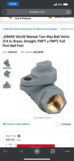

Good work:beer: The only thing I would have done differently with the gas is put a shutoff valve on the outside below the union and a pvc sleeve thru the wall.Both required by code in my neck of the woods.
So checked the code book and it says I need a shut off on all individual buildings installed outdoor.
Now to get a shut off valve.
Good thing I got a 3/4” thread cutter for black pipe!
make sure the valve has an "AGA" stamp for gas service. These Watts ones work great and are cheap. The tape will be fine for penetrating the wall as long as the inspector approves.Sorry to muddy the waters with the sleeve comment...just how it's done up here.
No worries, better to point it out to prevent headaches down the road.
I took the opportunity to talk to the local fire house chief and I asked what valve they preferred to see. He said the style with the lockout option, so I went with this one.
One good thing is I’m getting more and more familiar with the code books and finding out that it can contradict its self, so be sure to ask the inspector what’s allowed per his standard!
