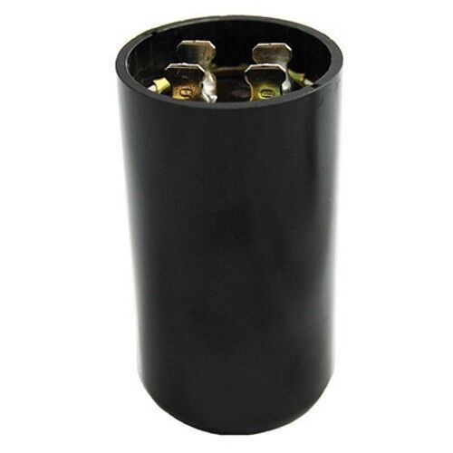

Edit: used replacement capacitor, problem persists. My meter is bad or auto-ranging not working for capacitor test. By shorting/spark test, old capacitor packs a larger punch (it's also twice the size, I'd say avoid the one listed below).
I got this on a 150 (113.12130); dual shaft 5/8 keyed and 1/2 flat, capacitor hums quite a bit so I pulled it and it tests as dead. Found 6$ replacements on ebay; slightly narrower and one farad short (link below; will report if there's issues once I get it). I believe this dates my drill press to late 60's?
I got replacement in there. Vibration persists and it's coming from the armature after all, not the cap. If I tap the motor in different areas the noise comes and goes. I tried old and new and to my surprise the older cap let out a bigger spark when I shorted to discharge which led me to believe that my meter is bad (new cap also tests as dead though they could simply be outside the meter's range). With the old cap I got consistent centrifugal switch disengagement but now it seems intermittent so maybe something's sticking?
I'd say avoid the cap I bought (edited original comment) based on spark test.
The centrifugal switch was sticking as I suspected (could hear it disengage a few seconds after a dead stop instead of @ low rpm). I don't think this motor is even broken in and the sliding mechanism was not retracting as it would if more worn. I gave the felt pads on the metal hinges a squirt of oil and lubed the sliding surfaces w/silicone lubricant. Contact cleaner on the contacts w/a piece of cardboard to rub it in followed by contact grease. Cleaned bearing bores of dry grease and gave them a squirt of lithium grease. All quiet now.
