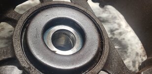

This saw has been put onto a different stand and a second "motorized speed reducing motor" was added. I assume this gives a wood configuration and a metal configuration, which is exactly what I want. This is the second motor which I don't yet know if it works.

Here it is.
Pictures help a lot.
The "M 3 8" is the date code. I'm not positive on that early syntax, but it could be December '38.
There could be several causes of a no start; bad cord/plug, bad base switch, bad centrifugal switch, bad or tripped thermal switch, bad capacitor, broken centrifugal springs, broken internal wire or burned out windings.
I can't see the base switch, but if it's there, it's likely the bakelite toggle style. Those seem to go bad often. Check continuity between the switch terminals.
I've had bad plugs on the end of the original cords. Check continuity between the blades on the plug and their ends inside the base.
The thermal switch looks to be extended out more than I would expect. Firmly push it in, it may have tripped.

So the second one has an input HP rating of 1/12, which is far below the craftsman motor. Better ways of setting up a reducer than the one shown. Not sure why they chose to do that.
As said above, motor repairs are generally in one of two categories. Fixable, like a switch, capacitor, wiring issues, etc. and Unfixable (not worth it) like burned/broken windings.
Is the CM motor the one giving you trouble, or the reducer? What is it doing (or not doing) when plugged in and turned on? Do you have a basic multimeter and know how to use it?

Haven't checked the reducer one yet. Don't really know how it was setup as it doesn't have the belts any more. The Crafstman just doesn't do anything. I can use a meter if I know what points to measure from.

I would check if any points show continuity to ground. If so, the windings are shorting to the case (bad). The windings (wires/posts) should have continuity between two different sets of points. If they don't show a link, possibly bad windings. Checking continuity of the switch and the power cord is also a good idea. All of this can get you started on the right direction.

If the motor doesn't do anything when powered up, it's one of 2 things;
1) The windings are burnt up. In this case, it's not economical to rewind a small motor like this one.
2) If it has an overload, it is tripped. Usually it's a red button. To reset it, push the red button......hard......way hard. If it resets, it'll click, you'll hear it and most likely feel it.

The main motor runs! A new cord and it runs in reverse. In forward, it tripped the breaker so I figure the switch is bad.

Congrats! Now, the next step would be figuring out why it likes Rev but not For. Is the switch built in to the base, or is external?

It pokes through a hole. It's replaceable. I'm not sure how to wire it due to the rats nest of wires in there. Not sure of the type to replace it with either.

I think you need an ON-ON switch. Specs are usually imprinted on switches.
Can you post a photo of the terminals on the bottom of the switch?
Just curious... are the switches positioned horizontally or vertically on the base?
My swag is that this is your motor in the '39 catalog.

Wow, yes that is a rats nest. And fairly obvious someone has been in there before. I see the Rev is hooked up to the capacitor (silver box in last pic), but don't see where the Forward (Left in pic, correct?) connects. This may explain why it only works in one direction. The other hole you see in the top sounds like it should have the On/Off switch.
13,264
In Rev mode, does it actually run in the correct direction? I don’t know any reason to run a bandsaw backwards, so maybe the rewiring mess is to make it run forward using the forward / reverse switch as the only switch.

I finally have my hands on the sander I've wanted since the day I saw Hoorn's pictures of his. I got it stripped down and got the motor apart. The motor is a 115.19661, with a date of 12/58. I'm not finding many mentions of this motor after many searches. It's a sleeved motor but it doesn't have the oil holes. The original manual I got with the sander says "This motor was lubricated at the factory for life under normal operating conditions". I'll bet that doesn't mean 67 years. I don't see any way to add any lubrication while I have it apart. I'm hoping one of you guys might have a suggestion about this. If nothing else I might at least get a little grease on the sleeves with a finger before I reassemble it.
I also got a little Craftsman Handbook titled "How to get the Most from Your Motor", printed in 1954. It has a lot of information about the different styles of motors used on Craftsman tools. It does mention that the sleeved motors with oil cups should ne installed horizontally, unlike the ones installed on drill presses.

Beautiful. But if you can't find oil holes, then I'd use some 20 wt oil instead of grease. Maybe try to let it soak into the bronze sleeves and then wipe off the rest.
These aren't actually bronze sleeves like you'd expect. They look like stainless. If you look closely they have 2 diagonal slots on the sealing area. I don't know if that's for cooling or if there was grease stored in there.

I currently have only one left, but have had several sleeved motors. All Century motors, all around 100 years old and they all ran flawless. Those sleeves will likely outlive you and I, whether stainless or bronze.
As for grease, you must use oil with sleeved bearings. The cutouts are part of an oil reservoir and should accept a decent amount of oil.

Thanks for what sounds like good news. I'll get some oil in there and keep my fingers crossed.
