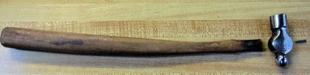

This is a 3 oz. ball pein. They are usually much heavier but even a 4 oz. seems too heavy for this use. TAP the side of the iron. It should make a soft "tink" . The adjustment can be much finer than with the lateral adjustment lever.
Here I was, minding my own business and you gave me another project. I need to fix my neglected plane iron hammer that I used for random projects. I have had this miniature ball pein hammer forever. I thought about replacing the handle with a straight one but decided I liked the curve (I also couldn't find a handle for this small a head).
The head came loose many years ago so I tightened it up with a finishing nail in the wedge slot (it worked so I hacked the nail off. Recently I destroyed the hammer's value by giving the head a little polish (the polished faces leave less noticeable marks). Today I pulled the piece of nail and removed the head. Once apart, I weighed it. It appears to be a 2 oz. Champion DeArgent of uncertain age.
Now that it's apart I decided to further degrade it's value by polishing the bottom of the head that is hard to reach before I re-assemble it.
I think I can make a small red oak wedge to fit. Then I can go back to my workbench/workshop repair. I will sleep better knowing I have a plane iron adjuster ready to go. Then I just have to remember to use it next time.
Seriously, CRSINMICH, thanks for the tip.

Bob--Good for you. I think you should shine away on those rusty brown hammer heads. That's how they looked back in the day. I like your save on the handle. A brand new handle on a vintage head just does not look right to me.

I found a hunk of oak (from a pallet) and managed to cut a big wedge. Without measuring anything, I cut a smaller wedge from the big one.
I mistakenly cut the small wedge to fit the long dimension of the handle and had to split and fit the wedge to the smaller dimension. It's becoming a pretty small piece of wood.
A few taps with tack hammer and the wedge did its job. The head is nice and tight and it should be good for the rest of my life. I did burn the end of the handle and wedge when I buffed the head one last time.
