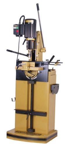

Someone mentioned the drill press morticing attachment, I tried one out and found it worked aweful. Too much pressure on the drill press table and tough to get enough leverage with a dp handle. The morticer handle is a lot longer and the base is solid and makes a difference. That was with the delta meant for my floor model delta drillpress.
TerryH
Dec 8, 2012
2,248
Springdale, AR
One of my favorite machines is my old style Delta mortiser with the Rockler mortiser table. I have a bazillion mortises with it. The key to success for me anyway was a good set of chisels. I have the premium ones from Lee Valley. Made a huge difference in the performance of the mortiser and the cone sharpeners are both well worth the money.
http://www.leevalley.com/US/wood/page.aspx?p=53252&cat=1,180,42240,53317
I also use the Rockler expanding hose to capture the chips. Very happy with how this combination works. I almost always work in white oak so they have been tested. The little Rockler table is a cool deal. Once set the rollers allow the work piece to just slide along the fence let stay secure. The rollers are actually little tires from their toy kits. lol... But the work great.
