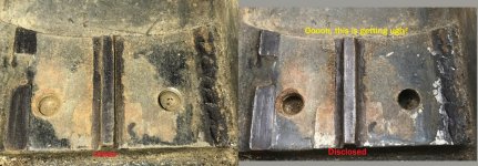

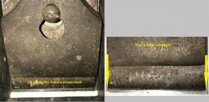

Phase 2B - The Frog​
PHASE 1 - Post #1582 - PHASE 2A - Post #1615
Once the cutting iron, cap iron, and lever cap are removed the frog is exposed. The frog is the heart of a plane. It has to be seated well and be adjusted well in order for the plane to work well. Just ask Leonard Bailey. There should be at least two metal pads cast into the bottom of the frog. They are meant to register against bosses which are cast into the bed of the plane and then milled flat . When the frog is screwed onto the bed, the pads and bosses should be firmly seated against each other. The better the two parts register, the more firmly the frog will be held. Since the assembly consisting of lever cap, cap iron, and cutting iron is held against the frog, if the frog is steady then the cutting iron will be steady and the plane will cut smoothly. Conversely, if the frog moves, the cutting action of the plane will be badly affected. There are different methods for determining how well the frog is seated. I colored the matching parts with black Sharpie and then, while holding the frog in position with one hand and applying slight downward pressure, I moved it back and forth. Where the metal parts scrape against each other, the Sharpie will be rubbed off exposing bare metal. The more metal that is exposed the better the parts fit. The leading edge of the frog also serves as a pad. It registers against the top of the bed immediately behind the mouth opening. I applied Sharpium there too. Let's see how well the National did.

Phase 2B cont.
As you can see from the Sharpie test there were very few points of contact between the frog and the bed. In Phase 2C we'll do the same test on the bed bosses and see if we can figure out what's going on. WARNING: If you're squeamish you may want to skip Phase 2C

CRSINMICH
Aug 15, 2015
2,440
Southeastern Michigan
Phase 2C - Bosses on the Bed
(This will be the last regular post of this series but I will continue to ask for your help and keep you updated)​
Phase #1 - post 1582 Phase #2A - post #1615 Phase 2B - post #1629​
Here's where the faults of this plane go from being quirky to potentially serious. I need suggestions for how to deal with this. The result of what I do will determine whether this plane ends up being a user or a conversation piece.
In Phase 2B we found out that the frog was not registering well against the bosses on the bed of the plane. This needs to be dealt with if the plane is going to be usable. Now, we're going to examine the bed bosses.
