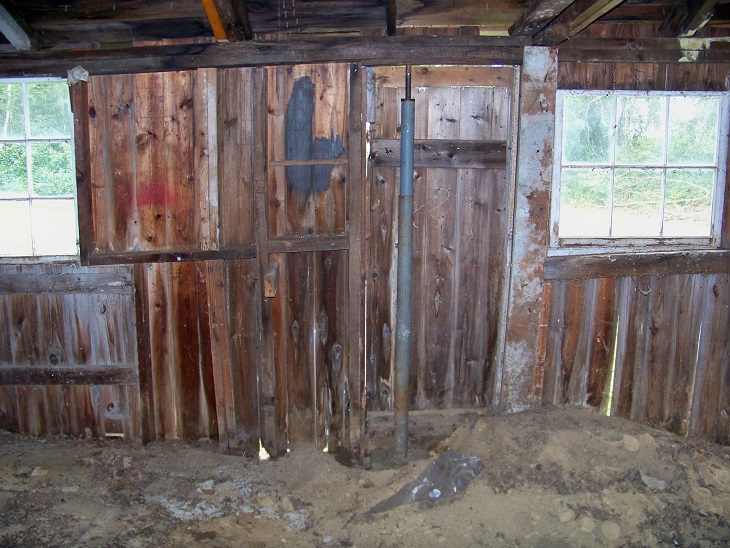

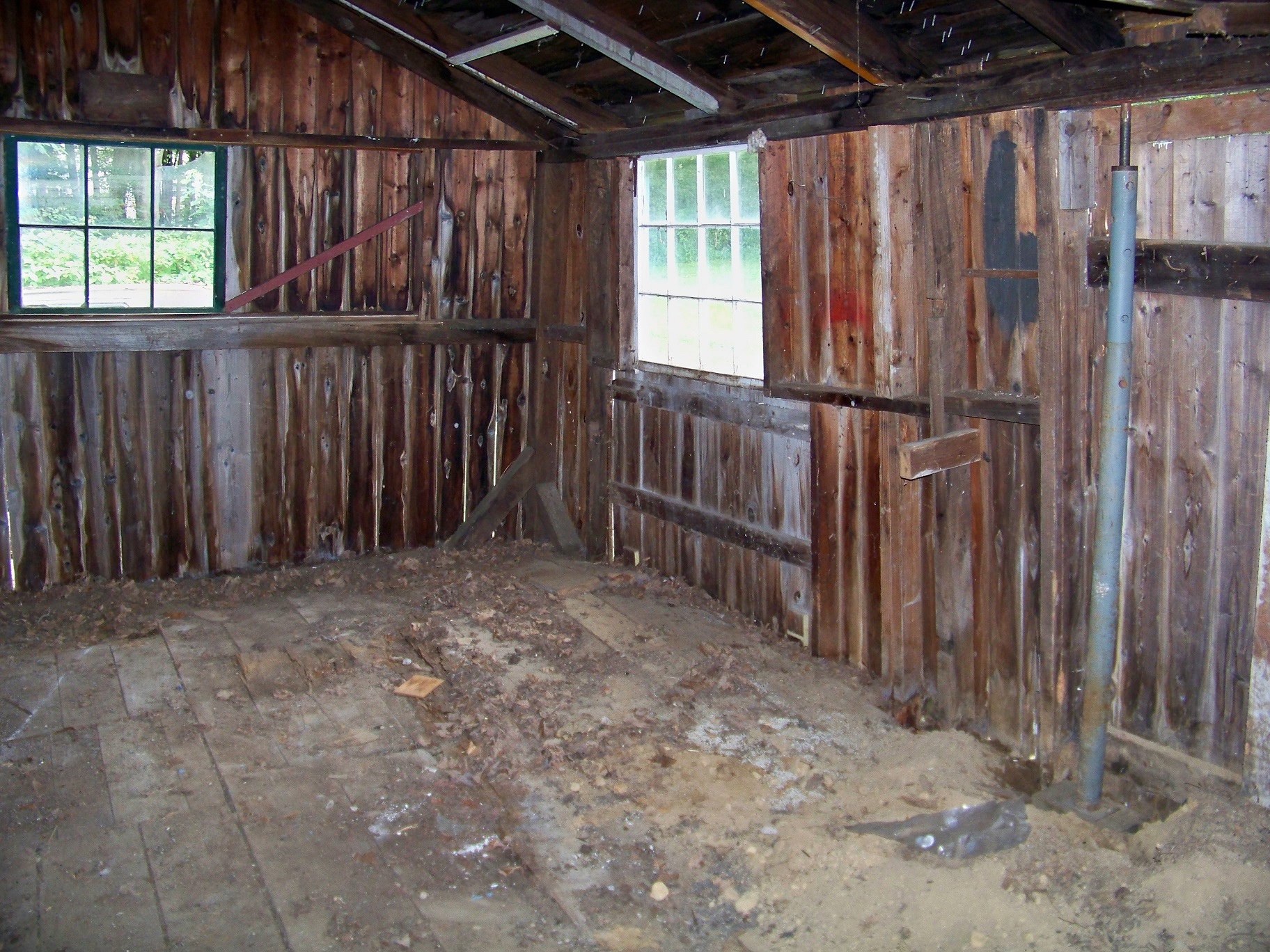

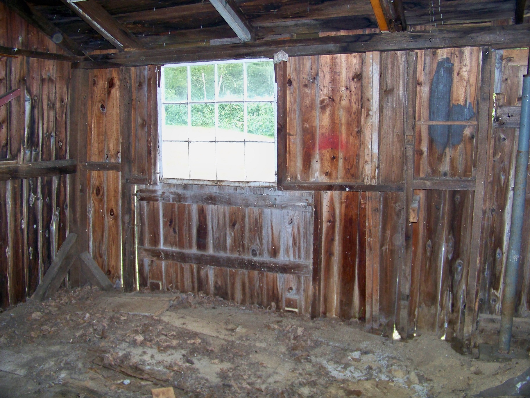

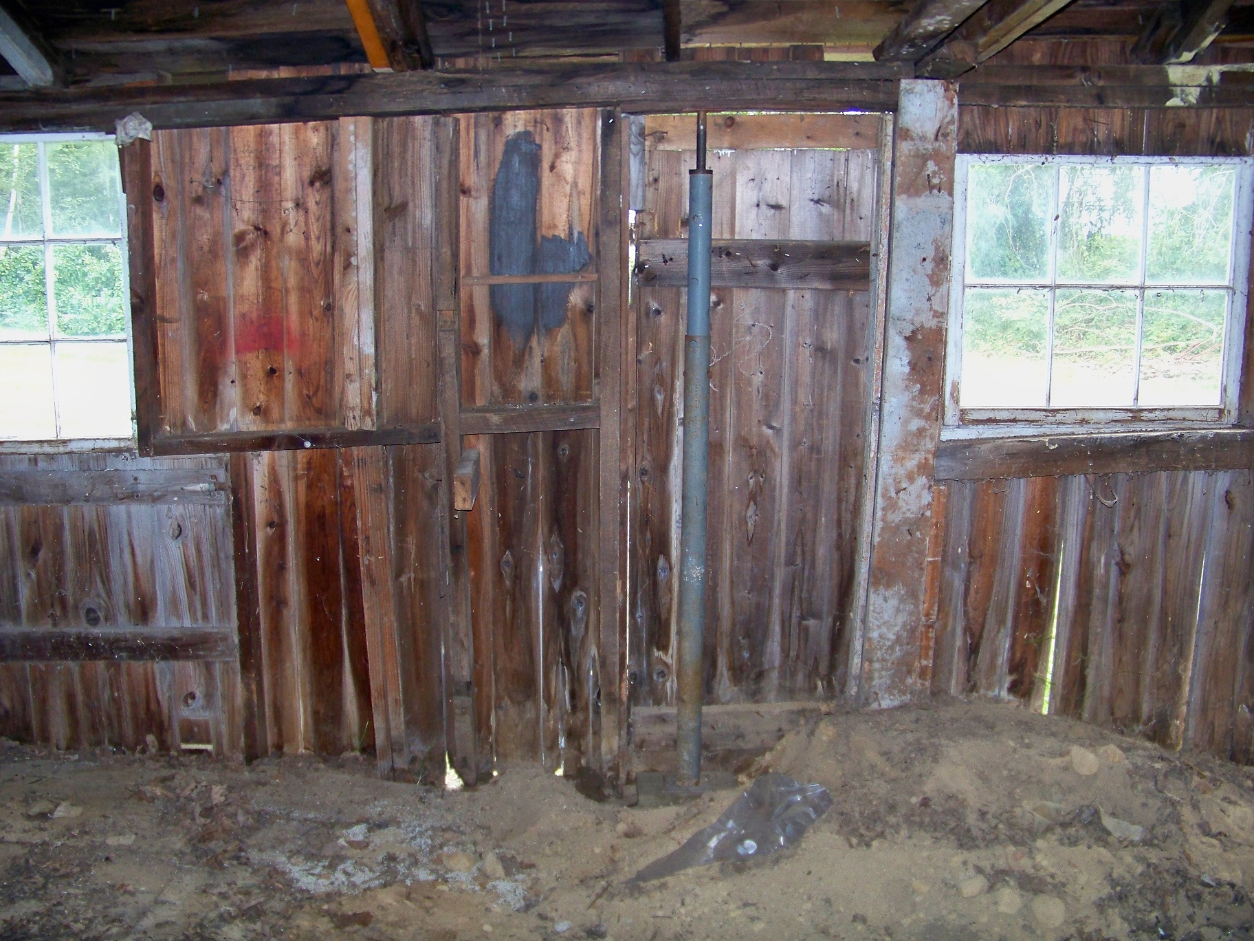

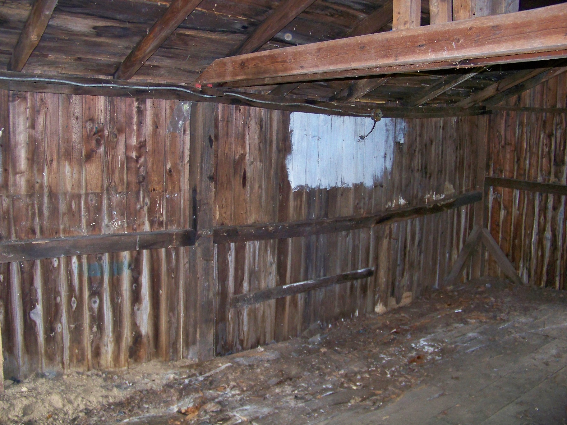

Once I finish cleaning out as much stuff as possible from the 1940s era 12x24 garage pictured (more pics in my roof thread (linked) I’m going to take a shot at raising it at least 6 inches, maybe more. Over the last 80 years it has sunk at least 6 inches into the ground.
To the best of my knowledge it is built like a mini pole barn with the poles just sitting in dirt = no sill plate or foundation. I’ll have to dig down in one spot to see what’s really there (or not there). There is a wood floor that is just large tongue and grove planks placed on dirt = not connected to the structure (or each other for that matter). I’ll post interior pictures when I have enough stuff out to see what’s really going on. I know I shouldn’t have done the roof first, but that’s too late now, so my goal is to move the whole structure up while maintaining the messed up roof and ridge lines. I’ll write that off as “character” and aim for a “Rat Shack” look. I’ll put up some collar ties to keep the roof stable.
I have read several threads here that deal with somewhat similar scenarios, but most are now suffering from lack of pictures due to the photobucket fiasco:

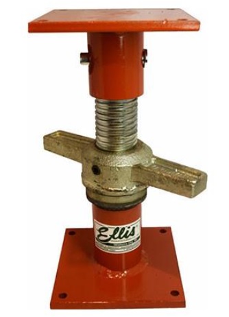

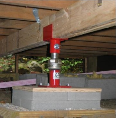

So far I’m thinking of Qty.7 of the Ellis Light Duty Steel Lifting Shore STL-22 (linked)
each with STL-JHD double joist holder U-head adaptor (linked).
Total cost = $1085. (I wouldn’t even consider this if I didn’t also need these jacks for a repair project on my house.) I’m also not willing to consider using bottle jacks as I expect the building to be raised for about 2 weeks (which probably means 4) as I can only work on this part time and the location is not at my primary residence.

Those are shoring supports not jacks. They can support big loads, but are not designed to raise loads. Search the term 'basement jack' for a much cheaper alternative.

I was there today collecting my 2nd truckload of **** = nine 20+ year old tires, an old dryer, a heavy as s#it cast iron bathtub … Upon closer inspection of the building, without digging (yet), I believe the whole thing is sitting on rotten horizontal 4x6 beams in the ground. That puts a crimp in my plan as I was going to put the jacks under the sistered 2x8s, which puts the base of the jack right on the sill plate. That’s obviously not going to work. I was really hoping to avoid digging, but that’s not sounding likely. So I guess I’ll have to use full 12ft long horizontal 4x4s under & perpendicular (running from left wall to right wall) to the sistered 2x6s (or 2x8?) to permit me to move the jacks a little away from the sill plates. I'm trying to avoid poking holes through the walls and jacking from outside.
Type of jack: The Ellis lifting shore with bearings inside the wing nut has got to be easier and better than jack posts. My problem with the bottle jack method is I’m not sure I trust 7 bottle jacks holding the building up while I either put cribbing in place or make some kind of foundation.
After I’ve lifted this thing, (assuming the whole thing doesn't come crashing down on me) I was thinking I’d follow most of theoldwizard1’s advice from the roof thread (see below) except I want to lift the whole thing at one time and leave it there while I replace the rotten sill plate and likely rotten posts.
IMHO, ANY amount of money to fix the roof is a waste without doing something about the lack of foundation and the obviously now rotten wood in contact with the dirt. If it is only going to be there for a year or so, cover it with a blue plastic tarp.
If you want to see this thing last more than just a couple more years you don't need a full foundation but the is a lot you can do.
  • Jack up one side so that it is a couple inches off the ground. Brace the other sides so they don't move.
  • Cut off about 1-2' of the rotten studs along with the rotten bottom plate.
  • Lay down a PT 2x8 that is the complete length of that side. You could also use some double 5/4 PT deck boards that are shorter so you can splice the with at least a 1/3 overlap. Add/remove dirt to make this level. You could also use a couple of additional non-PT 2x8 on top of the PT 2x8 to cover the splice and to move the whole structure up from grade 4-6".
  • Cut 2x4 to go under each stud that you cut off. Nail 1by on both sides of the existing stud and to the new "extension" down to the new plate so that it can not "kickout".
  • Toe nail the built up stud to the plate
  • You should use hot dipped galvanized or stainless nails on PT wood.
Far from perfect, but with some extra bracing in the corner (AFTER you have made the walls plumb and square) it will likely stand for a long time.
I will need to add extra support posts as it currently only has 6 (3 per wall, 12 ft apart), which is the cause of the roof dip.

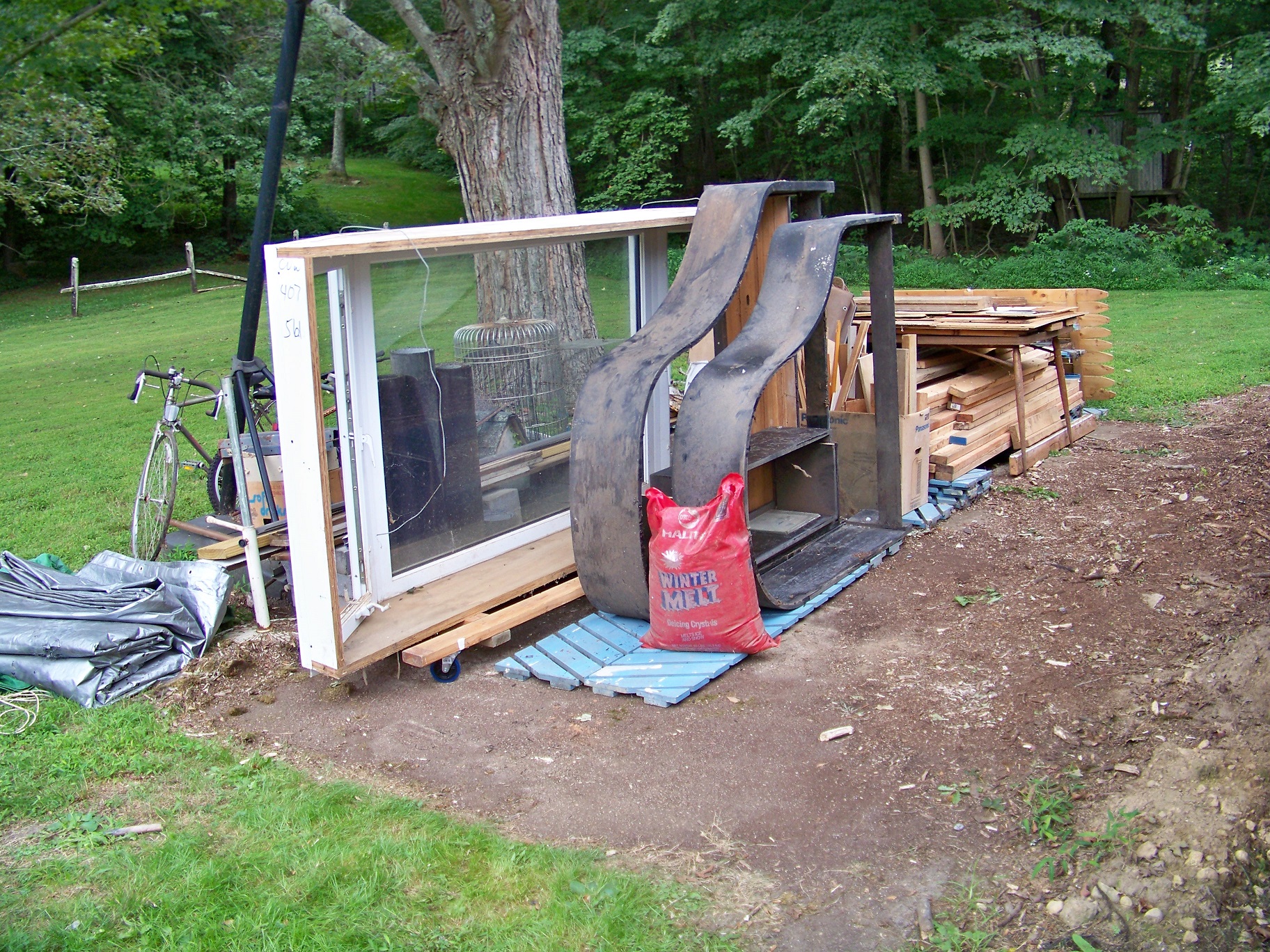

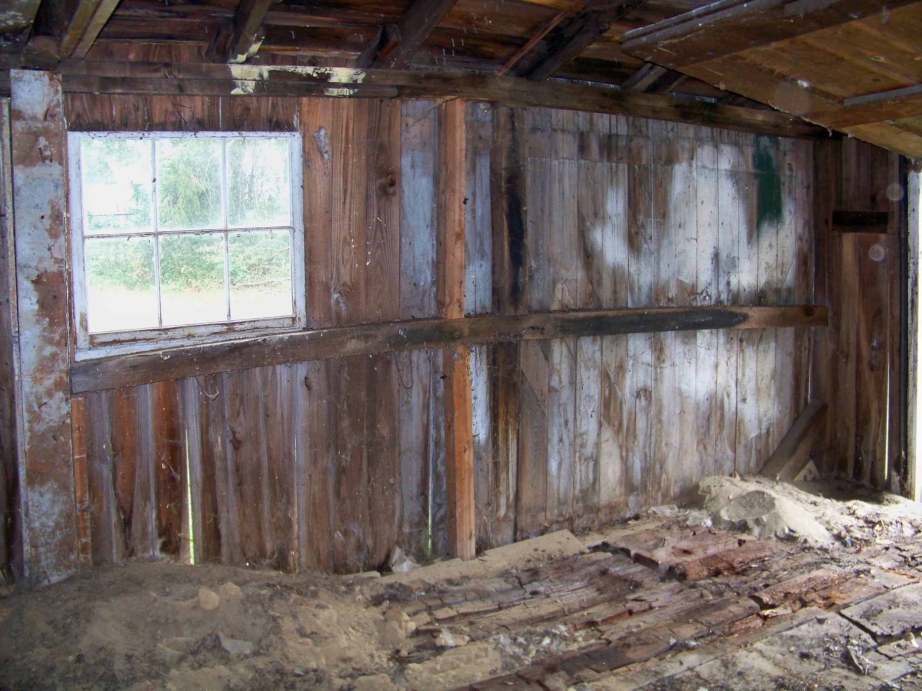

Finally got all the stuff out of the shed. Had to build a dolly to get the bay window out. I should probably toss the old paino frames. Always thought they'd make interesting shelves - not sure if it's worth the hassle.
(All images linked to large views)
I really don't understand where all that dirt is coming from. It's higher in the shed than the exterior grade. Do raccoons play with dirt? There's raccoon turds everywhere. Not that I'm a **** turd expert - just guessing really.
The pile on the right side of this pic is actually 2 bags of sand that broke open.

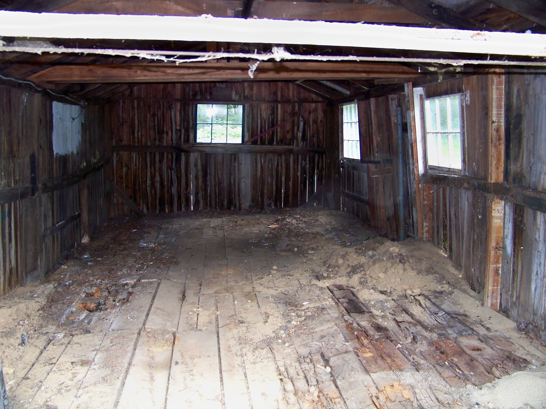

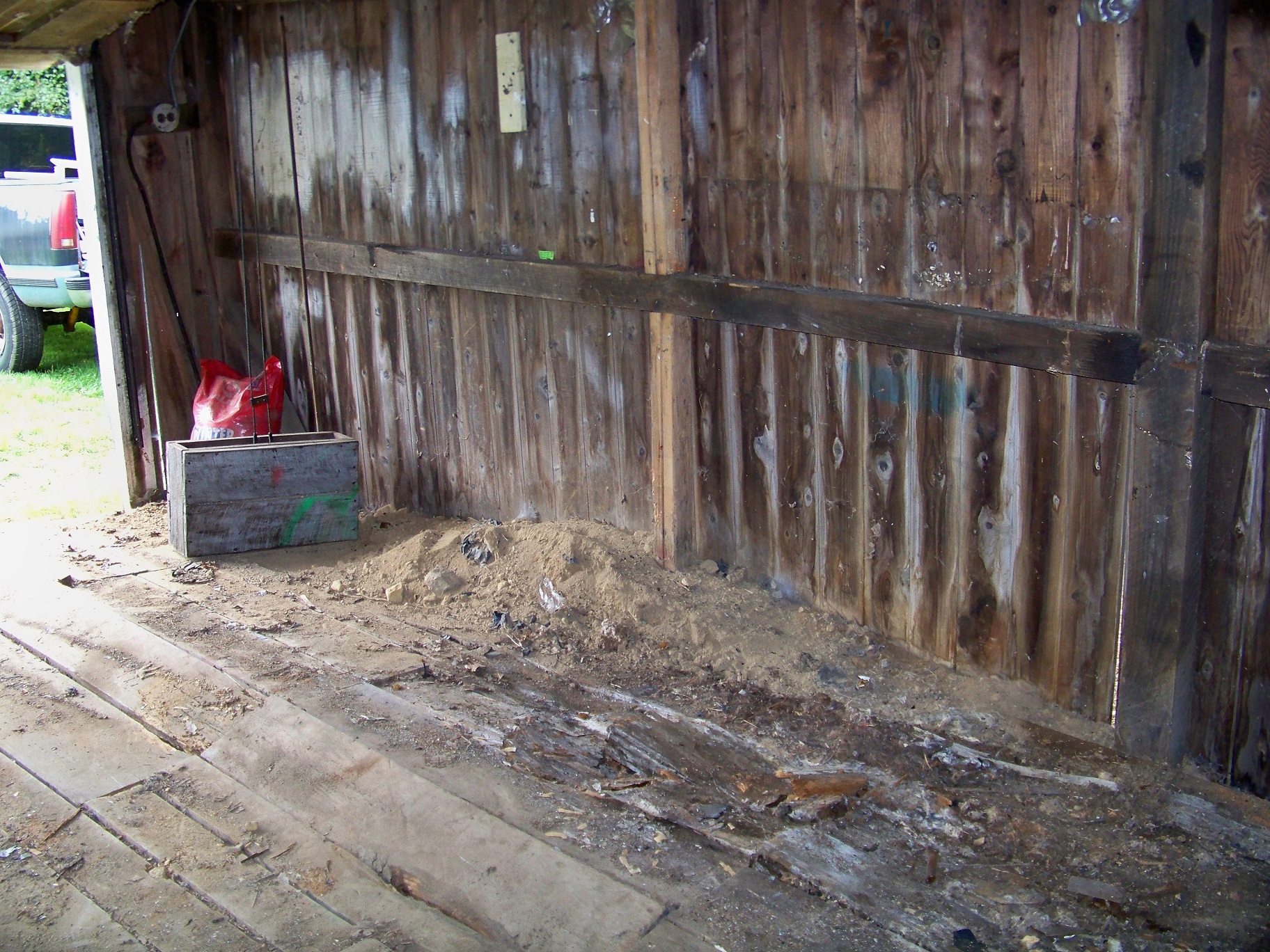

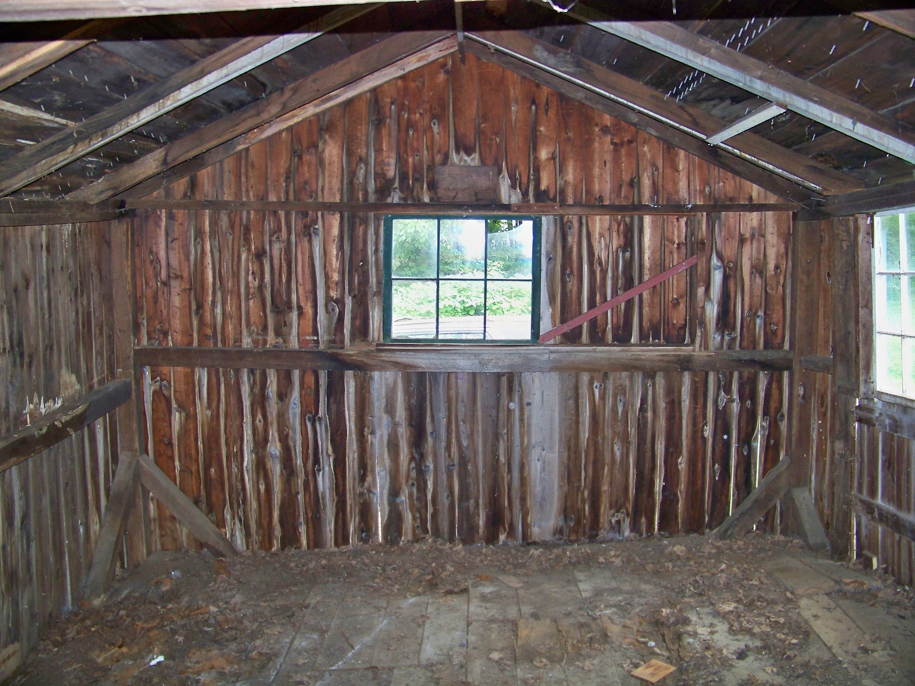

Pics Continued:
Next step is to remove the floating tongue and grove flooring. At least 50% of it is trash. Definitely some type of hardwood as even the small pieces have real weight to them.

In the one photo you show two angled beams holding a corner post up straight. This indicates to me that at one time there was a Sill Plate sitting on stones(?). It has all sunk into the ground over the years(?).
Tie the upright posts (6x6) to the ceiling beam with a 2x8 plate to stabilize the post to the beam. Then look at lifting from down low (my preferred way) or lifting the ceiling/roof beam which in this case may make more sense.
You'll need to lag bolt a 2x8 across from post to post to lift on. Then crib up to it to get the jack in there.
Or second option depending on soil/ground conditions would be to build a low base to set the jack with a 4x4 post going up to the cross beams.
Its a challenge but been done before!
BTW you'll need to guy wire the building to prevent it from shifting if you feel the need to lift the whole thing at one time!
It ***** when the post is canted a little and the building shifts direction!
