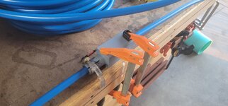

Close up of the mount block for the vertical pipe mount, repurposed the temporary proof of concept horizontal holders by taking a 1/4" off the base with the bandsaw and then a couple picture hanger D-ring type pieces to use as cinch points for the double sided velcro
Bandsaw makes a decent pipe cutter as long as I don't have to deal with a big tail...if so then it's sawzall with an 8" blade
And the air line project showed up:
Now to find/make mounting clips for it

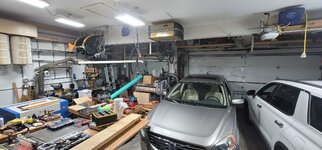

Got the corner turned on the main trunk...from here it's just a straight shot down the wall with probably (4) Wye's on there for future tool hookups. Although as I think about it I should probably make those 6 x 6 x 6 wye's and right now I've got 6 x 6 x 4's......trip back to Menards is apparently in the future
The big chip collector can is a demonstration in redneck "make it happen with **** you already have" I had a likely irrational fear that this whole thing wasn't going to work well enough and as a result didn't buy a better chip collector yet and wanted to prove it out before going down that path. Think the long term collector will be a short metal container with a flex hose connection to the cyclone.
That was enough to be able to get a test run in with a single open 6" port
And at the open 6" port which will be tablesaw
Noise is what I was hoping for...very tolerable and I think can be made quieter still
This is off the phone, with the phone at basically ear height while standing at the tablesaw. A lower pitch noise at full blast, but easily able to have a conversation and I think with some additional noise control work I can quiet it down some more. VFD fan to cool the controller is actually probably a more annoying noise than the blower/motor itself

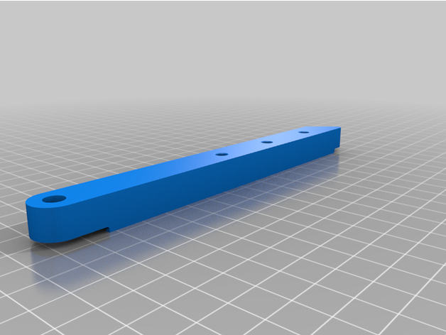

And the files needed for the 3d printing:

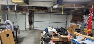

Speaking of tripping over projects....the garage is a mess
But making a bit of progress trying to get tablesaw and router lift hooked up. Not exactly sure how I'm going to do the overarm dust shroud yet....likely a long 2.5" hose with some type of over arm support
