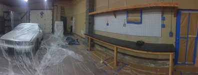

I'm off for the next two weeks. Plan to spend my days in my shop. New roll up door for bay 5/6 is coming tomorrow morning. It matches the other two doors and is insulated. The old wood and Masonite door is not looking too good.
I've been busting hump to get this room painted prior to the door install. Painting the pallet rack was prep, as was the work bench & shelf above, patching in the interior roll up door panels and so much more. It's finally closing in. I'm going to try to stay here tonight and get two or three coats sprayed. One or two Kilz original and a latex semi-gloss white top coat. I can't wait to have it painted.
I replaced the upper garage door header. The old one had a twist from the spring. This one has bracing to prevent it from happening again. I also ran 1/2 EMT for the openers sensor bell wire. Cleans it up a lot.

Down to the wire. Got to the shop at 4:30. Ready to paint!! Hoping its dry by the time the garage door tech arrives!!
Before:
wasfast
Apr 10, 2014
874
San Diego CA
You may have some bleed through challenges on the old drywall. Kilz does indeed work well but that yellowed paper can be troublesome. You certainly get the option of spraying the section where the garage door is and not the entire room so you don't hold him up.
