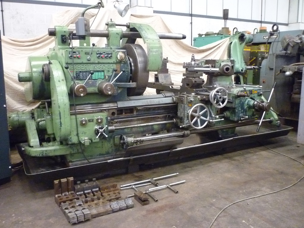

Lathe looks great. I like the original green makes me think of a 1970s fridge.... or the green toilet in my grandparents bathroom.
dutchgray
Sep 28, 2014
6,473
Dorset. England.
I've had people fret about wear- a steel bar on a steel block- but I use these extensively, and have seen virtually no sign of wear. Even my shop-made blocks, which are unhardened mild steel, hardly even show a mark.
Doc.
Like most things people worry about a whole lot of nothing.
Wear would probably be worse using a softer material like plastic as it could embed abrasive particles, but even then it would be minimal.
But the blocks pretty much just rest on the bar, there is minimal sliding between the surfaces, most users would see more damage to the tool holders by being lazy and not cleaning the holders and tool post surfaces properly.
