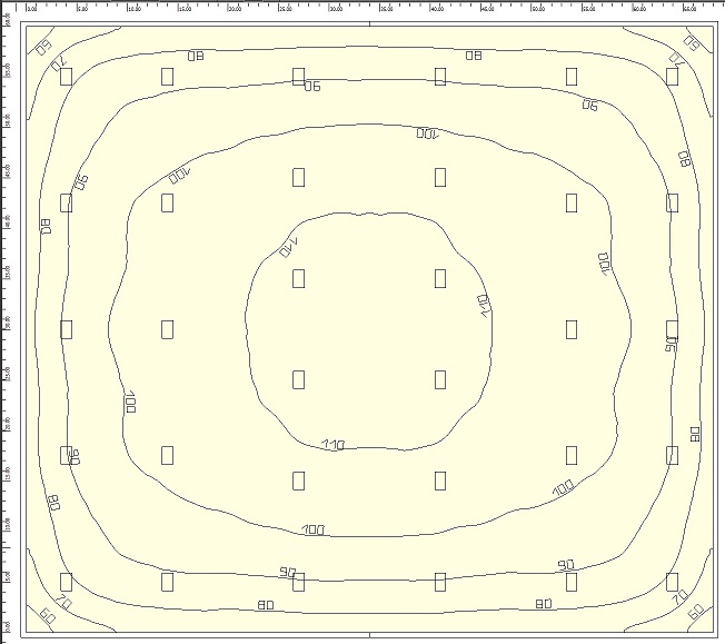

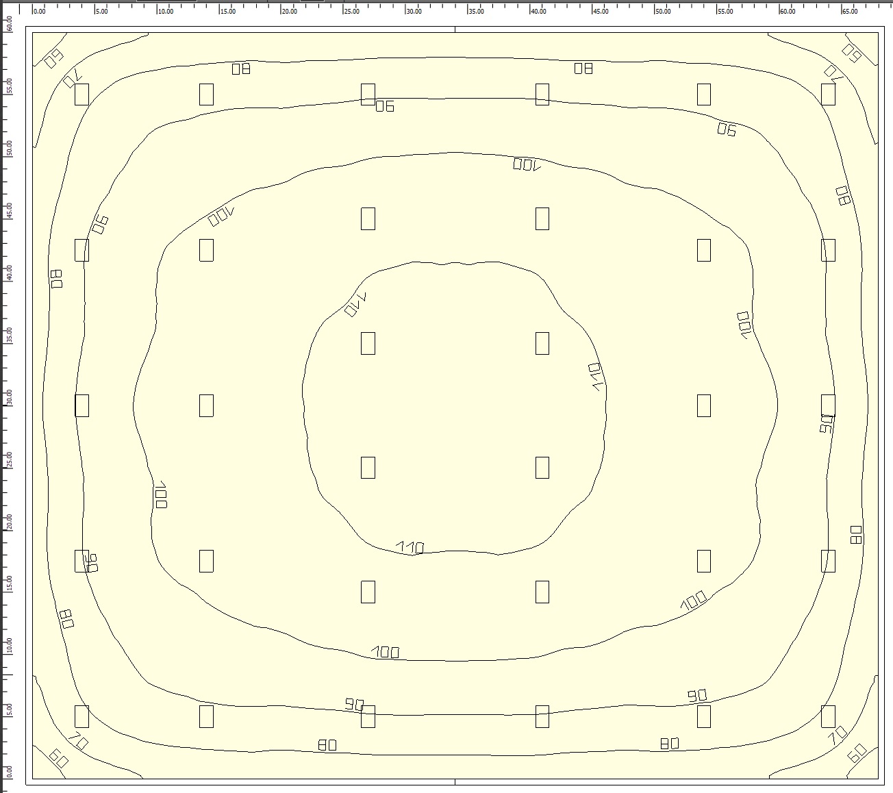

Three car garage that will primarily be for parking and the occasional car detail(probably once a month). ... Garage is 29' deep, 33'2" wide, flat ceiling at about 11'... fully dry walled.
That pretty much coveres the whole spectrum of lighting from parking where very little light is required to see where you're going, to detailing which requires excellent lighting. At 11' fixture mounting height, look for fixtures around 8000 lumens. 3-Lamp LED strip lights are a viable option. Idealy you want fixtures around the perimeter of the vehicle(s) to eliminate shadows. You don't have to use the fixtures that are linked in Dialux (I never do). If you want to play with the Hyperikon fixture (whose light output is really too low for 11' mounting and detailing cars), contact Hyperikon and ask for an IES file. Alternately, find a similar output/style fixture IES file (there are quite a few in the visual tool under Lithonia).
Thank you! I will look for 8000 lumen fixtures and go from there.
