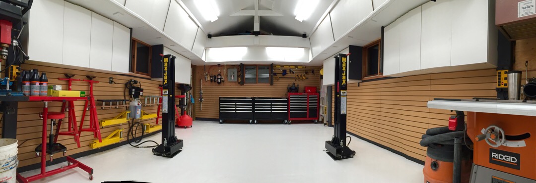

If you're doing slab work, lay some conduit under .. I ran my lines under my slab and wall mounted the unit. Makes for a clean install:
Radman
Feb 3, 2021
21
Florida
I read through your build, fabulous transformation. In my case, slab work is a last resort and not in the plans at the moment. Test holes show the concrete to be thick enough at 4-5". However, if I must pour, conduit is probably the way to go, so thanks for the reminder!

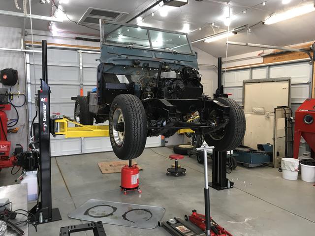

I mounted my pump on the column and installed stainless hardline. Much cleaner install. Those long, stiff hoses that came with the MX6 sucked. I had a hydraulic place make the hardline and shorter flexible lines.
You'll love the MaxJax. I've had zero issues with mine. Having a lift is really a game changer.
