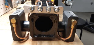

SRL-Stage1
Apr 19, 2013
2
Here are some pictures of my install from prepping the concrete to the finished product.
Cutting of the slab.
Prepping for the pour, I went 12" deep with a 6" undercut on three sides. Also pinned to the existing slab and foundation.
A couple of days after the pour.
Finished product.

NewShockerGuy
Oct 12, 2010
2,481
Northern Virginia / DC
Finished product.
What is this?! I've never seen anything like that?
