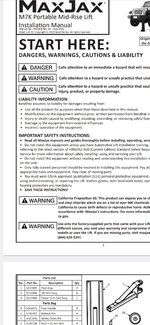

So I received my MaxJax M7K a bit ago and did all the concrete reinforcements. I'll post pictures later. I bought some Wej-It PS2-58 epoxy anchors from Stanley Supply since I'm a cheap *** and they're the cheapest vendor I could find. The threading was pretty bad so I first contacted Wej-It to see what to do about it, but turns out the bolts that I was using provided from MaxJax that were supposed to be 5/8-11 were not. Once I had a real 5/8-11 bolt it threaded OK, and was just a bit crusty. The threads to the eye look not great but it's probably just a worn out tap. I spoke with the owner of Wej-It / Toggler and he said they have stopped working with MaxJax so it is normal to not receive Wej-It products with our MaxJax accessories. Also he said they do not supply to Stanley Supply so he's unsure of where they're getting them or if they're knock-offs.
So as we've suspected MaxJax have definitely started supplying chinese knock-offs or "equivalents" for these products. That said, I would DEFINITELY NOT buy the epoxy anchor kit from MaxJax as you do not know what you're getting. Wedge anchors probably are a fairly understood science but I feel really sketched out that they'd not indicate a brand name on the epoxy anchors on their site. Considering you literally cannot find any epoxy anchors of the same type on the internet from any other brand, they have to be sourcing them from the shadiest suppliers.
Edit: Stanley Supply is OK and the anchors they sent were legit. They're old stock as Wej-It hasn't been one of their vendors for 4 years according to Toggler. The date on the box is 2018, so that checks out. So it is probably OK to order from them if they still have them. Probably wouldn't get the epoxy from them though, as it's probably past its shelf life by this point.
They switched to metric (M16) at least 4 years ago. It is a bit ridiculous that even the M7K manual, dated 2022, still says 5/8-11.
I'm not sure I'd agree that the epoxy anchors are shady garbage because they are no longer sourced from Wej-It.
That's beyond ridiculous. Even in the anchor box manual and website it says 5/8-11. As I didn't have anything to compare against and it looked about right I was very confused when they didn't fit the Wej-It epoxy anchors. I will continue to be sketched about the anchors until they say who they source them from or provide an accurate datasheet. If all documentation doesn't even have one of the most important dimensions (bolt size) listed correctly, then I don't trust them.

So decided to check the threads in the maxjax epoxy anchors, the instructions state they are 5/8 - 11 and I bought some class 5 bolts. But when I tested they stopped threading after 1/4 “. So tested with different bolts and they are 16mm x 2.0. Grrrr.
So going to pickup some M16 x 2.0 x 40mm bolts now

My Pivot pins for the yellow arms is 1.5" diameter.
M6K arm pivot pins are 1.5" as well. I got 2.39" OD and 1.5" ID for the cylinder

Only thing that would make it have higher capacity is a different hydraulic cylinder…since you are all finding the structure to be the same..
That's what I would think too, but it specifies the same part number of 5502043 in both the M6K and M7K manuals. Doesn't necessarily mean they didn't update the part, but I would think they would designate a new number to avoid confusion with people ordering parts for the different models.
alan camby
Dec 3, 2011
1,566
South of Indianapolis, Indiana
Don't lift 7k lbs on a 6k lb rated lift.
I am going to make a big assumption and say they are the same. The assumption is that the M6K did so well on the ALI testing that they decided to change the rating to 7k lbs to appeal to more customers. Rating them for 7k lbs would mean they would have to pay again to get the lifts certified. I looked at these lifts many years ago and decided it wasn't for me as I wanted to lift 1/2 ton trucks with no problem.
When I heard they were making a 7k version, the Maxjax definitely interested me.
As mentioned, part numbers seem to be the same. So far, we have been unable to find anything different, besides a few stickers.
See attached for examples of some key parts.
With all that said. Don't ever use a lift past it's rated capacity. The sticker on your lift should indicate the capacity of your lift.
