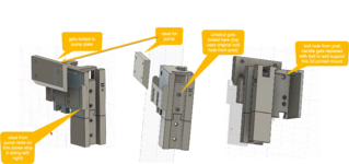

Moved my lift into the new shop. Had a couple of things I had to figure out
1) I needed to run the hydraulic house above the lift, but in the new shop, I have a large ceiling fan, so can't hang it from the ceiling
2) I wanted to mount the pump on one of the posts (it was on the wall in the old shop), but I don't want to drill new holes in the post.
so I designed a mount in Fusion 360 that uses the existing holes in the posts (the handle and the bar that sits at the top to keep hands away from the jacks/pistons (or whatever you call the cylinders :)
Solution :
3) On one side, made mounts for uni strut so I can run about 10' high and across for the hose and I'll mount LED's on it too for additional lighting
4) on the other side, I created a cleat so I can drop the pump on
5) It's all supported by class 8 stainless hardware for extra strength
20 prototypes in PLA and final print in PETG with 4x 1 mm walls x 20% 1m infill and best of all no new holes in the lift, and 100% reversible..
I hung of the cleat and I'm 180 lbs so I figure it can handle the pump :)
I'm going to and a stubby c-clamp to the front of the pump side for "insurance" that will hold the cleat in place if the plastic fails.. but it looks great so far.
I'm working on some accessory parts now to hold the pad risers via a dovetail attachment.

I don't think I could pull off something like that in tinkercad, its for children. Coincidentally a 3D modeling tool for children is just simple enough for me to be able to use it. Nice job building all that out. Can you post some of those pics individually? I'd like to take a closer look at what you have going on there.
sure.. I probably need to take better pics.. I use fusion 360, did a bunch of the videos on youtube to learn it over the last few months..
the left post is just to mount the unistrut and potentially accessories like the pad risers
the right post supports unistrut and the pump on a cleat
left post with unistrut mount
right post with pump mounted on the cleat (and unistrut on the other side)
right post with unistrut
closeup of cleat and unistrut with pump mounted
cleat attached to the pump plate (that came with the silly cart thing)
this is the model broken out a bit..

...I hung of the cleat and I'm 180 lbs so I figure it can handle the pump :)...
But the pump is 181 pounds so you're probably screwed. :lol_hitti
You're use of the Unistrut is pretty smart. Great solution. I don't have a fan so I had stainless hard lines made and ran them up, across the ceiling, and down. I had custom length hydraulic hoses made so I could ditch the factory, super stiff lines. I also mounted my power unit on the column. It's pretty clear you're way smarter than me. :bounce:

Ha! If it works the way you’ve done it it’s perfect. I think I enjoy building things more than I like using the finished product ;-)
