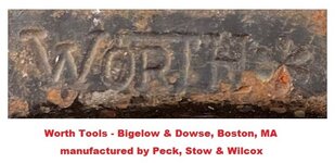

Kastar (early) - Long Island, New York
(photo image courtesy Dave455)
Kastar now part of A & E Tool
A & E / (see Lang) / http://alloy-artifacts.org/a_e_manufacturing.html / http://alloy-artifacts.org/a_e_manufacturing.html#history / http://toolarchives.com/node/366 /
Moore Drop Forge, Springfield, MA
"M in a circle" LOGO
Moore / Moore Drop Forging Co., 336 Birnie Ave., Springfield, MA / http://alloy-artifacts.org/moore-drop-forging.html / http://alloy-artifacts.org/moore-drop-forging.html#history / http://toolarchives.com/index.php/node/236 /
PEXTO - Peck Stow & Wilcox - Southington CT
(photo image courtesy d42jeep)
Peck Stow & Wilcox / Peck Stow & Wilcox Co., Southington, CT / P.S. & W. / PEXTO / PESCO / patent 553059 / http://alloy-artifacts.org/peck-stow-wilcox.html / http://alloy-artifacts.org/peck-stow-wilcox.html#history / https://toolarchives.com/index.php/node/261 / http://vintagemachinery.org/mfgIndex/detail.aspx?id=2721 / https://wrenchwiki.com/peck-stow-wilcox/ /
