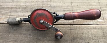

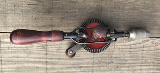

I would have left this spray bombed eggbeater behind yesterday but when I shook it there was a rattle from the bit storage area. I found quite a few bits so I picked it up. Here it is after some cleanup today.
I ended up adding the new eggbeater to my S-K carpenter’s box. It replaced the upper one in the following two pictures. IMG_0183.jpegIMG_0182.jpeg
Here are the tools in the S-K box. They are mostly all Stanley, excluding the auger bits.

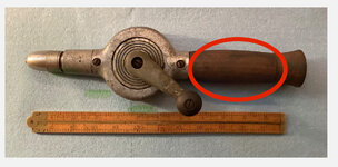

Hypothetically; is it possible someone remade this handle? I have seen very similar as well, but not he circled portion is metal.IMG_2189.jpeg

Hypothetically … if it was a replace,ent handle, it was done by a GJ member cuz the work is flawless. There is a screw deep in the handle that secures it to the drill body, and why would someone go the the trouble of using a metal insert for the threads?

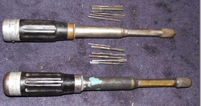

Got a question about a push drill. Just picked up this Goodell Pratt 188 drill, it’s in very good condition. No bits came with it, but that’s ok I have a couple. Seems to be a little stiff.
Here’s the question. When I try to use it, push down firmly on the handle, the bit only rotates about 90*. That seems like too little, I would have expected 180* at least. The exposed length of the small shaft is 2-1/4”, the upper shaft only goes 5/8” stop to stop. Thoughts?

Ok, I found this post from 2011, the author shows how to break it down. He makes the comment that 1-1/2” of push travel gives 1 rev of the bit, so mine clearly has a blockage somewhere.

Field stripped it. Found 2 bits up in the handle where they didn’t belong. Doesn’t make sense, the 8 holes for the bits have solid bottoms, no way for them to fall through.

Don't know my GP push drills that well, but do know they need a specific bit with a cross on the **** end, so you did well to find more.
