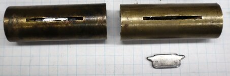

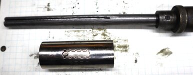

The Yankee drills using a five ratchet selector position have always interested me. How do they work? When I bought a group of Yankee 1555 breast drills, for parts, there was one selector that had obvious damage to the "fingers". Looking online, I could only find warnings that it was difficult to take apart. Decided to try. Figured it out and thought I would share. For the pictures that follow I took a good one apart. Very important to keep things in proper orientation. So in the pictures, the "top" is top when you can read the writing on the shell. I rotated the top to the right in many of the pictures but will refer to either top or bottom. Front has the selector and back is opposite that.
For more information recommend G.O. Leopold's patent #939042 (Nov. 2, 1910). There are other patents, but this one covers most everything.
The selector positions are:
PLAIN
LH RATCHET
RH RATCHET
RH DOUBLE
LOCK
Tip: If moving the selector put your finger into the end and hold up the fingers on the end in the direction you wish to move it. Also, when putting it back into the drill, put the selector halfway between LH Ratchet and RH Ratchet. This will raise all the fingers and allow the idler gears to slip on.
To take apart, lay on bench or put into soft vice with back up. Take a wide flat blade screwdriver and stick it on the piece of metal sticking through. This actually is the key that engages the spindle shaft. With a light mallet, tap the screwdriver until the key moves inward a little bit. It will hit a hard stop, but only needs to clear the thin shell (about .030").
The insides should now be able to slide to either the top or bottom direction. I started with the top. Move just enough to expose the fingers and spring.
Remove the spring and then the two fingers, Put them on a paper and keep them in the same orientation on the paper. This is important.
See which way the fingers are as far as up and down. Now slide the insides to the left end and remove that spring and fingers. Keep them oriented properly.
Now you can slide the rest of it out, but put a finger inside to hold up the selector. Then allow the selector to drop and remove. Put with the springs and fingers keeping its orientation. It must go back in the same direction.
The selector has a spring on it also. A flat strip. Note which way it is oriented (up/down). The fingers all look the same, but one on the bottom is longer. The selector plate has a wider end at the top.
Thats it. Clean it up and put back together. Last thing is to move the key back into its slot.
I used a 5/16 rod and levered it up. Use the spindle itself to verify it's in proper position.
Additional note about the key. It's sort of like a Chinese puzzle. It pushes down to release the shell and once the shell is removed it could be removed but I don't recommend removing it. They used a punch to pinch into it that keeps it somewhat tight. Removing it may loosen it up, which would add wear and tear to the shaft. Here is a picture of both one in and one out.
