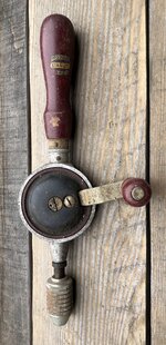

IMG_4372.jpegAs a little kid in my grandfather’s cellar workshop, I was fascinated by the hurdy-gurdy / eggbeater drill he let me use (black&orange Goodell-Pratt No655). As an adult, I’ve acquired a few others.
A few years ago, I picked up two similar breast drills in bad shape. Yesterday, moving some stuff around, I uncovered them and figured I’d see if I could get them apart. IMG_4370.jpeg
The lower one has a broken breast plate, which is peened onto the shaft i stead of held by a set screw, and broken teeth on the driven gear where they engage in low speed position (achieved by driving out and moving the retaining pin!). The upper one is missing most of the brace bit holder, which is also badly rusted (photo after overnight soak in MetalRescue). I thought at first to just swap the other onto it, but despite a resemblance, the shaft is a different diameter and length, and the threads are also different. IMG_4371.jpeg
Interestingly, most of the pins of the upper example are blind, while they are mostly through on the lower one.
At first I thought both were Stanley No732 or close relatives, but then spotted the 1911 John S Fray catalog showing model No6. I have not found a mfg stamp (on crank bar or elsewhere) yet.
I’m inclined to think the lower example is a knockoff, but with the improvement of the small roller that bears on a track inside the drive gear, reducing wobble. At the business end, it also has some kind of selector I have not yet explored.

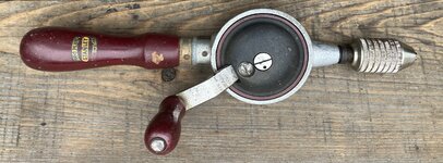

I found this Stanley eggbeater a week ago and cleaned it up some. It came with a good selection of bits.
