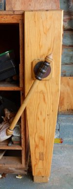

I don't have pictures of the cabinets or furniture I have built. I'll take some later. I do have pictures of some tools I built. They might open up the topics for discussion.
The first pictures are of Leg Vise ver 1.0 I just made it last spring. It's mounted to the end of the Catch-All bench in the garage. I do a lot of different things out there and fairly often I need to cut 2x4s etc. I got the screw for this at an estate sale for $5. Total cost for the vise was less than $10. It was really easy and totally fun to make. Now I want to build another bench so I can make another vise. I already have another screw.

One of the regular contributors to this thread and all around great guy, CRSINMICH encouraged me to post a photo of another bridge I built. This one I designed from scratch based on a requirement from the property owner to make it rustic looking and include some diamond shapes which echo other diamond designs elsewhere on the property. All redwood. This long shot photo of my work appeared in a national garden magazine. There is a seasonal waterfall that flows into a quarter acre pond.
