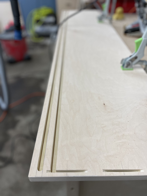

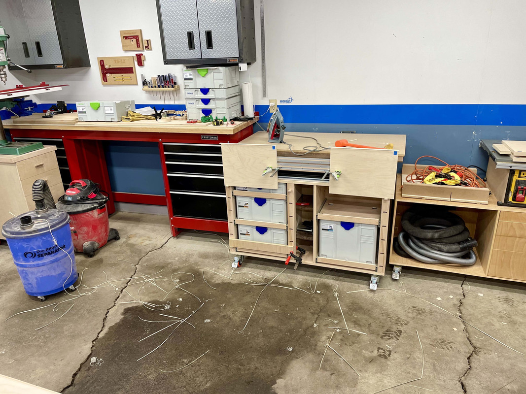

Ha, cool! Thanks Matt and welcome to Garage Journal. Yes, I believe it is run at least in part by Ryan.
I do like the wings. They are not my finest work but do the job. I still need to add stops for the legs and some adjustable feet.
I did not use plans, but I got the idea for the general design and usage from Timothy Wilmots. They are an extension of his "MFTC" cart which you can find pics of and that as well as his extension wings, here.
And also @ 3:00 in his YouTube video here.
I believe he used to sell plans, but I know he quit woodworking a few years ago and not sure if he still tends to that side of his business.
What I really like about the design is the ability to combine two on the long side of the cart/bench for full sheet support, or one on each side of the short side of the cart bench for long cross cuts. Almost like a miter station.
Another idea I've had is to put some T-Tracks on the walls around my garage and be able to quickly fasten an extra work surface here and there when not being used with the MFT.
Timothy was a huge inspiration for my bench build overall, and even if you don't intend to borrow his ideas I definitely recommend watching his YouTube content, it's fascinating stuff!

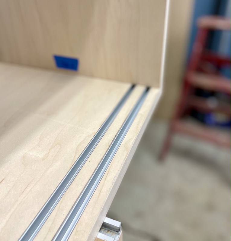

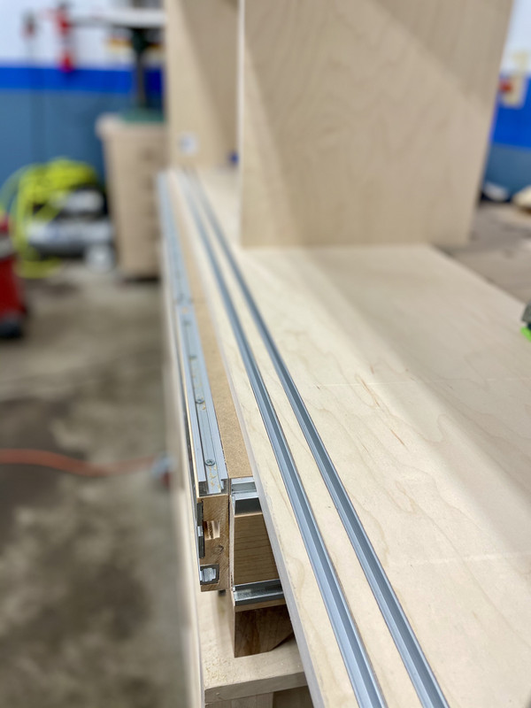

Further, the new 55" extrusion does not match the old one I had! I *think* the part the saw actually rides along is the same tolerances, but there are other features of the track that are definitely slightly different. Makita must have changed it's tooling or manufacturing some how. The aluminum is also a *slightly* different color/sheen. I don't think it will have huge impact on accuracy, at least I hope not, but it is disappointing all the same. These tracks are not cheap. They should be identical.
I have rails that were ordered the same day and are slightly different. Actually all 3 of my makita rails are slightly different in width. Irritating when swapping the saw from one to another as each time the cams need adjustment.
Imho get the 118" track eventually, its worth it.
That is disappointing to hear. The cams seem to be a fairly tight fit on both tracks for me, but where they join there is a little "hiccup". I found I had to loosen the cams *slightly* more than normal for it to slide from one track to the second. I think I can get by but I am wishing I had saved up for the 118". I think you are right, over time the extra cost would be worth it not to have to do the setup connecting rails and be stressing about the alignment.

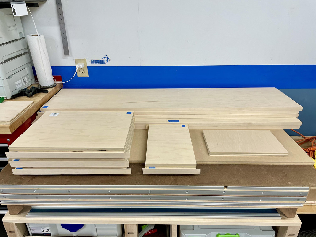

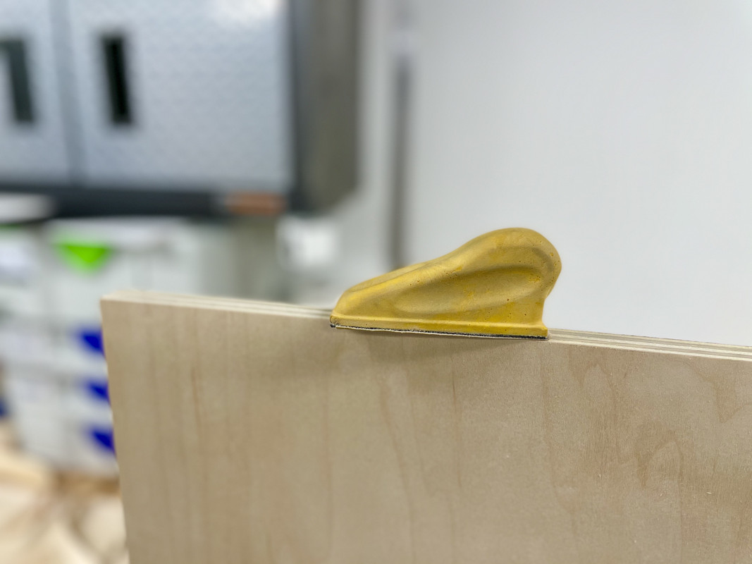

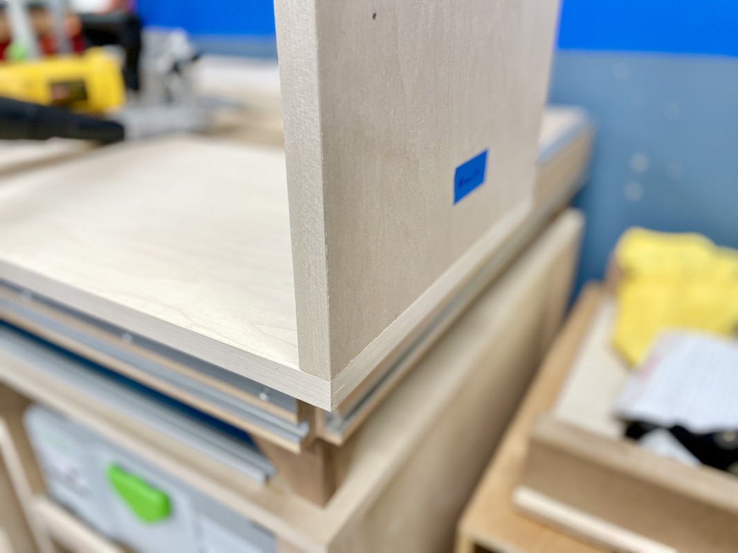

Living Room Built Ins - part 3 - edge banding

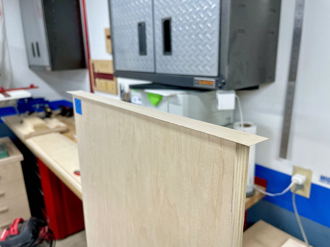

Yesterday peaked at 37° F, with a cold front moving in overnight. My edge banding showed up in the mail so I knew I had to take advantage before the temperatures plummeted.
The cabinets, while I've described them as "built in", will actually have a 1/8-1/4" reveal gap on the sides where they meet the wall and fireplace brick. I wasn't sure if you'd be able to see any of the side edges of the plywood, likely not, but on the off chance you could I decided to edge band the sides as well as the fronts.

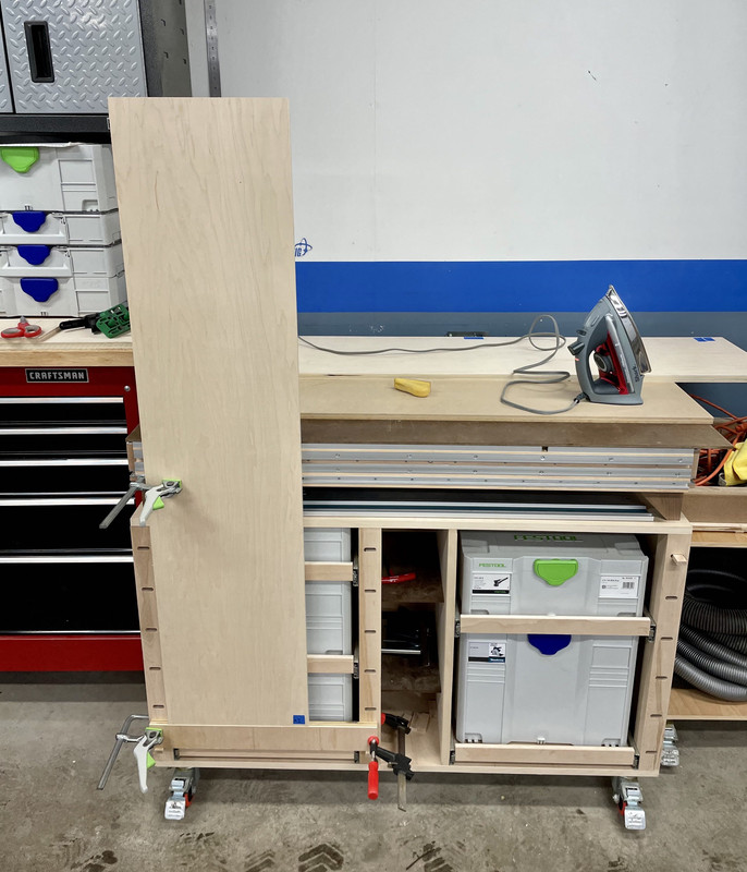

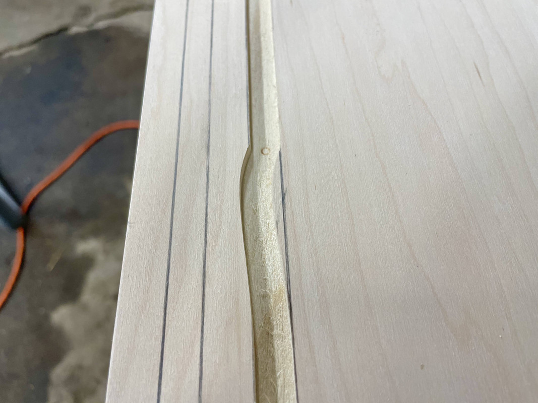

Sides go first. This way at the corners the front overlaps the sides and makes the joint less visible.
To hold a large vertical piece like this that's skinner than my bench peg system I just clamp a stretcher support board across:

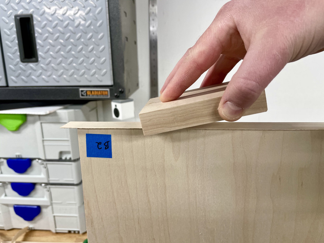

Do one side, flip it, then do the other. Before applying the banding, I like to do a quick hand sand of the edge with 220 grit:
The track saw leaves a pretty smooth edge, but a quick sand makes it super smooth and flat for the banding to adhere to.
After ironing it on I use a piece of hardwood to apply pressure, making sure to "seal" the edges especially as the adhesive cools.
They make special edge banding irons but I don't have one and prefer to use a standard clothes iron on cotton setting. It heats quickly, and gets very hot. I've never had an issue getting glue on the iron and ruining it, as some articles online would have you believe.
I did the sides of all pieces first. Once given enough time to cool (10-15 min max during winter!) I do the trimming. I've covered this before but in lieu of a flush trim cutter, a chisel and deadblow hammer work very well to chop off the ends:
I use a standard "quad trimmer" razor blade apparatus to trim the edges, although I took mine apart and only use one half of it. This is because cutting both sides at once will inevitably result in tear out! In fact I usually switch directions 1 or two times per side, always going with the grain. Stick to the grain direction and it works just fine.
Once all the sides are done I can do the fronts:
And the smaller bits:
A few hours and 40+ feet of edge banding later, everything is done. Still have to trim some of the smaller pieces, but you can see the long pieces in back are looking good.
Disappointing to hear and irritating to go back and forth.
The 118 seems to (or used to) go on sale regularly through various vendors. Iirc my dad picked one up for $170 shipped. I paid $220 for mine 4 or 5 years ago
The 118 (or 118+55 if you are doing 12' boards) is great for straight line ripping lumber.

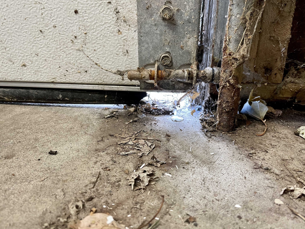

I can't remember, is your ceiling insulated? If so, it might be time to invest in some heat...
https://www.fleetfarm.com/detail/dy...ater/0000000006924?bc=11434|11695|11700|11703
Mills also has pump kerosene that is cheaper than the $10/gallon stuff they sell on the shelves. 1 gallon of kerosene feeds the heater for ~8 hours, although I rarely ever run it more than 3-4 hours at a time because once it hits ~50F in the garage, I usually shut it off.

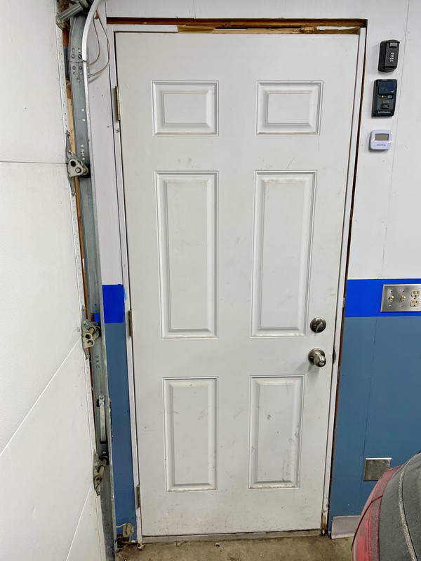

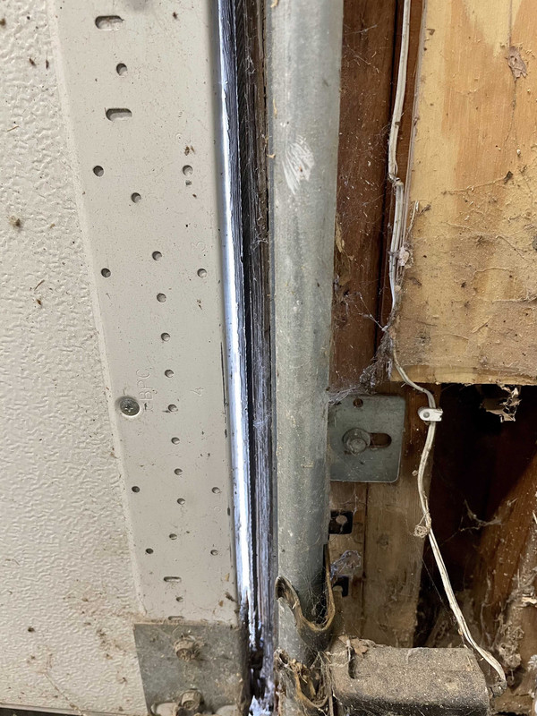

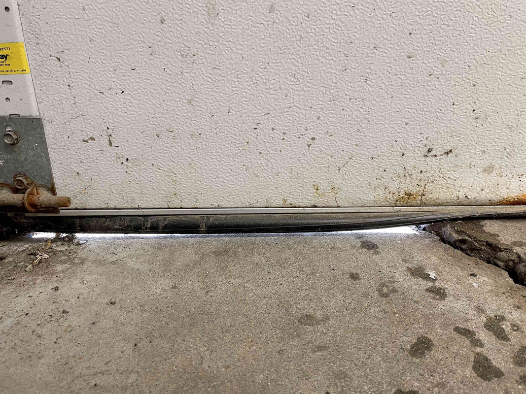

That is very intriguing! My "ceiling" is insulated, sort of. I put fiberglass rolls up against the roof. Not exactly proper. Long term I was going to drop it to ceiling level and put up some cladding, but I use that overhead storage space and I never got around to it.
Also, I have a lot of leaks.
Threshold seal can't negotiate cracked slab:
Sides of overhead door have gaps:
A rodent or critter chewed through some of the threshold seal:
Service door is lacking insulation and casing, cracked header (been putting that off for about 4 years!) :lol:
I really need to put some effort into sealing it up. :eyecrazy:
Does the kerosene heater require ventilation? I used to have a propane tornado heater and ditched it because I got worried about the carbon monoxide risk or having to leave the door open. If not, it looks like an awesome solution since a gas or electric heater is out of the question for me.

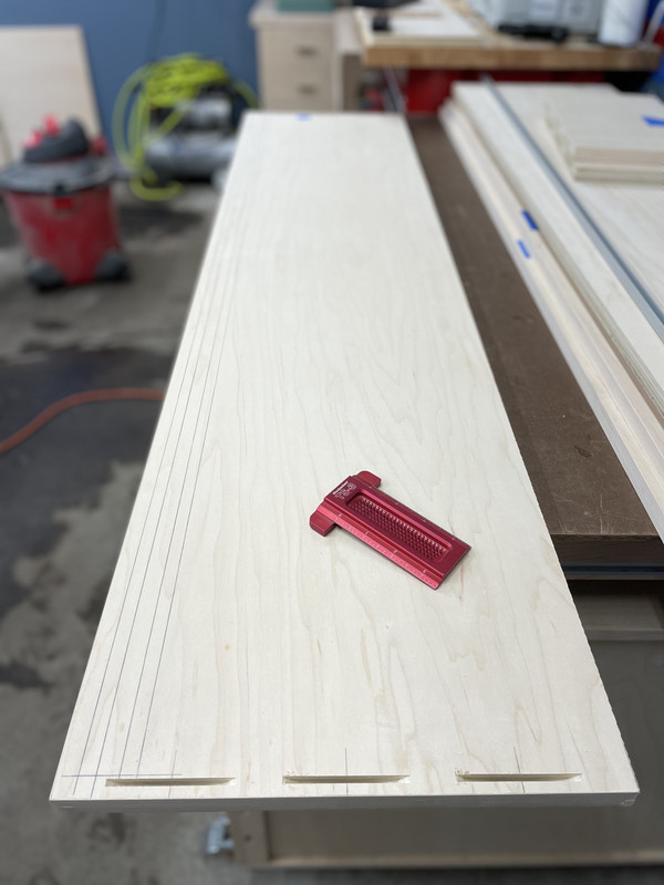

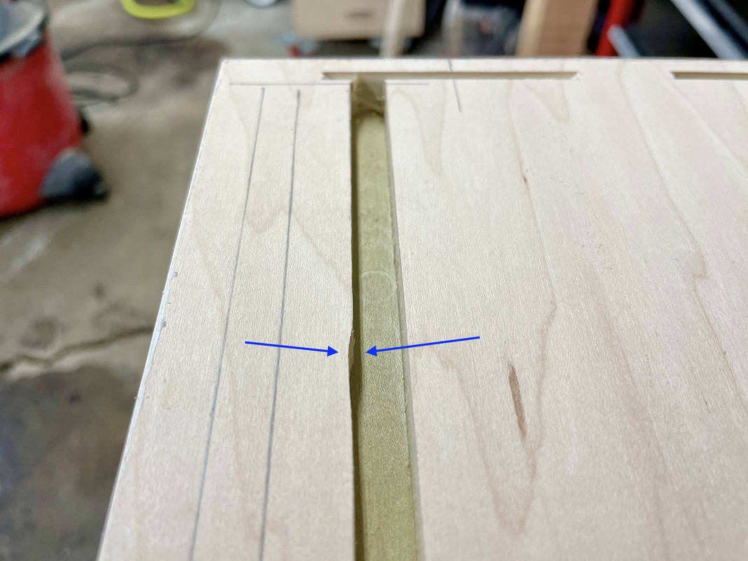

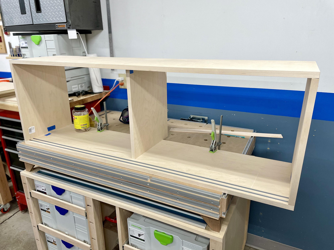

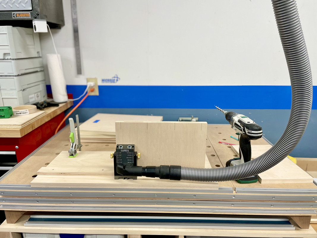

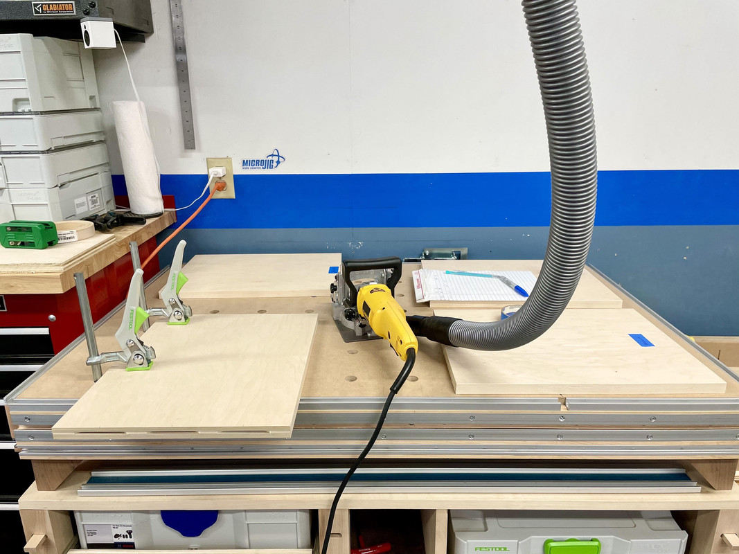

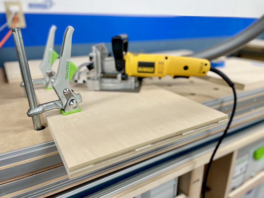

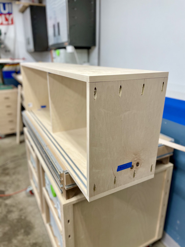

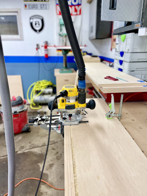

Living Room Built Ins - part 4 - joinery
Despite it being quite cold I sucked it up and went out there for a few hours this afternoon. I have plenty of cold weather gear, but it's the hands that start to hurt. And I will say the absolute worst is handling the Woodpecker's stuff! The aluminum is like holding an ice cube.

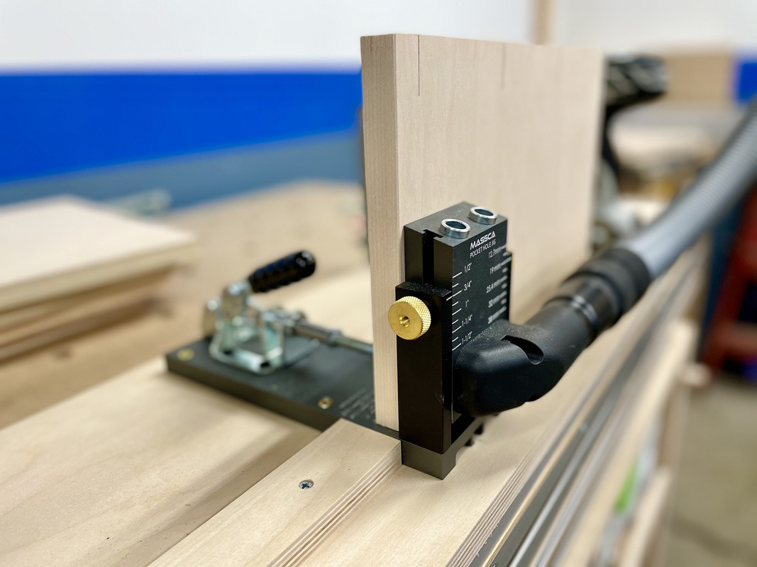

For this build I am using my preferred cabinet joinery -- the biscuit and pocket hole double whammy.

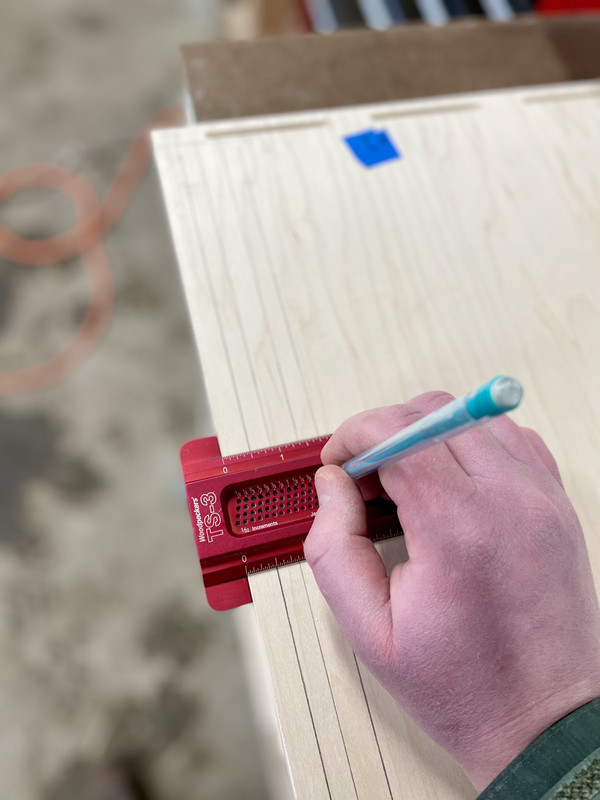

The hardest part is figuring out where the biscuits and pocket holes will go (usually alternating). Once I've determined the intervals, I write them down on a piece of paper so I don't forget, and then lay out pencil marks for everything. Once that's done, cutting the biscuits and pocket holes goes rather quickly.
It's good to do a test on the actual workpiece, right? :lol:
Everything aligned nicely.
Pocket holes were all done with the new Massca jig. It is fantastic. Took me all of 15min to drill 64 pocket holes. The Kreg K3 got me by for so long but the stationary jig is so much easier and faster I love it. I regret not getting one a long time ago, I should have listened to everyone who told me otherwise!

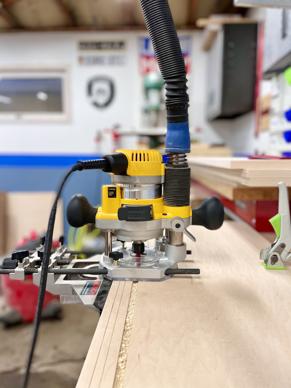

Dust collection on both of these tools is epic. Literally no dust in the air or on the ground.
I'm glad I pushed through and got out there today. I'm realizing once again how many steps there are in a project like this and it's good to keep forward momentum.

Nick, the built-ins are coming along great. I have never tried edge banding.... I've always felt it requires a certain finesse that I think I lack :lol: Maybe someday. You seem to have it down to a science. Definitely making mental note of some of the tricks you use. I hope you're not sneaking out there with your wife's iron!
Kind of a bummer about your tracks not lining up too. I seem to remember you scored your first one for a really great deal that almost seemed like a fluke. Were you as lucky on the second one? Apologies, I may be thinking of another one of your tool purchases as well.
Thanks! The edge banding definitely requires some finesse. Or rather the trimming portion. I still get minor chip outs from time to time.

Living Room Built Ins - part 5 - door slides
I got out there last night. About 14° F. Not the most pleasant. Had a less than stellar day at "work" (home). Wanted to make progress anyways and paid the price a little. Not my best work.

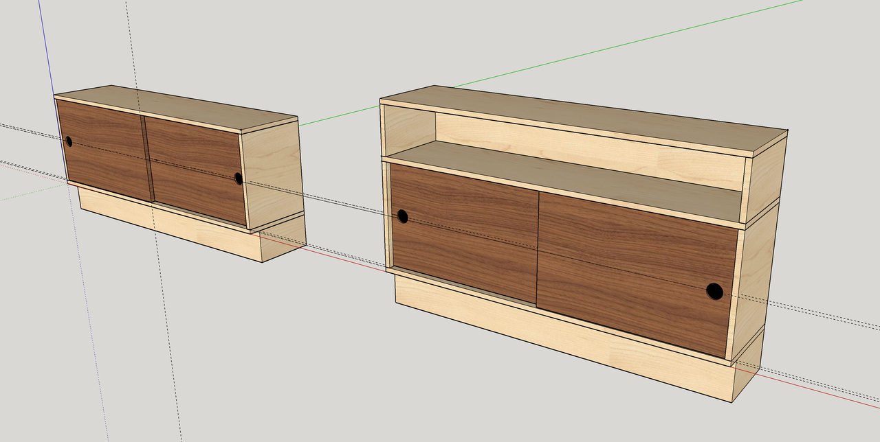

If you'll recall I'm doing sliding bypass doors:
With materials in hand now I was able to lay out the locations for the door slide channels based on real-world measurements. I still did this in Sketchup because it was easy and fast and I could see how it might affect anything else in the model.
Confident with a plan I did layout on the actual pieces:
I debated how to route the channels. At first I thought table saw with stock guides, but then I decided I didn't want the channels to go all the way through the sides. I didn't want wreck the edge banding, joinery, and thought there would be better structural integrity leaving a bit on the ends since these grooves are 1/2" deep. So I used the plunge router and edge guide:
And honestly this would have been fine except I made three mistakes.
Mistake #1) -- I routed the wrong direction (climb cut). I didn't notice this until the last few passes. Been awhile since I've used the router hand held and just wasn't thinking.
Mistake #2) -- Taking too deep of passes.
The combination of the above two things led to a few whoopsies:
That ones on a bottom piece, so you might see it, but it's not terrible. I think I'm going to let it be.
And then there's this one:
Which leads me to Mistake #3) -- I routed the above channel in the wrong piece!!!! That one was supposed to be the top of the taller cabinet, which has an extra cubby above the doors, so it shouldn't have been touched! Super mad at myself about this... I think they will be installed low enough where you won't really be looking up into it even from a seated position, but we'll see. I may have to re-make it and I don't know if I have a good section of ply left. :mad:
A few of these things (like taking lighter passes and routing in the correct direction) I corrected about half way through after my accidents. So, most of it came out ok.
For kicks I dry assembled the main case so far just to visualize it:
You can see pocket screws go on the outside which will be concealed by the walls/fireplace:
The aluminum U-Channel I am using is from Orange Aluminum.
Anyways it was one of those nights where my headspace wasn't right and I probably should have pressed pause, but I had already dragged all my tools out and was determined to get something done.
:willy_nil
:willy_nil
Cockups (the British have such a way with words) happen often enough even when you mind its clear. I'm amazed if I get through a project without one.
I actually glued in a raised panel backwards the other day. Didn't notice until it was already clamped and pinned together. Had cut the panel out before the glue set as I couldnt get the door apart at that point.

Those tracks look great as slides. I'm not sure I can thank you for the source as I now see a new place to send copious amounts of time and money to. (Are these what you used?
Thanks for sharing the router story. It's been a while since I've used mine out of the table; because of your story I'll watch a refresher video before I do.
:beer:

Kudos for stopping while you’re only (a bit) behind. It has taken me years to get to the point where I stop before I’m bashing my work apart and throwing tools at the wall.
Re: fixing slips:
1. If you can’t see it when installed, you can’t see it.
2. You can layer adhesive backed veneer in place to fill a gap. This is basically marquetry.

Nick I can see your bummed but I will be honest I had the same problem this past month when I was using my router. I did a climb cut and it had been so long I just thought the bit was dull. Faceslap.
I do have a rule though that if I am not in absolute peak mindest I don't usually use the power tools. Kinda of like if there is any alcohol in my system (which is very rare) I don't use power tools either. Don't want to be a Bubba. :D
Remember the difference between average and a craftsman is learning to hide your mistakes. Sometimes it can cause you to be very creative.
Even if you know those mistakes are there and no one else does. Eventually you will forget about them.
:beer:
We shall see how the tracks work :D

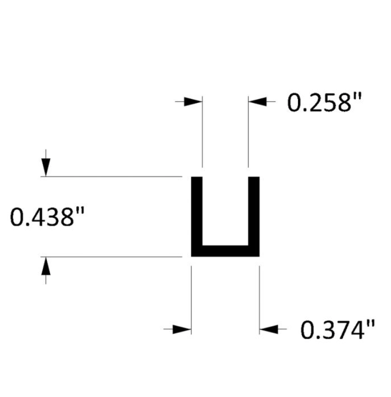

I got the idea from kwyjibo on his MCM credenza build. He used Hafele hardware with them, but I am going to attempt to use some strips of UHMW plastic as the "tabs" to ride in the channels. Mostly just to save a few bucks. This is something I noticed on some sliding doors at Room & Board a few years back. Hopefully I can pull it off.
You are correct on the Orange Aluminum link. The specific extrusion I used was OA7401-6CA with the following dimensions:
The "1/4" UHMW I got was too snug a fit so I have some figuring out to do there.
